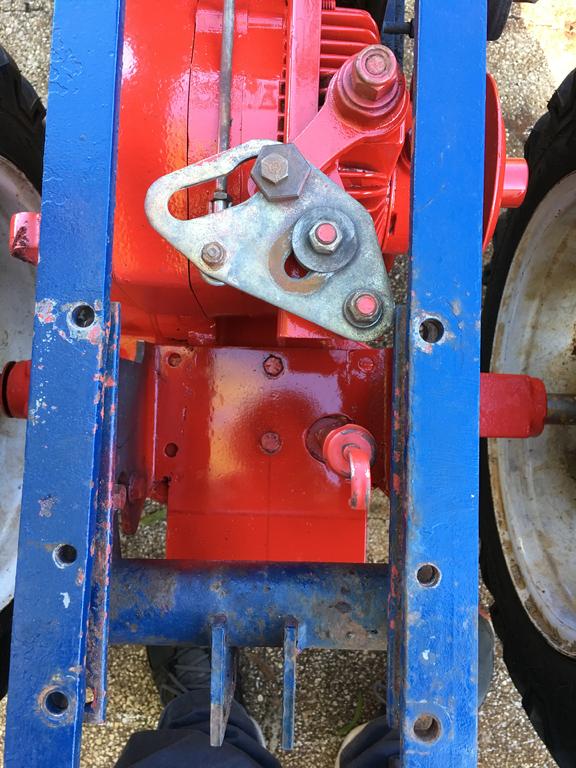

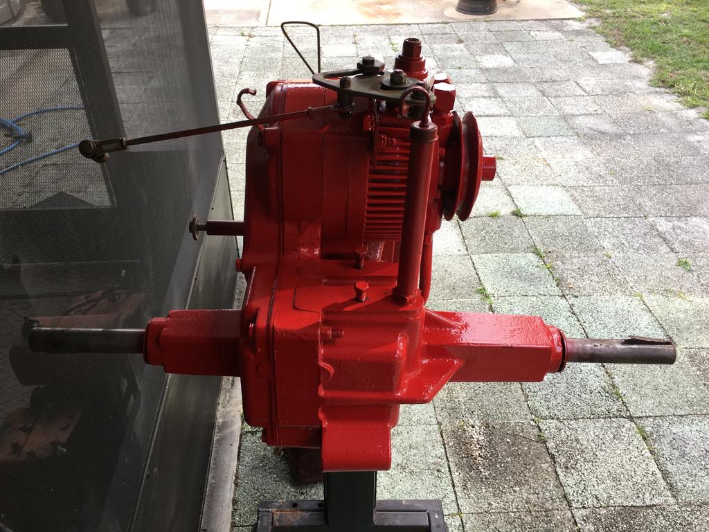

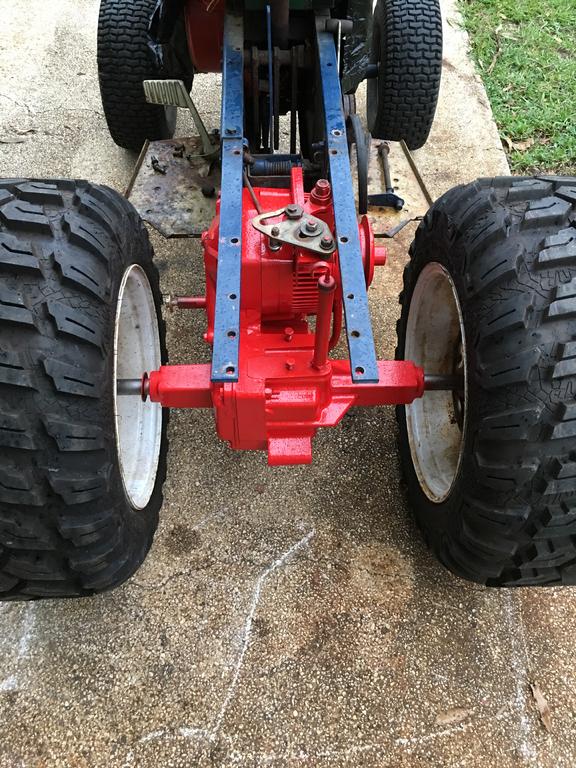

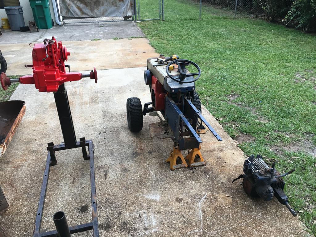

19richie66 16,879 #103 Posted October 22, 2017 Getting close! Measured my axles from hub to hub and it is really close to stock gt14 width maybe even a hair wider. So hopefully if I can get my son over here this week, there may be an Eaton 1100 transplanted into Skittles soon. 1 6 Share this post Link to post Share on other sites

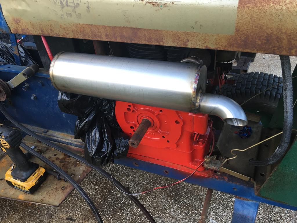

Texas Todd 1,024 #106 Posted October 23, 2017 On 10/19/2017 at 6:08 PM, 19richie66 said: Almost hate to cover it Did you putting any baffle material into the can? I haven't ever cut one of those open to see what's in their. But I have 2 old ones and should. I was wondering what baffle material like wrapping a motorcycle baffle would do to the sound? Share this post Link to post Share on other sites
ebinmaine 62,959 #107 Posted October 23, 2017 18 minutes ago, Texas Todd said: Did you putting any baffle material into the can? I haven't ever cut one of those open to see what's in their. But I have 2 old ones and should. I was wondering what baffle material like wrapping a motorcycle baffle would do to the sound? I was wondering as well..... Share this post Link to post Share on other sites
19richie66 16,879 #108 Posted October 23, 2017 For now it is just ported with the holes and half moon cut outs at the end of the inlet pipe. The outlet pipe has no holes but is about 2" from the end of the back plate. Its an experiment to say the least. I am hoping it is as quiet as my 418/417's. I thought about packing it with stainless steel wool but then if it doesn't flow enough, it would be too restricted. We'll see soon. I'll try and post a short video when it's done. I dont think there is any packing in the factory mufflers. All I have seen have had many smaller holes for baffles instead of packing. 1 Share this post Link to post Share on other sites
ebinmaine 62,959 #109 Posted October 23, 2017 1 minute ago, 19richie66 said: For now it is just ported with the holes and half moon cut outs at the end of the inlet pipe. The outlet pipe has no holes but is about 2" from the end of the back plate. Its an experiment to say the least. I am hoping it is as quiet as my 418/417's. I thought about packing it with stainless steel wool but then if it doesn't flow enough, it would be too restricted. We'll see soon. I'll try and post a short video when it's done. Keeping in mind I am not a welder. Is there a way to tack it together fairly Loosely in case you don't like the noise? Share this post Link to post Share on other sites
19richie66 16,879 #110 Posted October 23, 2017 Yes. You are diving into my mind. Scary. I am going to have him tack the front cover and brace. Making sure it fits and seeing how it sounds and then he can weld it up. If it is too loud, I'll pack it. Vinsrj made that flowmaster style muffler with no packing and it sounds good. We'll see. 1 Share this post Link to post Share on other sites

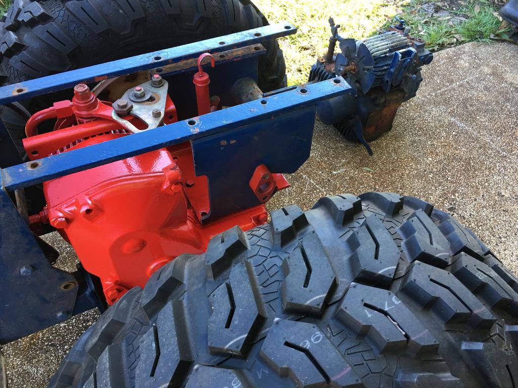

19richie66 16,879 #111 Posted October 23, 2017 Waiting on some muscle! Also I checked my width and it is identical to the sunstrand transaxle I took out. This is good. 4 Share this post Link to post Share on other sites
ztnoo 2,298 #112 Posted October 23, 2017 Looks like you're going to go ahead and use the five lug hubs that came with it, instead of the four lug GT 14 hubs??? The GT 14 hubs have a lot more axle surface, I believe. As I recall, the axle surface length, they are about 4 3/8". What is the axle surface length of the five lug hubs? 1 Share this post Link to post Share on other sites
19richie66 16,879 #113 Posted October 23, 2017 (edited) 4" for the gt compared to 2-1/2" for the 5 lug. Not as much as the gt or D series but it should be more than strong enough. I already have custom 5 lug wheels. I figure if these 5 lug hubs were good enough for say the 520's it should be more than enough for me. I am in no way going to work this as hard as it could be worked. Although I havent welded the centers into my rims yet and I do still have the original wheels with 4 lug centers....... and the rims are shot but the centers could be removed and put in my 15"x10" shells. Well another project 😁 Edited October 23, 2017 by 19richie66 2 Share this post Link to post Share on other sites

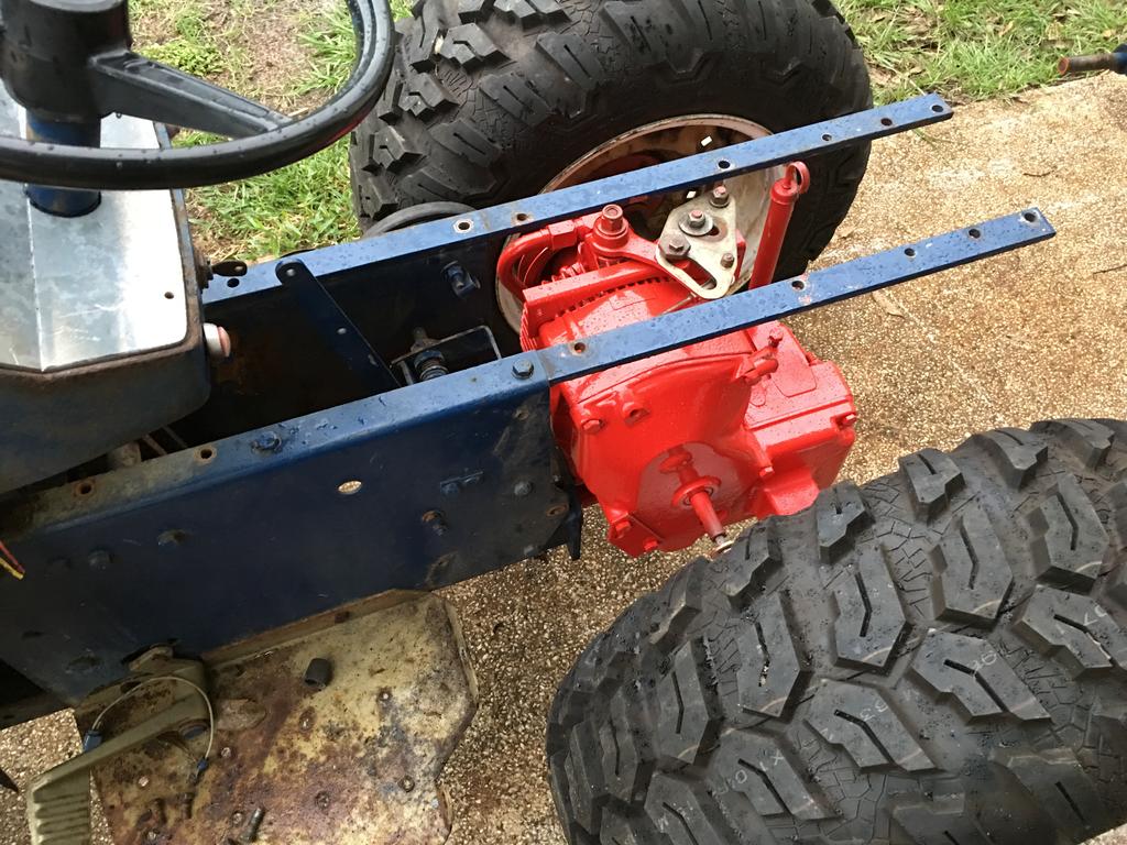

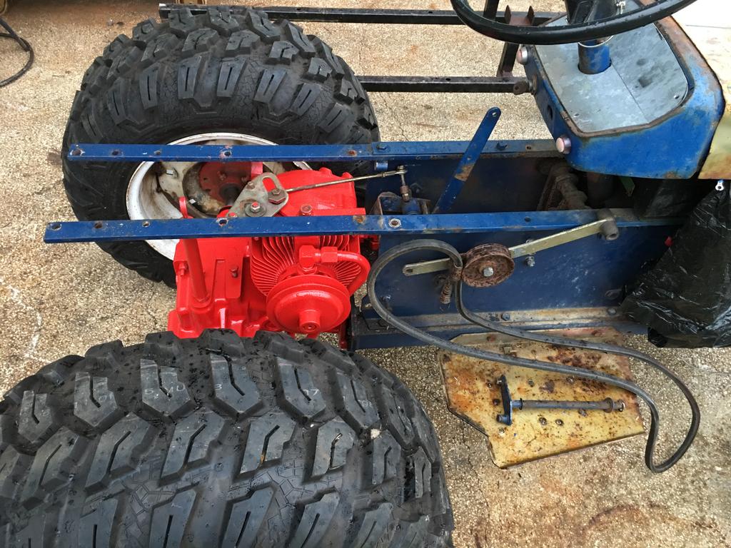

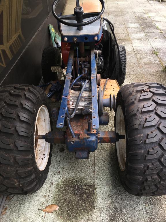

19richie66 16,879 #114 Posted October 23, 2017 (edited) And thats a wrap! Plenty of room. Now the fun starts. Edited October 23, 2017 by 19richie66 2 5 1 Share this post Link to post Share on other sites
ztnoo 2,298 #115 Posted October 23, 2017 OK, thanks for the explanation. All I was attempting to do was point out the additional (by a large percentage) available axle surface of the GT 14 hubs. I just went out and measured an extra set I have, and they measure a full 4 3/8" in shaft length. Your hubs 2.5" axle surface length divided by 4.375" axle surface length equates to a a 57% difference in surface length. A significant differential. 2.50 / 4.375 = .5714 Just something to ponder and catalog for the future reference if hub slippage becomes a problem. You've got a great looking restoration/modification going on there.........in FL, where you can work on it almost any time other than during a summer downpour or a hurricane. I'll continue to follow with great interest. I can't imagine what you and Dr. Trimble would come up with for a GT 14 modification project if you were next door neighbors...... 1 1 Share this post Link to post Share on other sites
19richie66 16,879 #116 Posted October 23, 2017 If Aldon lived next door to me, I'd be divorced. But oh, the cool stuff we could come up with. 2 3 Share this post Link to post Share on other sites

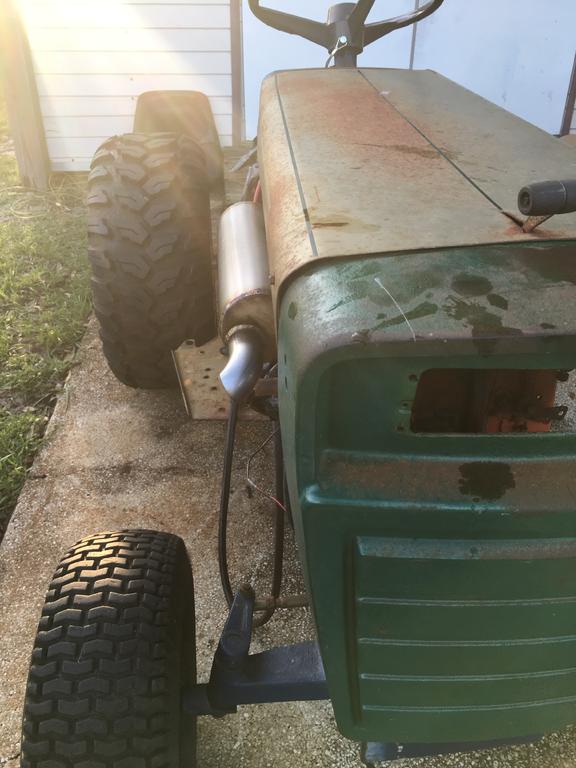

19richie66 16,879 #119 Posted October 24, 2017 Muffler done, fits like a glove. Hope it sounds good. 2 4 Share this post Link to post Share on other sites

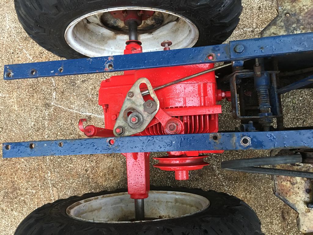

19richie66 16,879 #123 Posted October 29, 2017 Got the top tranny plate made and welded into the rear main support. Still have to trim off the excess at the rear of the plate. Should be nice and strong now. 5 1 Share this post Link to post Share on other sites

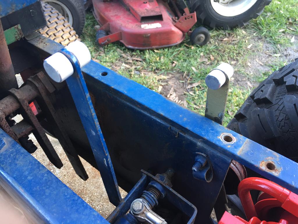

19richie66 16,879 #124 Posted November 1, 2017 (edited) Bling Bling. Added some knurled knobs to the levers. It's the little things...... Edited November 1, 2017 by 19richie66 Forgot picture........ and I know everyone loves pictures 😂 2 4 Share this post Link to post Share on other sites
Texas Todd 1,024 #125 Posted November 1, 2017 Those really set it off! Well done! 1 1 3 Share this post Link to post Share on other sites
