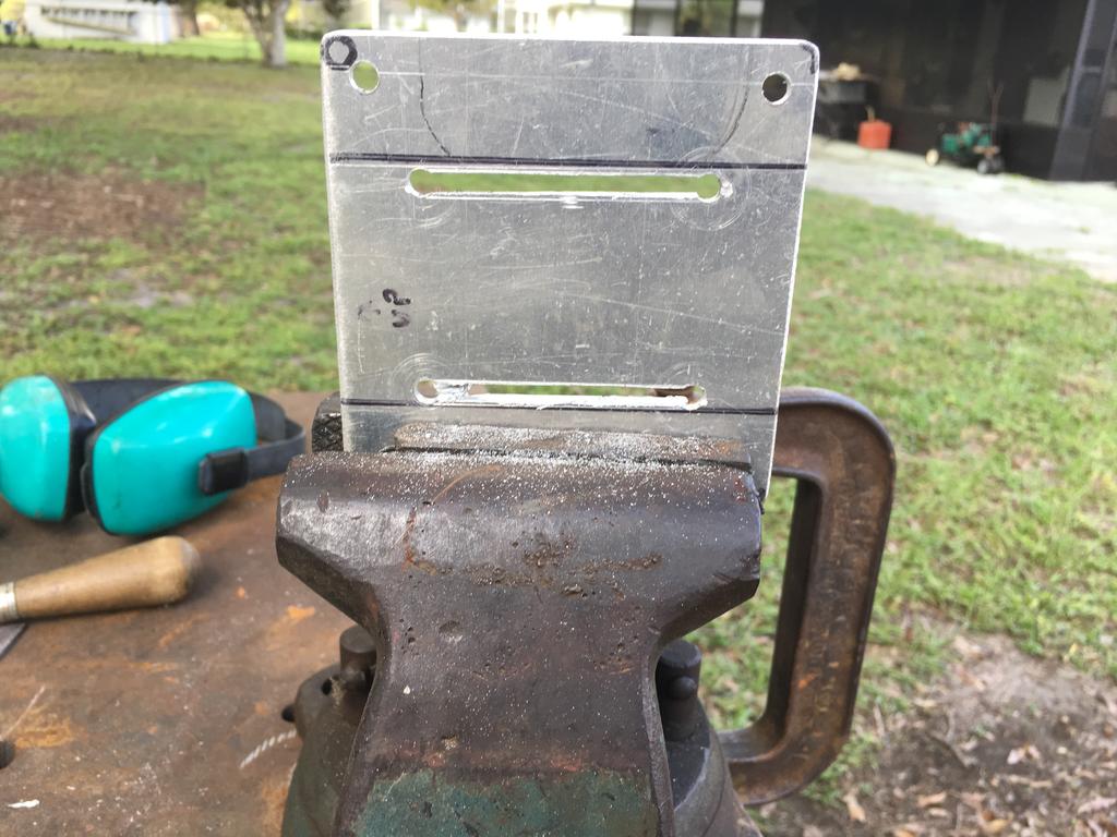

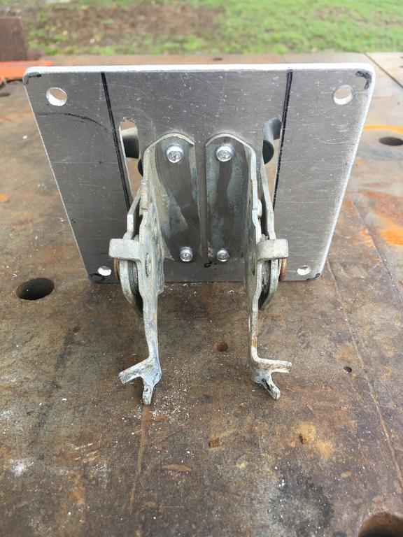

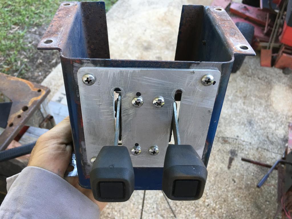

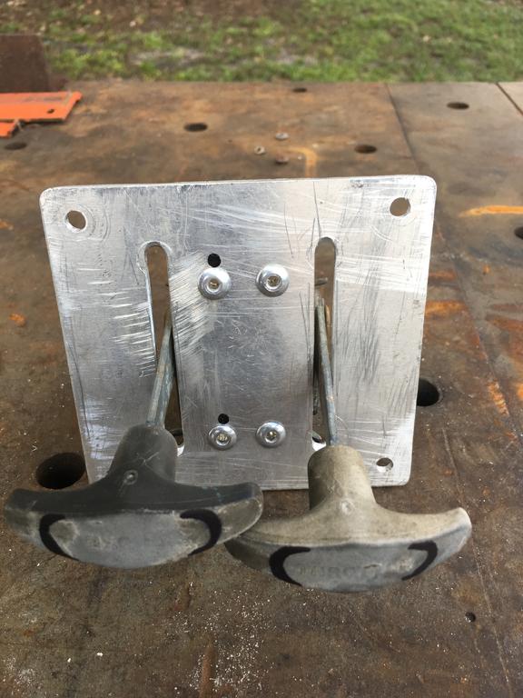

Made a plate today to relocate the throttle and choke down where the amp guage used to be. Ran out of machine screws so just riveted them in till I get some more. Have to make the amp guage hole bigger and square, then mount it up. Im replacing the original throttle and choke cables with these from a c-175 and will fill the cable housing holes with push button switches. Knobs will get reworked too. Just trying out some different things.

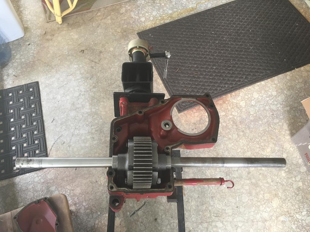

DISCLAIMER: YOU CANNOT SWAP THE AXLES OUT OF A GT14 TRANSAXLE INTO AN EATON 1100 TRANSAXLE.  :naughty: BUT...... you can if you use a D160 axle and an Eaton 1100 axle. :thumbs:

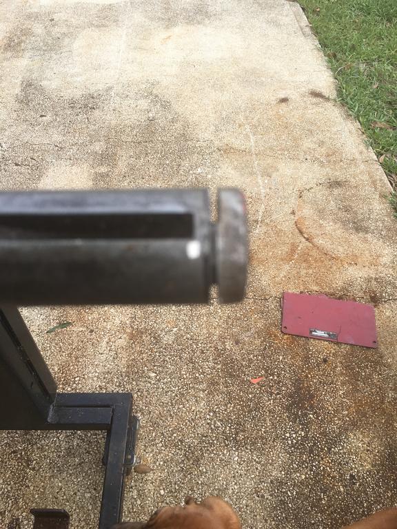

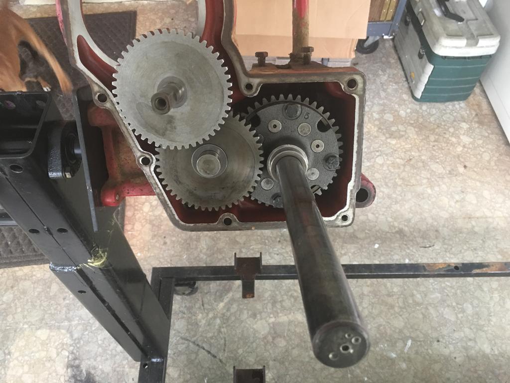

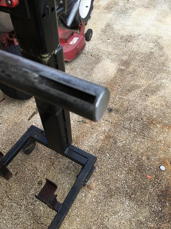

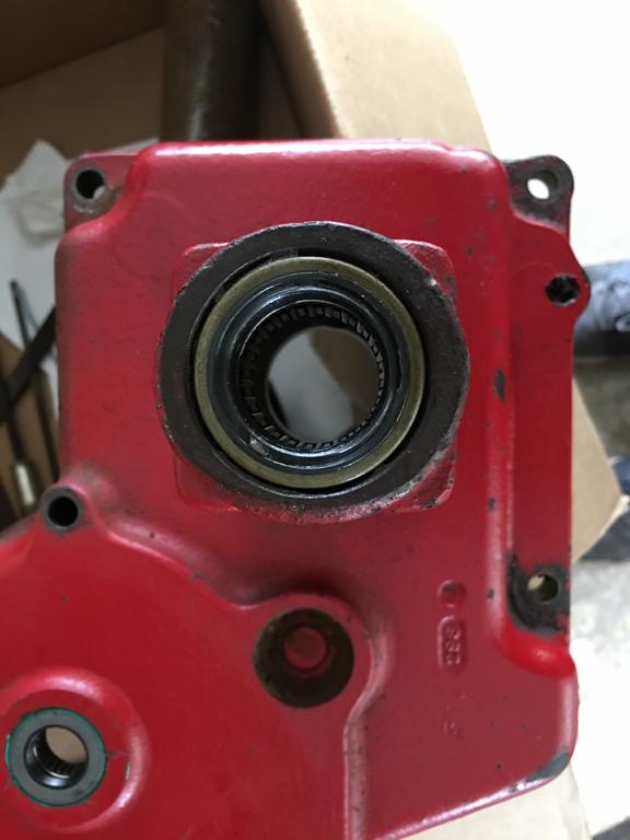

So I finally got all my transmission gaskets and seals in so I thought I would tackle that today. Split it back apart and tacked up my gaskets and replaced the brake shaft seal. Put a little grease on the seals and slid it together. Got to looking at it and seemed like one axle was sticking out farther than the other. So back to measuring and found a 5 inch difference. :think: Now this is with the gt14 axles in the eaton 8 pinion differential. A 520 has the same end caps on the diff whereas the gt14's are different and offset to one side. So back out and flipped it around to test it the other way.Better but still stuck out farther on one side. Measured the 520 axles and there was a 3" difference in length. Measuring the gt14's axles and there was only one inch difference in length. So I started lining up axles on the bench to try and get the 3" like the original 520 axles since that was the case they were going in. Remembered I had a D160 axle laying on the floor. Grabbed it and measured some combinations and got what I needed. The D160 axle was 3-3/8" longer than the long axle out of the eaton. Other than the keyway being different, it's the same diameter and would work. Put them in and it was just a hair too long. Consulted Aldon, the Swami of GT14 's and he said it should be good to go. I am already too far in it to quit.  So I cut 3/8" off of the D axle and got my needed width the same on both sides. I knew i saved that axle for a reason. Dont have a lot of photos because my hands were covered in gasket tack and oil. But I got some. What a day. :laughing-rolling:
New seals #6449 and #7443
520 axle this side...............................D160 this side 👍
Cut 3/8" off the D axle ✔️
Polished smooth and chamfered ✔️

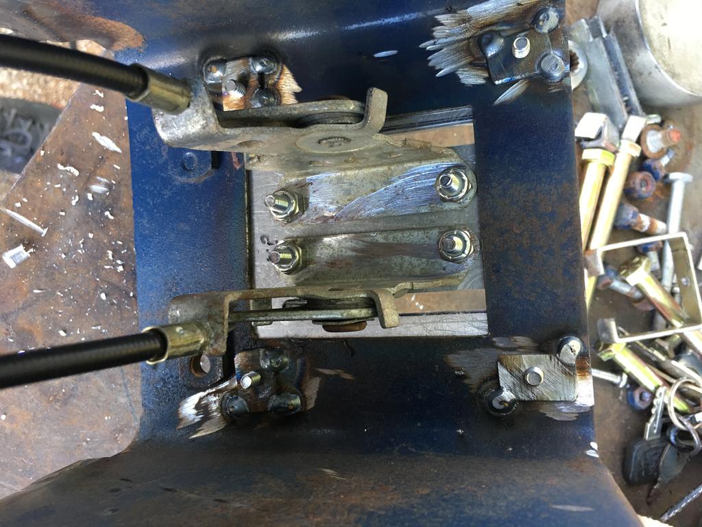

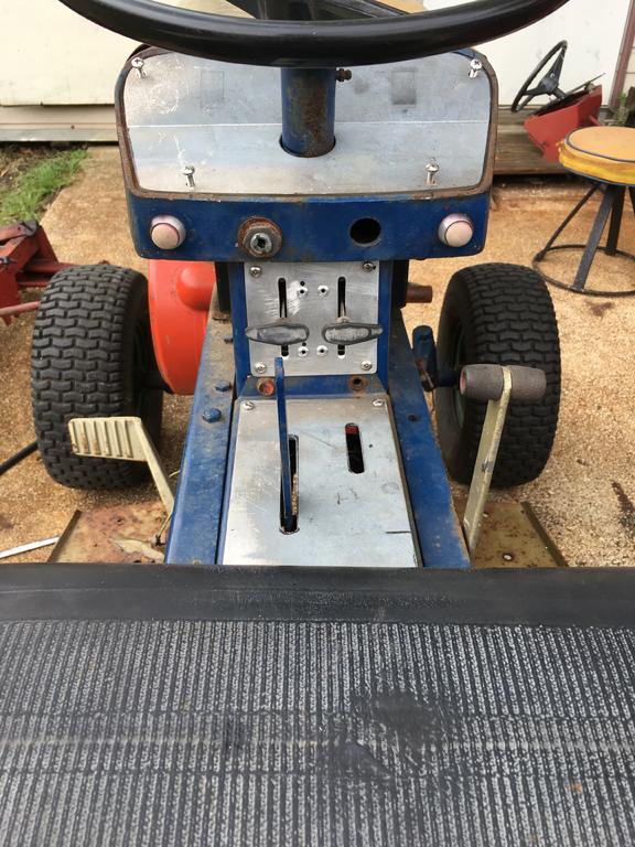

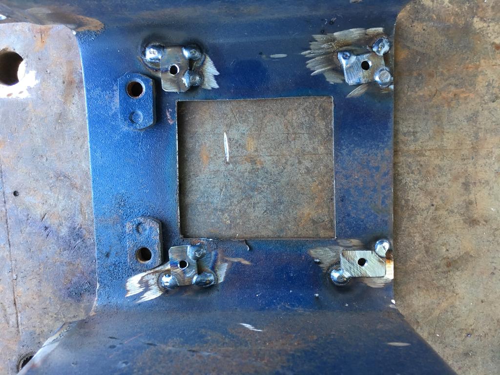

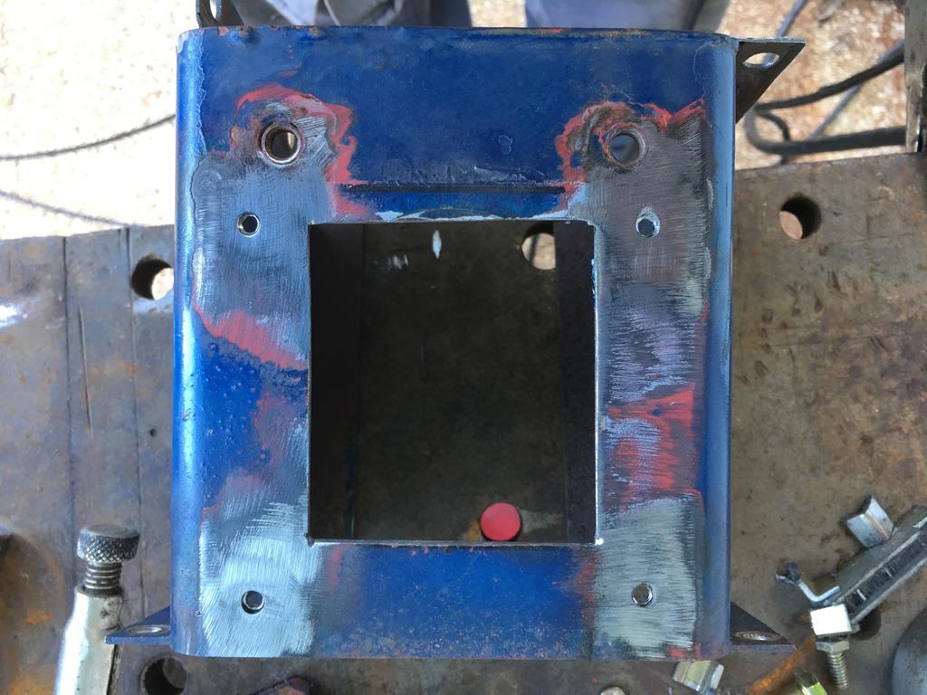

Steering tower cut and plate mounted. Knobs trimmed and switches test fitted where cables used to be. Need to move the ignition switch to the right and the lighter will go where the switch is now.:handgestures-thumbupright:

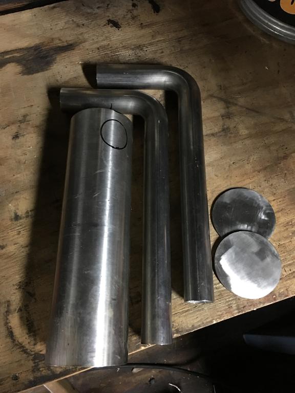

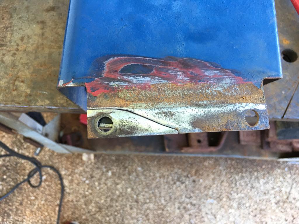

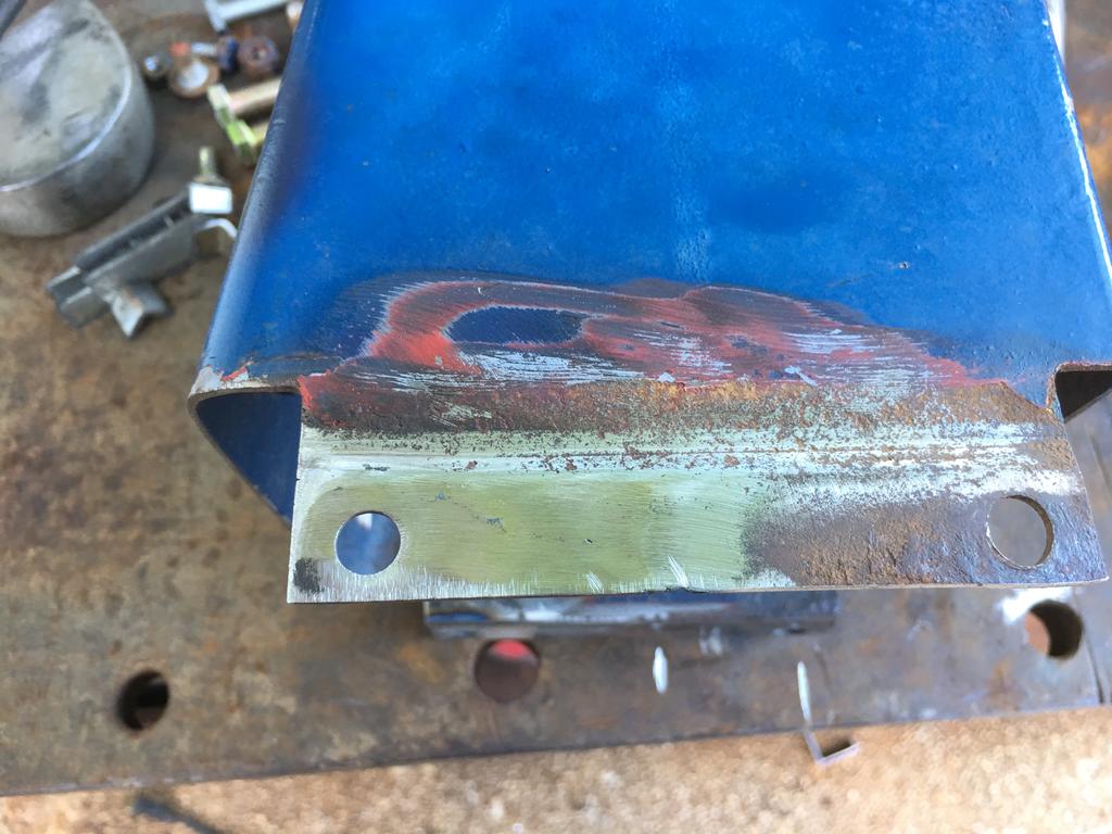

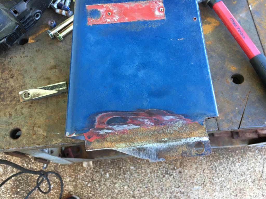

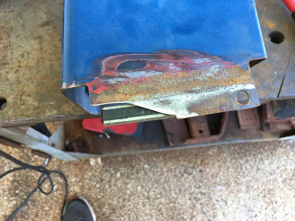

Took off the center "tower" piece today and found the bottom had broken off but still held on by the bolt. Cleaned up both pieces, put a magnet behind it and stuck the other piece to it. Welded them up along with two more cracks and then cleaned it all up. Also welded some small threaded flat "nuts" I made to hold the lever panel to it so I can remove it without taking the tower out.  Post office brought  me some goodies today..... two 90* mandrel bends in 304 stainless. Now I can build my muffler. 👍

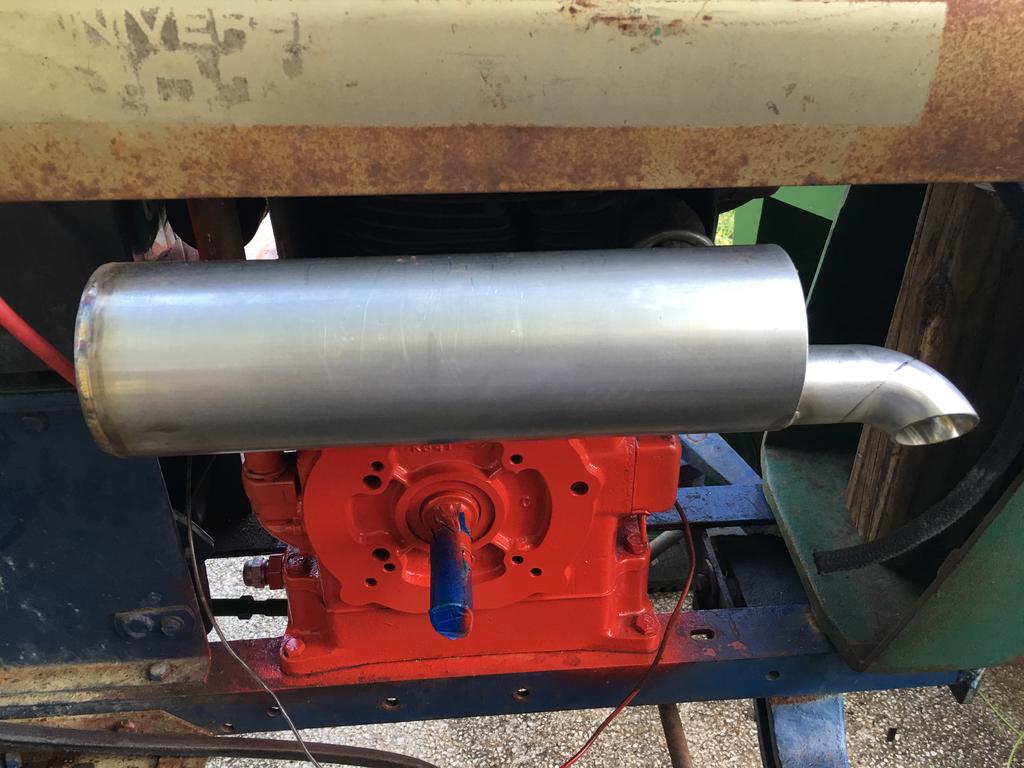

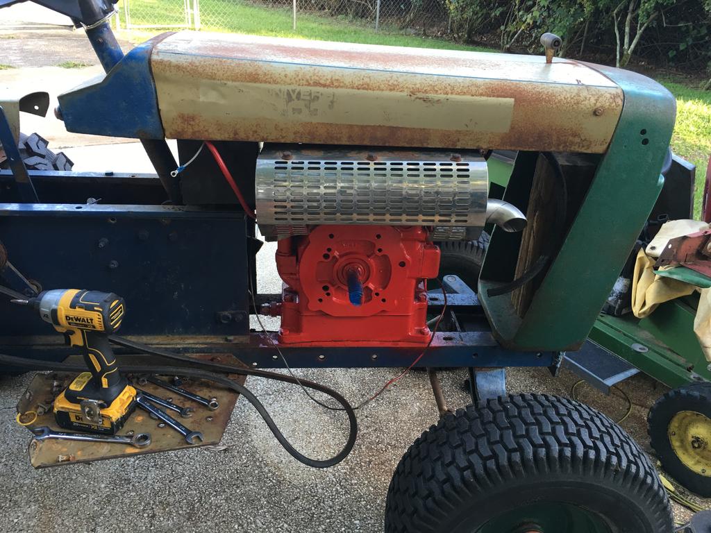

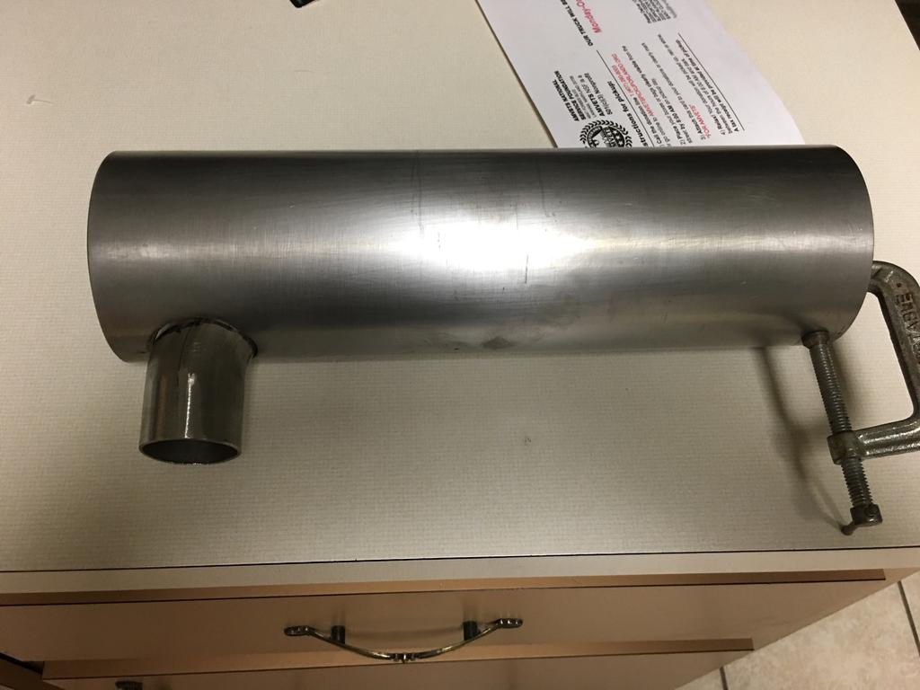

Basically building a 418 muffler size wise but with just the one inlet. Also going to use a chrome heat shield setup off of a 418 Kohler magnum mounted to the rail that runs under the hood above the exhaust. Like in the pic.

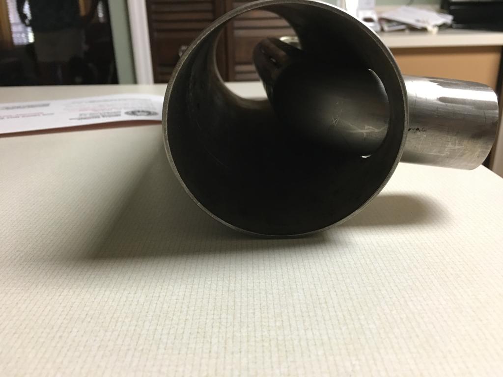

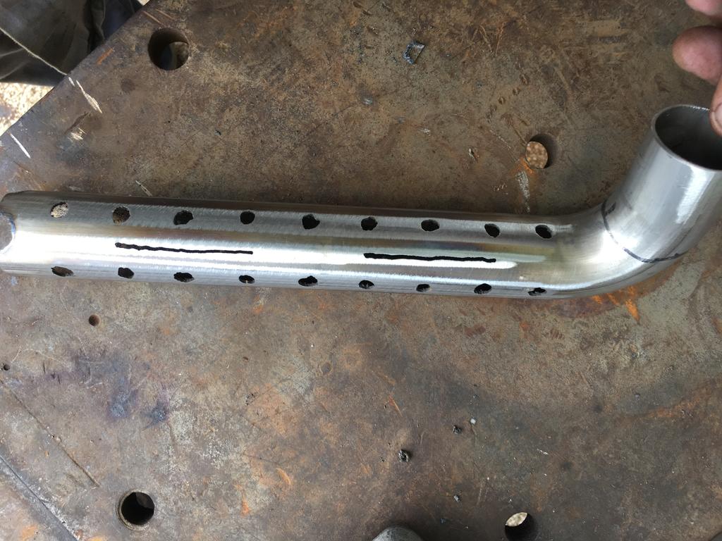

Tried to drill the inlet pipe for ports but I had no good drill bits for the job. Out come Mr.Plasma and took care of the job. Pretty? Not really but no one will see the inside anyways. Will it work? I don't know. Took some ideas from different things I have seen on the web. Cut the opening on the side for the pipe to stick out. Cut it to length and used a stainless nut for spacing inside. I'll get this much welded and then finish the front end cap and outlet. Ill put a flat bar support bracket on the back, midway.

Plasma is handy stuff!
  • Like 3
Looks like a nice cut to me.
  • Like 1
  • Thanks 1
I'm with Hank Ritchie...As they say good enough for the women we hang out out! :lol:

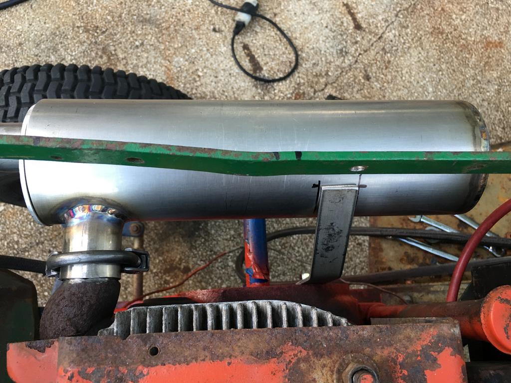

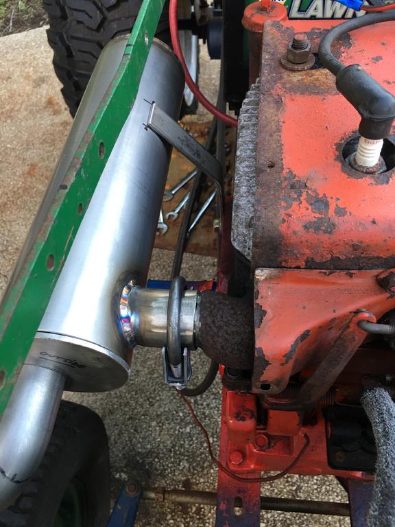

Little more on the muffler today. Made the cutout for the front outlet pipe and a rear brace to the engine. Also fitted the 418 exhaust guard. Still have to make a mounting bracket for it. Going to weld that to the brace that runs the right side under the hood and try to incorporate the coil and solenoid mount so they are up and out of the way.
  • Like 3
  • Excellent 4
Looks awesome.
  • Like 1
  • Thanks 1
19richie66
Holy crapola!!!!
Exquisite!!!
You could sell those......SERIOUSLY.
I'd buy one.......
Great work. Impressive skills on display!

Thank you Steve. My son gets all the credit for sticking the metal together. I just did the fit up. I wish I had the time and materials to make more but it's all I can do to get one done. I am planning on making a new fuel tank for it made of 1/8" aluminum sheet. Going to have my son weld that up for me too. He got into the right profession. :thumbs:
