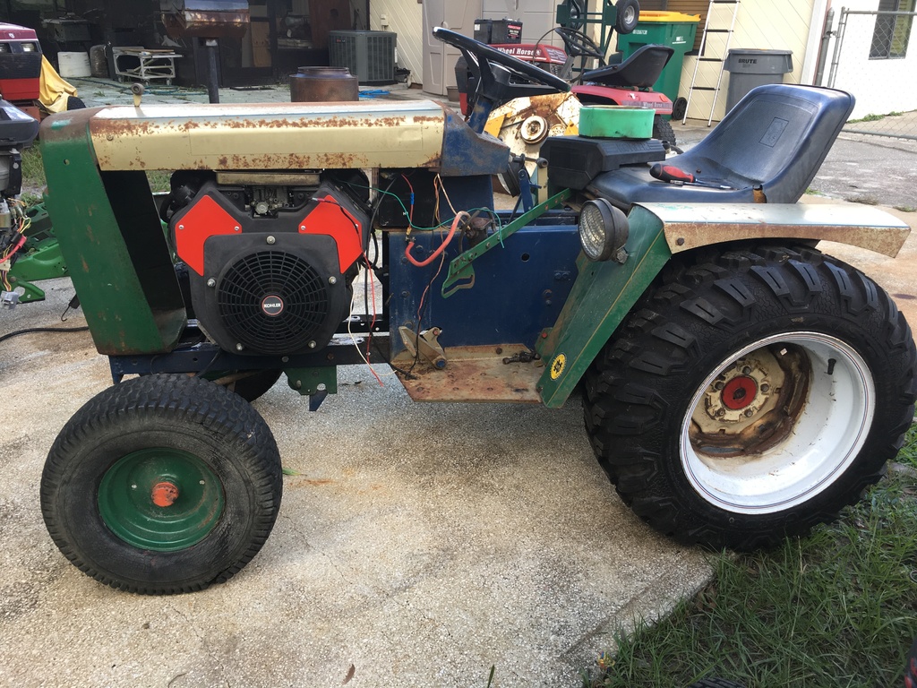

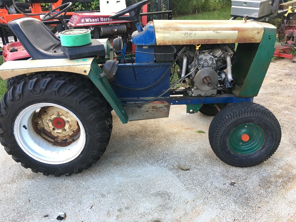

Set the "new" motor in place, figured out my plate for the mounting. Crank is same height as original motor so I do not have to go up any. Air cleaner is the only thing that hits the hood. Plenty of room under it. I really do not want to cut the hood so I will be looking for an adapter. Also the fuel tank is not a problem as my son is going to weld me one up. Battery is fine although I do need to trim about 1/2" off the front edge.

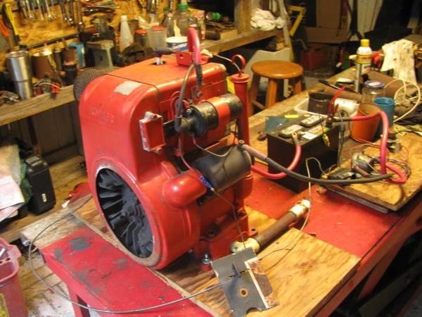

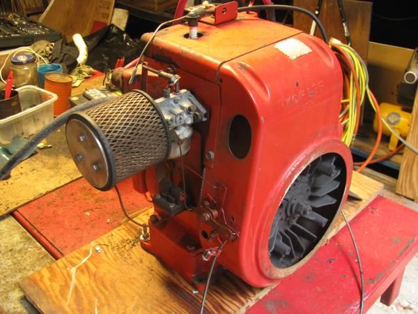

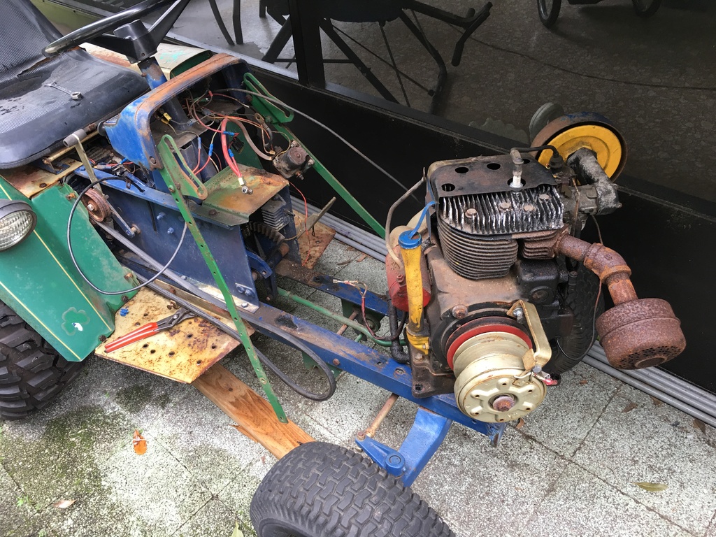

The more I thought about it the more it bothered me. I bought this tractor because I love the look of the GT14 with the air cleaner out the side, fenders and overall design. I couldn't bring myself to cut it up to put that engine in it. Maybe if I had another to keep it company but down here these just don't exsist. So I decided to sell the v-twin and located a K341 that I bought to put in it. This motor powered a backup fire pump at an aircraft factory. It was fired up only for maintenance and was never actually used. The seller said it probably has less than 50 hours on it. Its clean and purrs like a tiger. Should make a nice replacement for the worn out 14. Also got my power steering lines welded up.
And it has the battery ignition system rather than the "Trigger system"           :handgestures-thumbupright:

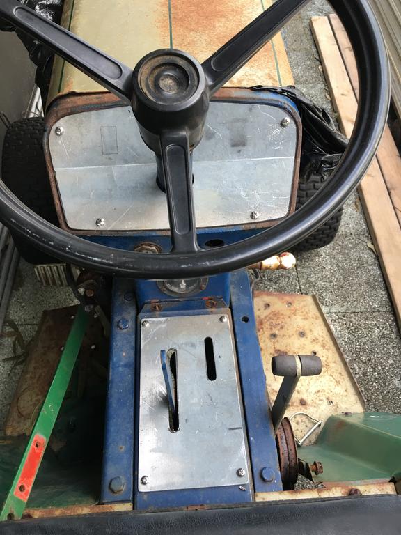

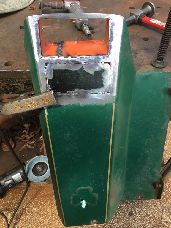

Little steps......Fabbed up a new transmission tunnel cover and dash plate. Can't let Aldon have all the fabrication fun.

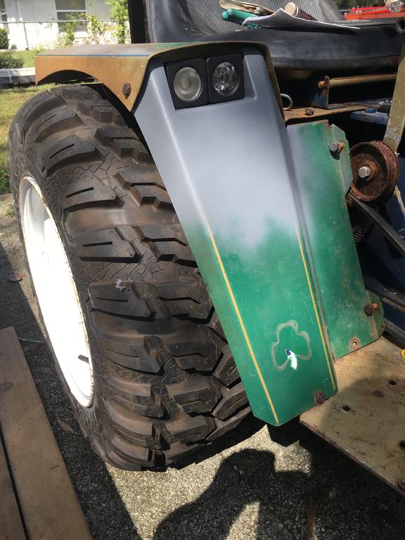

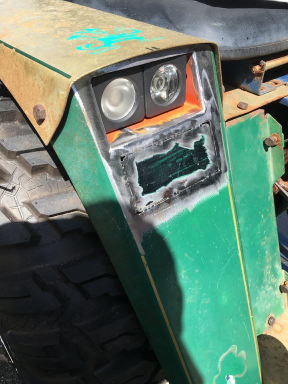

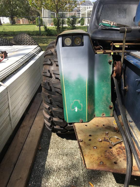

I love the little shade effect the upper fender gives it. The light lenses look different from each other, fill us in.
  • Like 4
They have removable lenses that let it be a spot or a flood. May make one of each on each side and have separate switches for each pair. That requires planning and I haven't got that far yet. :thumbs:
  • Like 5
  • Excellent 1
Great idea and excellent place to put lights for night work - those should shine right where you need it most at the magic 45* angle in front of the tractor - yet still keep the lights back far enough to see a mowing deck or blower . Only other good place would be over head on a roll bar - that's my next build project on the D when it's back in service . Seems between work and short days in the winter I'm always trying to move snow or sometimes finish mowing in the dark - being stuck with bad eyesight requires a lot of light and I love how you integrated it into the tractor . Looks like they were there when new - great job .

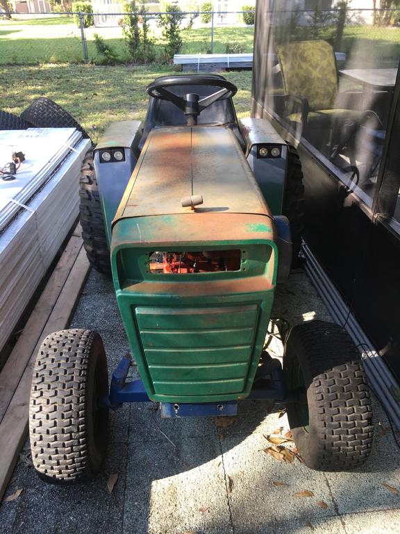

Thank you Sarge! Much appreciated. Thats kinda where I am going with this tractor. Love the looks of the GT14 so I decided nice tastefully done modifications that hopefully look like they were made that way without taking away too much from the original design.Its not going to be a factory restoration by any means but I want someone to question "was that factory?" Only the purests would really know. :thumbs:
