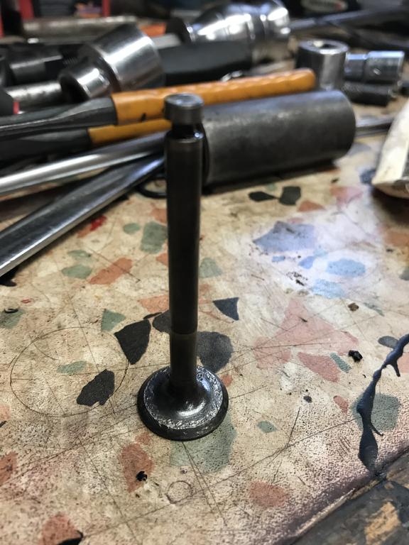

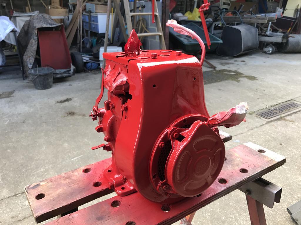

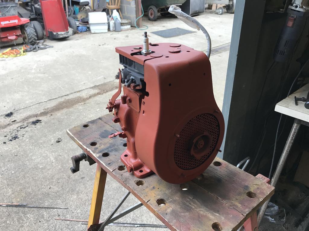

The focus was on the engine now which I managed to source from someone on another forum, I had already stripped the engine down of any unnecessary parts and we had tried to start it. then it dawned on us that the engine didn't actually have any compression. We didn't really want to have to remove the head as the only replacement parts are NOS ones and expensive to ship over here. Anyway we removed the head and Found the exhaust valve stuck open. As you can see the valve and the valve seat is incredibly rusty and pitted, I left the block and valve with my uncle who managed to grind it down to a useable state and the engine runs quite nice now. As for the head gasket I managed to find someone in Greece who was able to make a replacement from a scan of my old one for the cost of £4 :woohoo:
We also managed to remove the old exhaust which had rusted in
  • Like 1

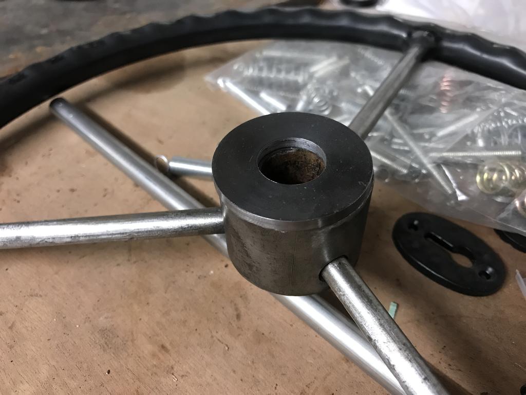

I purchased the steering wheel from America which came off a cub cadet, the difference between a CC one and a WH one is that the CC one is splined, I wasn't able to get a drill in to drill a hole for a roll pin so the alternative was to fashion a clamp. It works very well so i'm happy.
The end of the steering column was mangled so a new piece was welded on, this also helped to make sure the steering wheel fit on snugly.

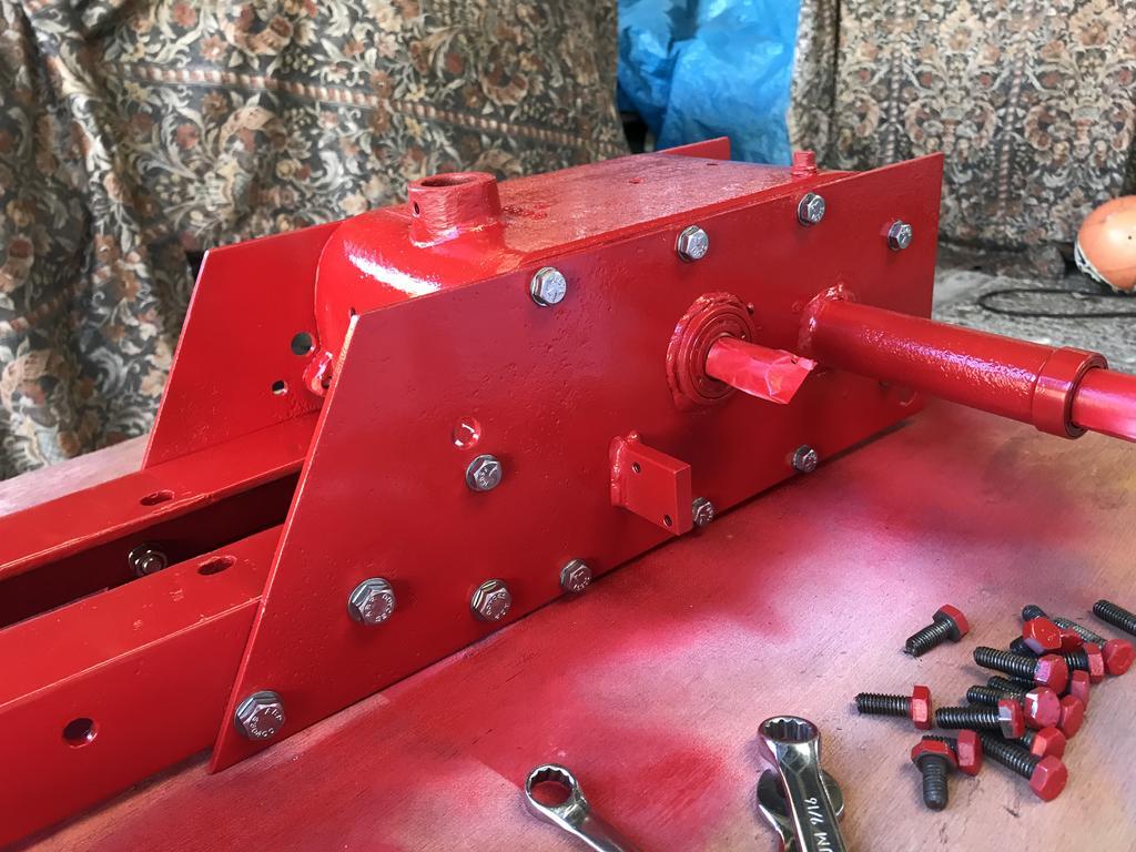

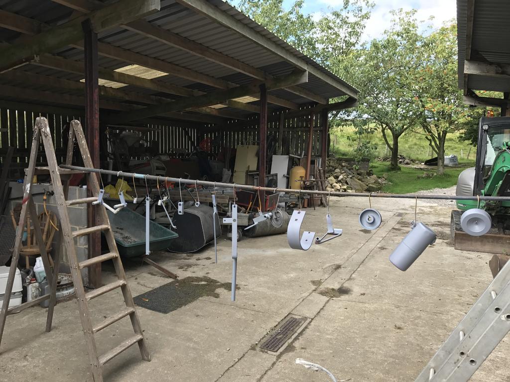

All painted up

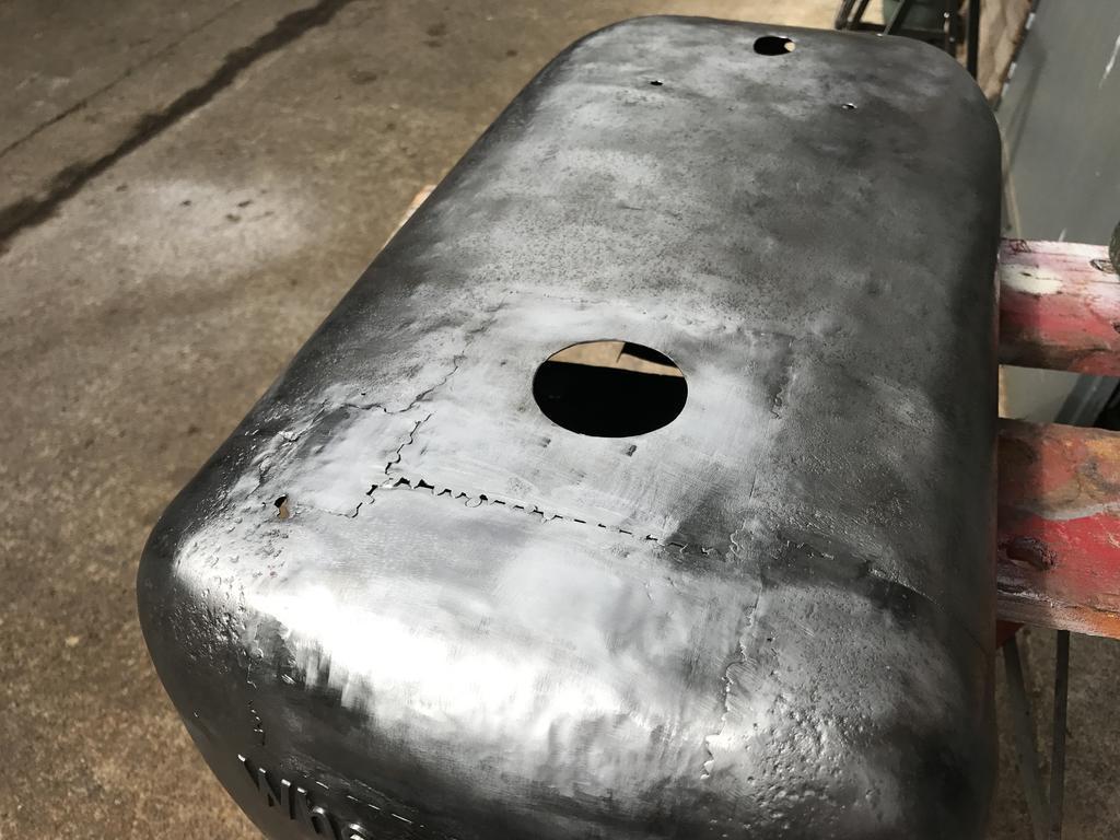

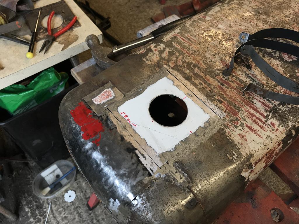

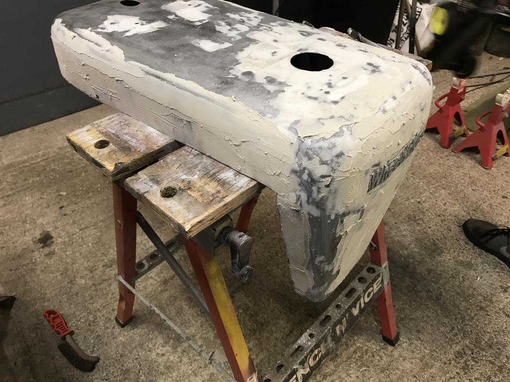

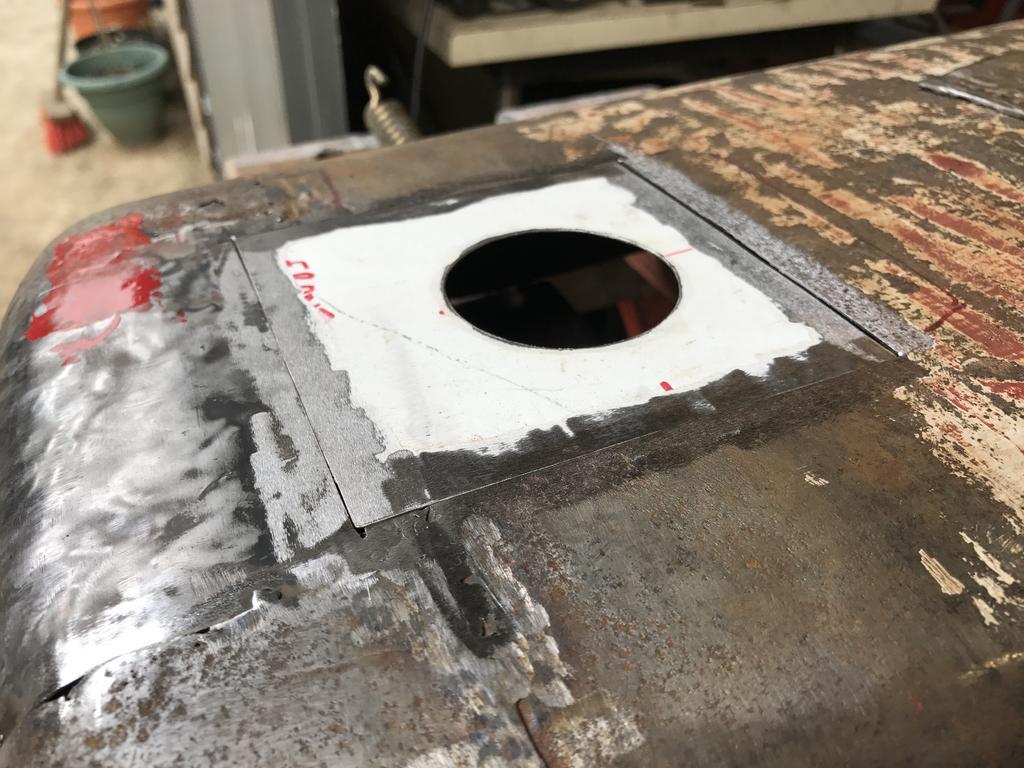

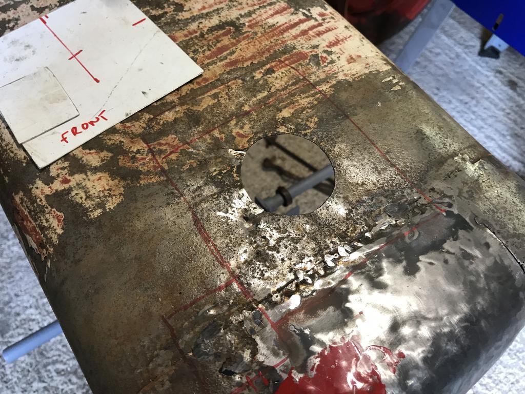

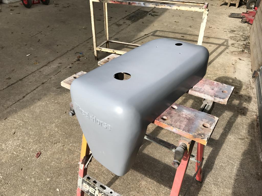

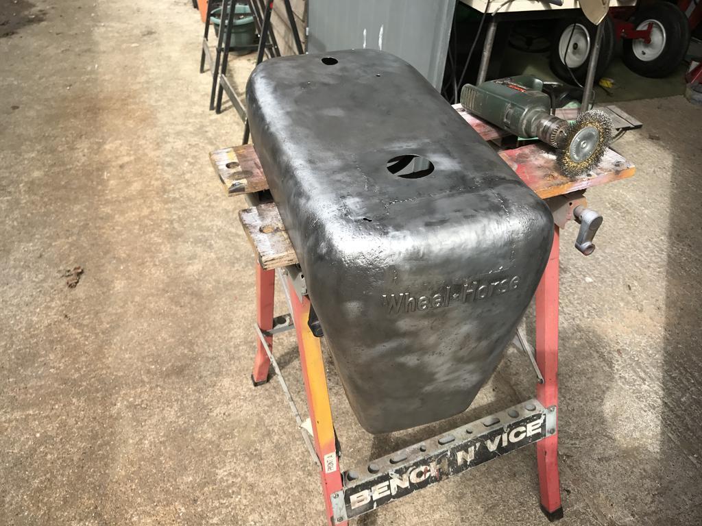

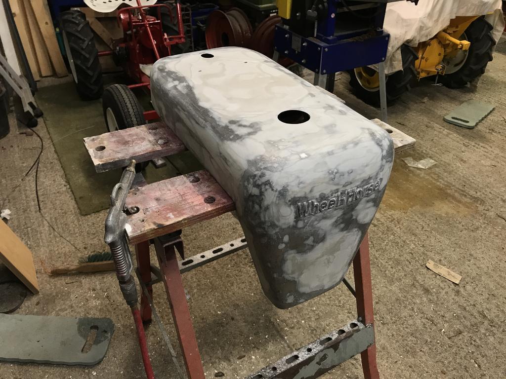

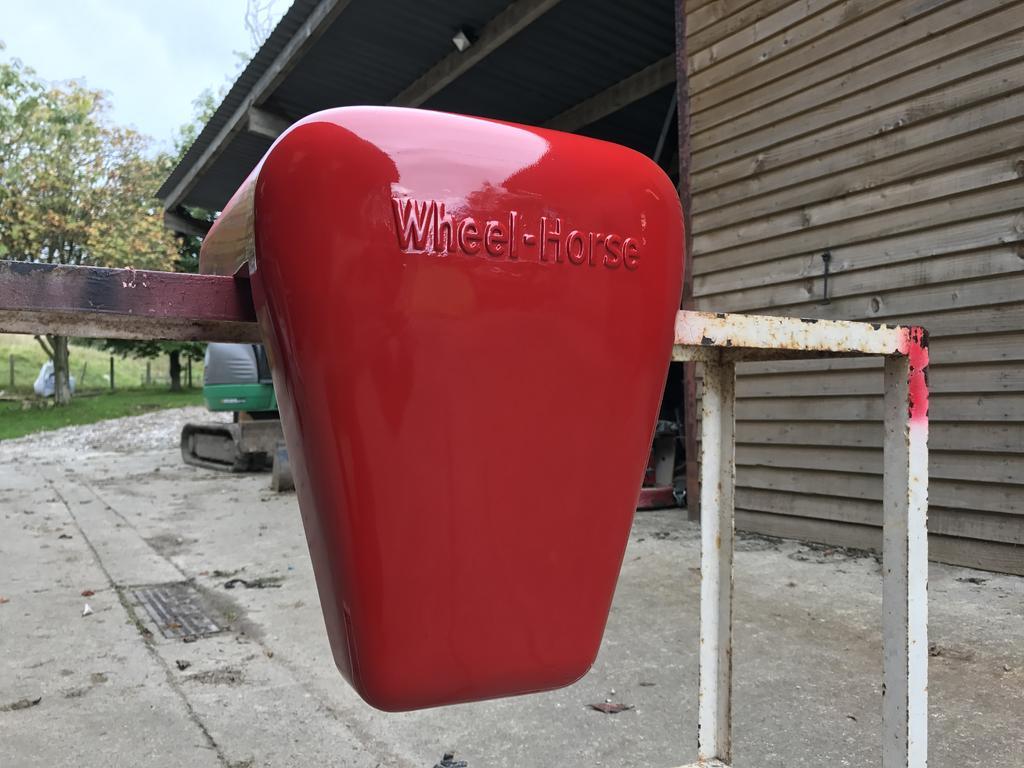

I tackled the fuel tank next which is a small size so harder to find.
As you can see the tank was gunked up, nothing was working to clean it so the only option to salvage it was to unsolder it and clean it properly.
In two halves.
Immaculate now, ready to solder both halves back together, I also found some small pin prick holes which needed fixing.
I thought i'd try using silver solder for the first time, I had to get it red hot in order for the flux and solder to do its job, the solder flowed into the overlap perfectly so i'm happy that its sealed properly.
The cap had a tab missing so I fabricated a new one and soldered it on, Has anyone got an idea about what the seal would've been like and where I can buy one?

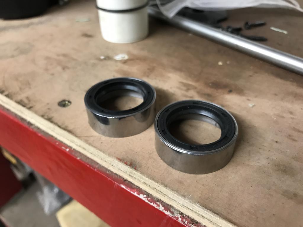

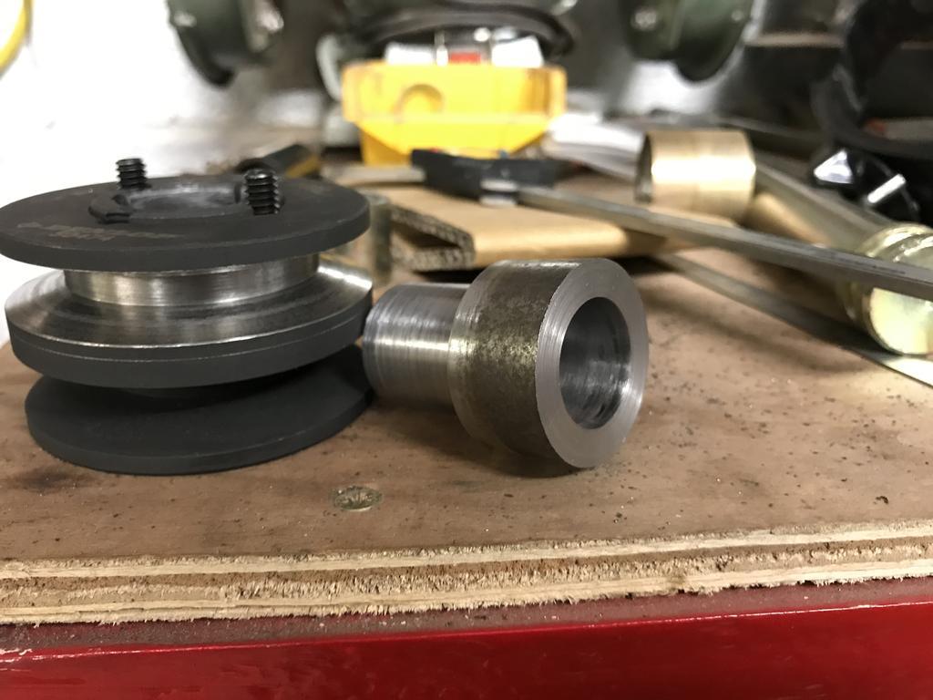

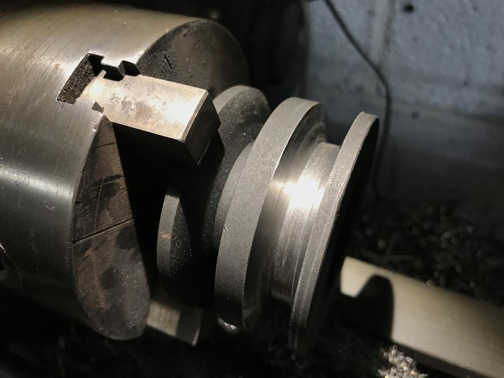

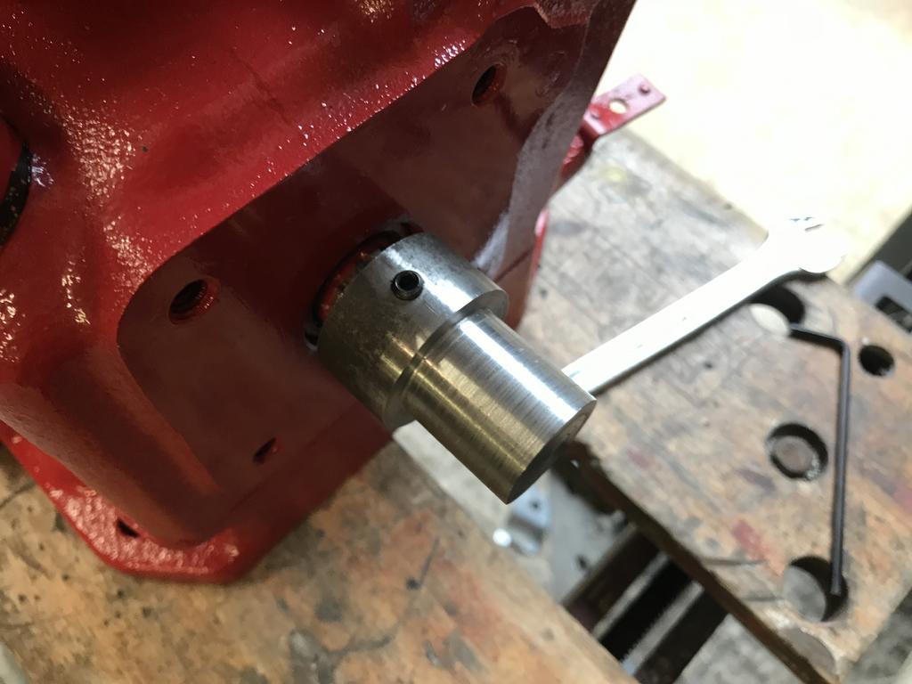

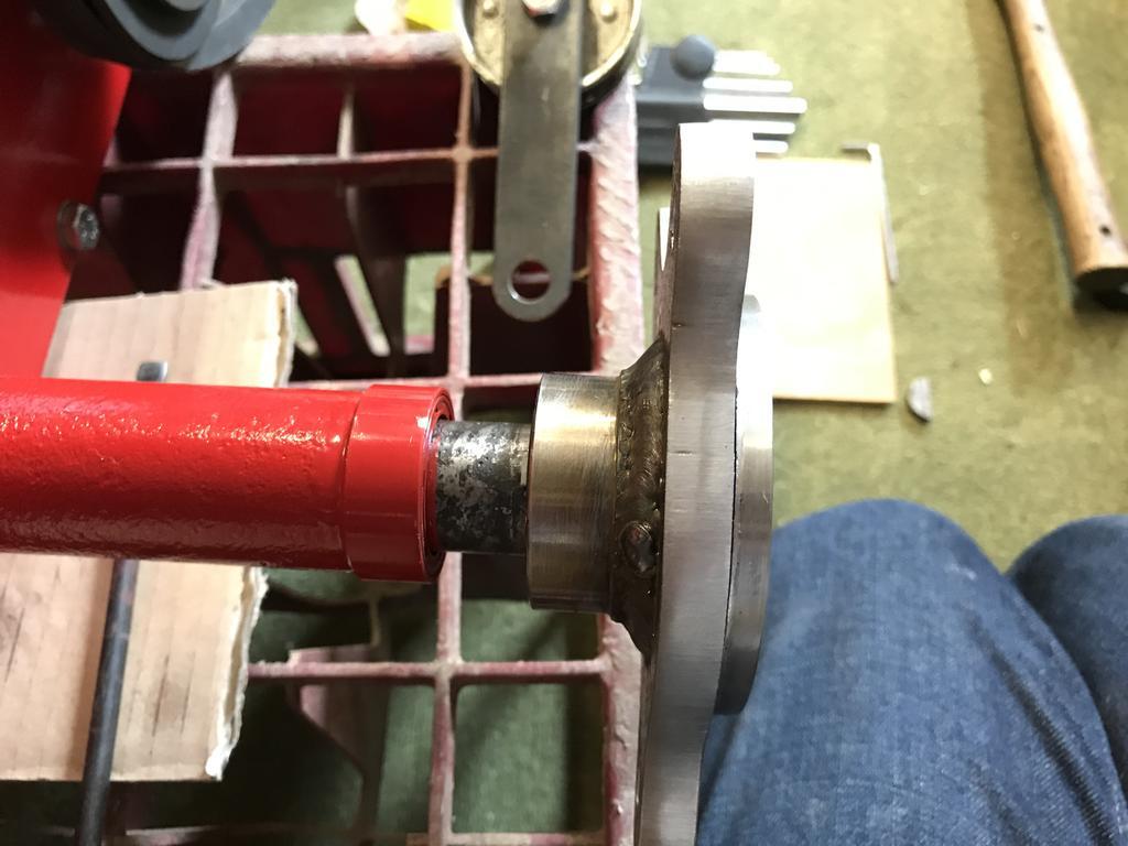

The original axle seals were missing and you can still buy them at $20 a piece, that wasn't going to happen so I turned some steel tube down to the correct dimensions and bough some seals to push into them. They fit snugly over the axle so hopefully they'll work :)

That cap most likely used cork for sealing against the neck. That’s what was used on all the old Allis Chalmers B’s, C’s, WD’s ect.
  • Thanks 1
Thanks, I thought it may have been

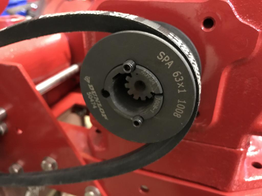

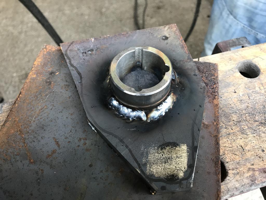

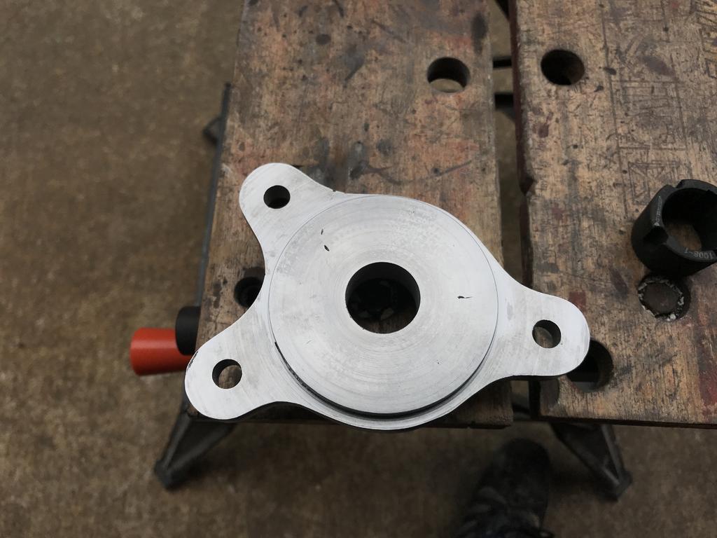

Next job was to make some missing parts, the first being the slot hitch.
First I cut out all the pieces of steel I needed
Cut to size

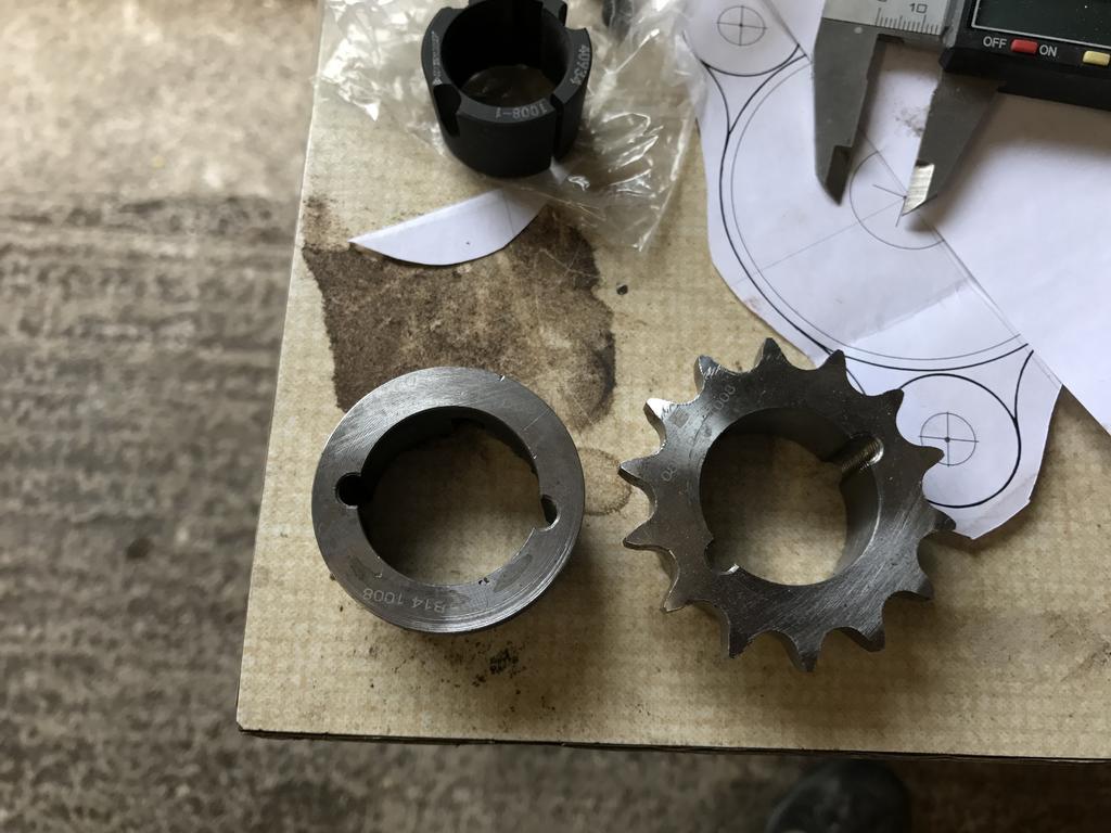

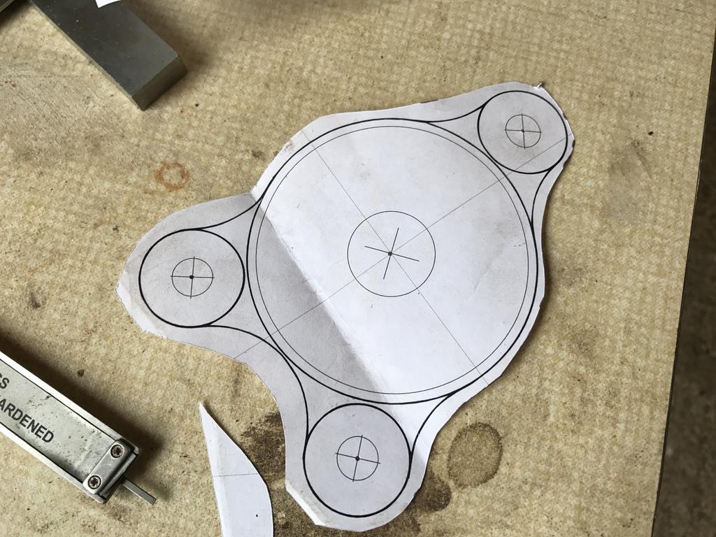

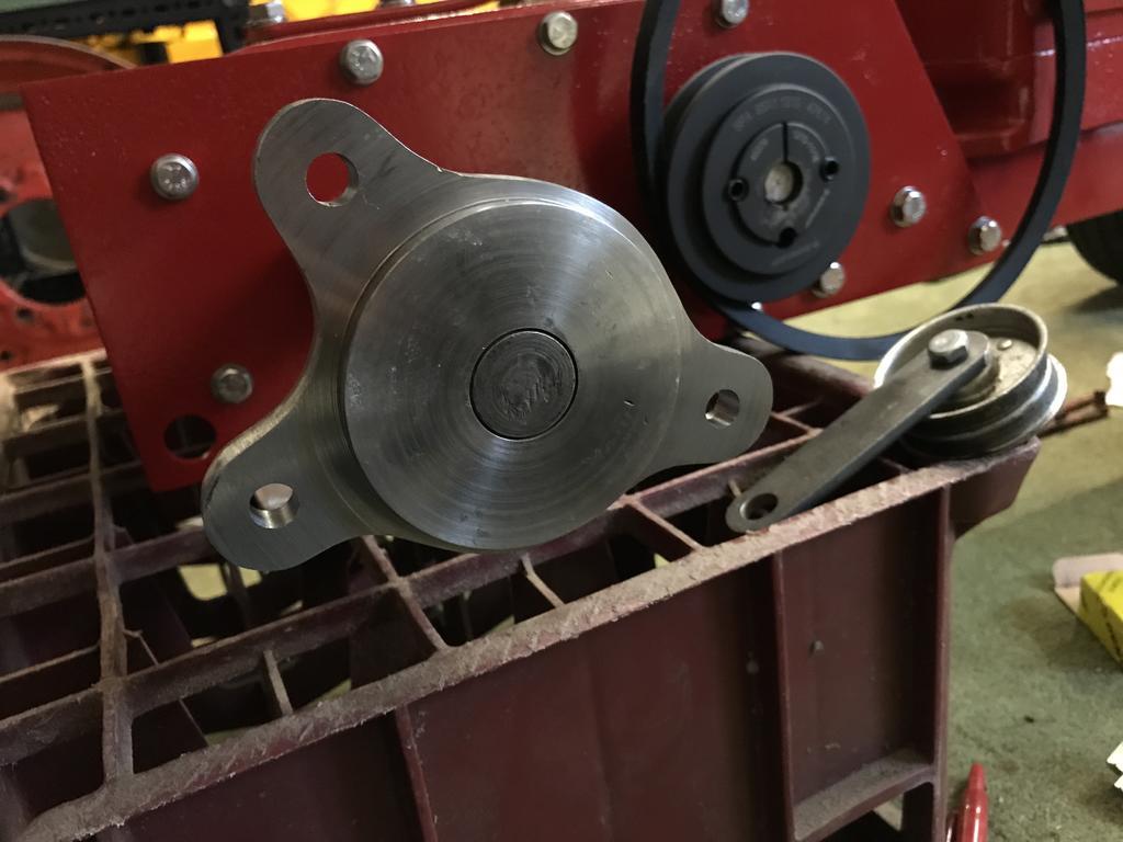

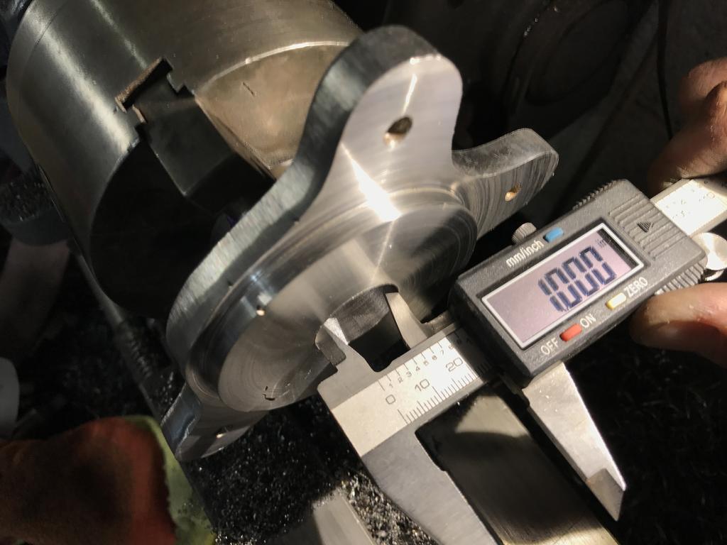

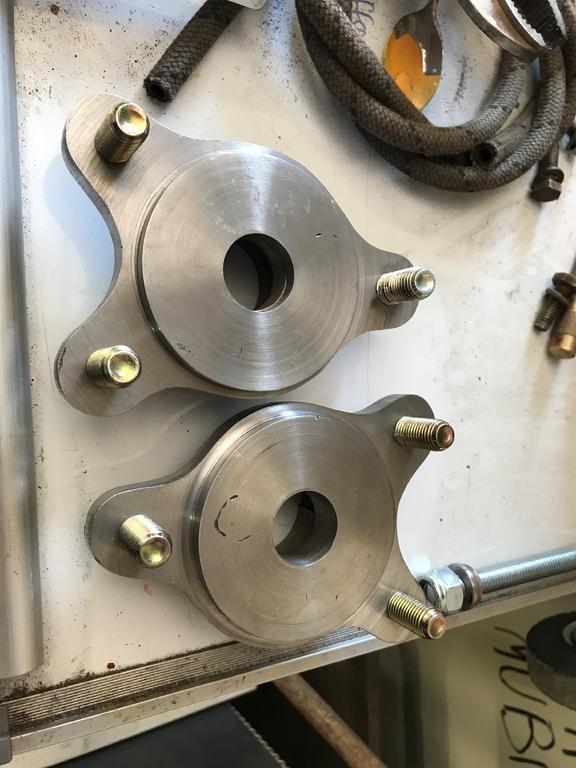

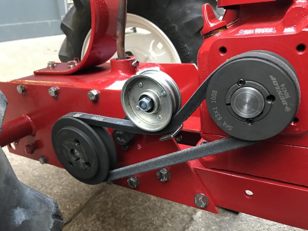

Another part that was missing was all of the clutch set up
All welded up
Im pretty happy with how it turned out.
