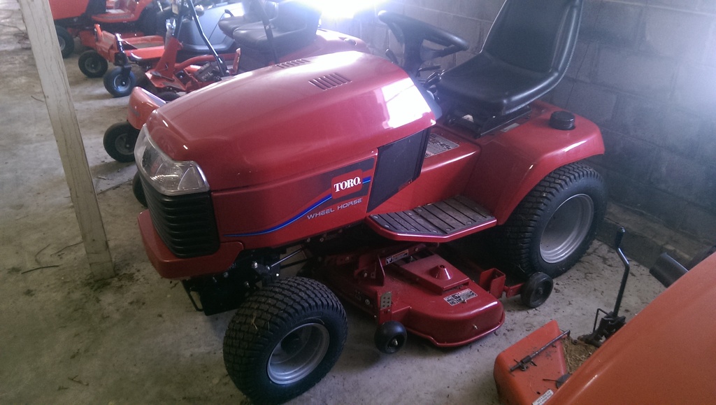

So I'm going to ask the WH "Lions Dens" opinion on this one?
As the story always goes I was searching 'that for sale site", usually looking for that rare old round hood and I came across this ....1997 Model 520xi Toro Workhorse, Number 73540 Kohler 20 hp, engine, Eaton 11 Hydro, 2 speed Uni-Drive® transaxle with a hydraulic lift 52" Side Discharge Mower. Seller is asking $600 and is selling due to moving from larger property to a small property across the country (He is the 2nd owner and has maintenance receipt's back to 2002 when he bought it. Last fall it had +$300 of service, (belts, blades, engine & transmission oils & filter changes. It runs good, no smoke, and has a few paint scrapes and the hood bottom front piece is broken, seat has cracks, tires seem good, Eaton transmission seemed to work OK but I did not get to get it hot and spin the tires with it against a tree,  deck appears solid, reportedly garage kept.
 I really don't need a 52" deck and would end up putting my 42" on it.  I'm a little concerned about all the electronic circuits on it (I sort of like the simplicity of my older 312 and C-160)
I have a John Deere LT150 :text-imsorry:as my mower tractor that I could sell to my sister and almost be no money out of pocket. I've only physically seen one of these, so I'm a rookie on these later model WH's!  I 'm on the fence of why this one interest me, so here's my questions:
1. Am I correct it does not have the "swept front axle"?  (I've read most 97's do not)
2. It does not have power steering....would I regret that?
3. Am I correct that my current attachments that fit my 1985 312-8 (42" deck ,long frame doze blade, grader blade, and tiller) will fit this tractor (since they fit all 300, 400, 500 series tractor)?
4. WH are somewhat rare in my area which means there usually a little pricier, but they all do show up for sale over time. So if I want a newer model should I be holding out for power steering and a swept front axle?
5. Yes I have the WH addiction, but do ya'll see anything in the pictures and price that I'm missing

I'd jump all over that, even if I didn't need it! And no, your 42" deck won't fit. XI series attachments mount differently than 300-500 series.
DennisThornton
While you are racing over to buy it (or why aren't you?)  do note:
classic attachments do not fit and "xi" attachments are much harder to locate.
Some of the 20hp Kawasaki had a plastic cam gear that disintegrate.  I don't have access to the year & serial right now but I'm pretty sure that yours is not affected.
I thought all the 520xis had power steering!  Pretty sure only the classic style 520s has a swept axle but you're most likely referring to the reduction steering that some had.  Never heard of the "xi" s having that.  If indeed it does not have PS then don't ever ride one that does.  It is wonderful!
The "xi"s are not only physically bigger but in my opinion a big step up from the classics.

My first words are: Buy it!  This actually a 1998
This 520xi is one of the five 5xi models offered by Toro Wheel Horse. I have a 520xi .along with a 518xi and 523Dxi. There was also a 520Lxi that had a water-cooled Kawasaki engine and power steering. The one downfall is that only the attachments made for the 5xi fit so your other Wheel Horse attachments won't fit. You won't be able to attach your 42" deck. I'm not sure how the widespread the marketplace was in your region for these tractors. It may affect finding other attachments, but they are out there. The plastic valance is probably cracked on 75% of these tractors. There actually is a sturdy steel bumper behind it.
  All of the 5xi models have a 52" wheelbase with the swept axle and a refined steering reduction system. It does have what they call "Smart Turn" which automatically, through a mechanical linkage, slows the tractor while turning. It was intended to keep the tractor from flipping if the operator had the cruise control engaged.
Two of my three do not have power steering. I actually find them to be more precise in driving. My Dxi has an additional 100 pounds on the front axle because of the diesel engine so I'm glad that one does. It is just personal preference.
The dozer blade may possible be able to be adapted but i am pretty sure the others won't without a lot of rework. The 52" is a good size deck for this tractor.
I wouldn't hold out considering the price on this one.
Just check the hydro like you mentioned.
Good luck and post any other questions.

If you could be no money out trading that green thing fgor this beast its a no brainer... you should already be on your way.
As mentioned above, any 300,400,500 series attachments do not fit the XI series (even though they too have a 500 number.)
This has a 20 HP Kohler as its a 520xi not a 520lxi, no cam gear issues but no power steering. I dont think you will miss it without having any super heavy front attachments as they have a very good steering mechanism.

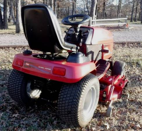

Last pic on the right Ollie looks like there might be some oil on the RR wheel from a leaking seal?? Pic next to it doesn't show it so maybe nothing. That deck looks to be a beast!  Good luck if you should snag it.

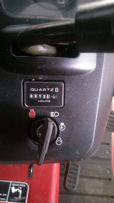

Hours????

It has 516 hours and the hour meter appears to work!
