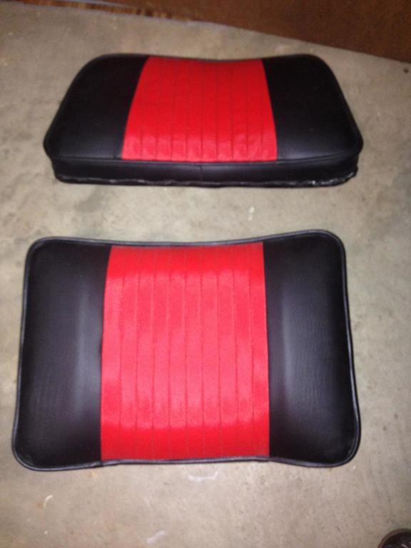

Lane Ranger 10,473 #26 Posted March 1, 2017 Bob: I have a non-traditional color scheme seat cushion and backrest for a 1054 tractor also! While black and white is the tradional look , I made up two seat pieces out of wood and my sister made me one black and white traditional one and one like I have in this photo. Red in the center and black on the outsides. Share this post Link to post Share on other sites
BOB ELLISON 2,976 #27 Posted March 1, 2017 23 minutes ago, Lane Ranger said: Bob: I have a non-traditional color scheme seat cushion and backrest for a 1054 tractor also! While black and white is the tradional look , I made up two seat pieces out of wood and my sister made me one black and white traditional one and one like I have in this photo. Red in the center and black on the outsides. I like that one too.i was looking for others that made seats and your post really helped my with mine. The seats wooden wedge pieces I still have to make. I don't have a band saw and a circular saw won't work so I'll have to find someone that can cut those pieces for me. Other then that I need to clean and paint the frame and the seat frame. I'll try to do more as the weather permits. I'll try to design some fancy covers and offer them to the others that need them.i seen some that look like alligator but the material I have on hand is all marine grade. And the thread is uv so it won't hurt it in the sun, won't do as much damage to it. Share this post Link to post Share on other sites
