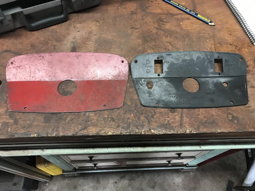

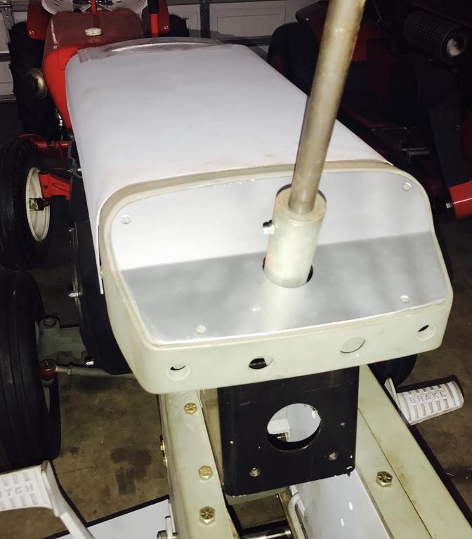

Only had an hour in the shop. With Predator the charging system is too weak to power the  lights and electrical PTO etc. So for now I'll use a solid steel dash plate that I'm in process of fabricating. That will also allow me to punch holes for more modern switches and gauges should I choose them. As can be seen I have a excellent dash cover if I was want to use one. I still need to do some to it but I got it 90% done today before I had to focus on life stuff.

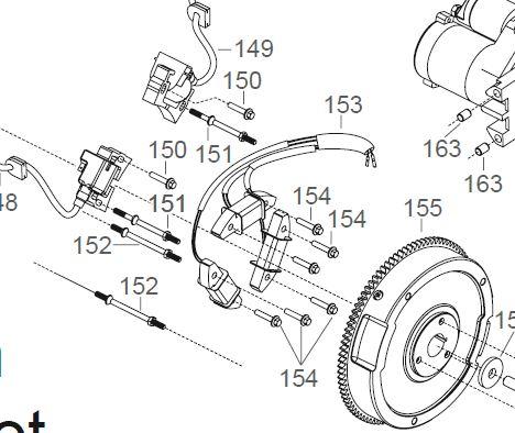

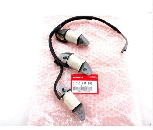

If you wanted to up the charging power, parts from a Honda gx630 will supposedly swap into the predator and get you an 18 amp (maybe it was 15?) charging system. Been awhile since I looked it all up.

From what I had noted, it was a different charging coil for 18amp system. Honda part number:
31630-ZJ1-802
I'd double check that since I never got to that point with mine.
  • Like 1
31630-ZJ1-802
I have seen internet chatter assuming this would work but no definitive confirmation. Although from images they do look like they would work. I may take the plunge and be the guinea pig. Pic of Predator blow up and pic of Honda coil.

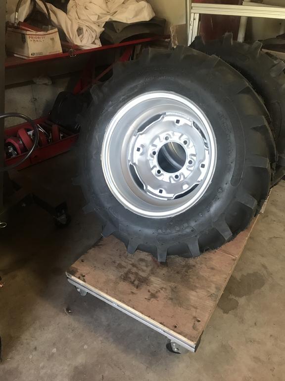

Busy week at work and Church.
Did finish the dash plate and got the rims painted.
These tasks were not necessary at this time but were easy short jobs I could tackle in between life this week.....and rain.
IMG_1368.JPG.32c6bd4c5d0ec49855c488b38492003b.JPGIMG_1371.JPG.94adc25a4dcbd6d1b8485a93299e6225.JPG
Edited by Aldon

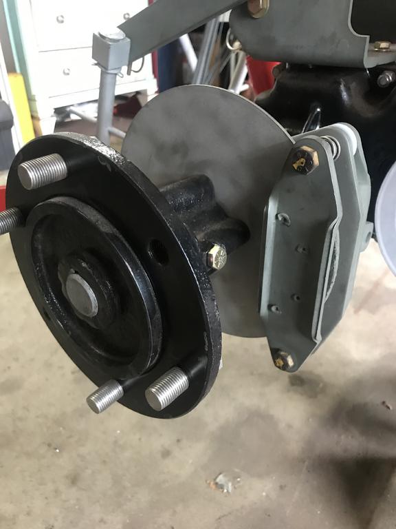

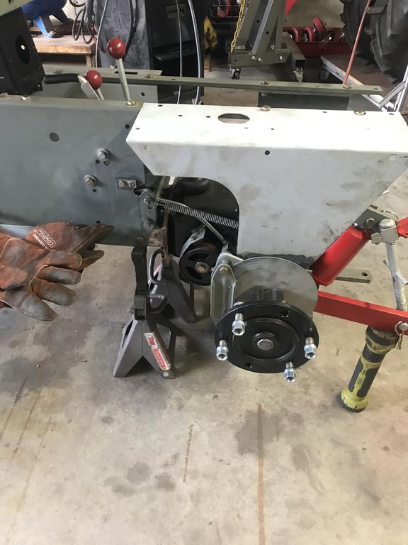

Custom brackets for installing brake calipers done. Took most of the day. Started modifying the inner fenders to fit.
  • Like 1
  • Excellent 6
I so look forward to your updates. Very impressive work my friend. One day when it cools off here and dries out, I hope to get rolling on mine.  Keep it coming my friend 👍
  • Like 2
  • Thanks 1
DId you come up with the brake design yourself or are you adapting an existing kit?
There is no kit for the GT14. This was never an option for the GT14. To my knowledge only a few of the d series could have them.
As such I bought a set of calipers for a cub cadet and modified them to work on the GT14.
Another fella on the forum rebuilding the 18 Automatic helped me with diameter of the discs. I ordered 8" stainless blank discs from EBay and punched the center out, then drilled mounting holes to line up with the D series Hubs which are drilled and tapped for the D series turning brake discs.
i have them located such that I'll likely run a cable to a set of levers to actuate the calipers. And it will be from the top. This is a work in progress with many trial attempts then realize something not taken into account drives  re-do.
I am about 90% confident this set up will work now. Once I modify inner fenders.
