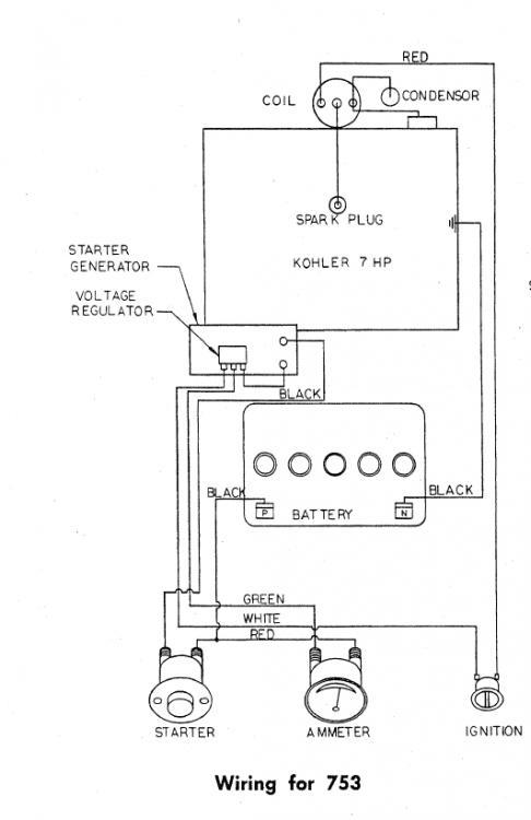

scotty 252 #1 Posted January 12, 2017 Im curious on how the wiring is supposed to be hooked up on my 753. Im not getting spark. Im curious about how the amp meter and the positive battery cable hook up. Is the cable from the amp meter supposed to hook up to the starter button? Share this post Link to post Share on other sites
Texas Todd 1,024 #2 Posted January 12, 2017 From the manual: 4 Share this post Link to post Share on other sites
