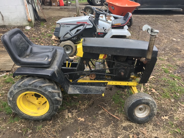

Fatman 0 #1 Posted December 30, 2016 So I got this mower for off-road use. It was built up as a pulling tractor is the story and is supposed to be pushing 21 horse. It's a kohler 341 engine. Well it was cheap so I got it and figured I'd take a chance. I have gotten it to run for about 20 minutes without touching it but it ran real rough other than that it doesn't wanna run. I've changed the carb, check the fuel line all the to the carb and fuel flows good and fuel pump works good. I've set the spacing on my valves and points along with replaced spark plug. When I lay the spark plug on the engine it still gives a spark. I just don't understand why it doesn't want to run. I have also tried the gas cap off trick and nothing. My best bet is starting fluid but after that burns up it dies Share this post Link to post Share on other sites
