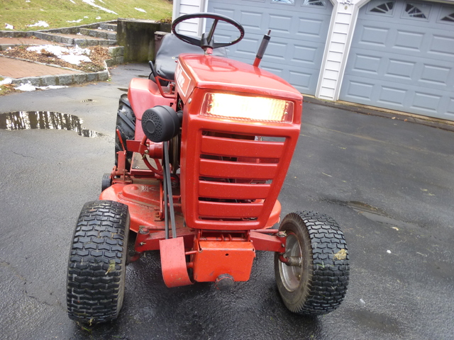

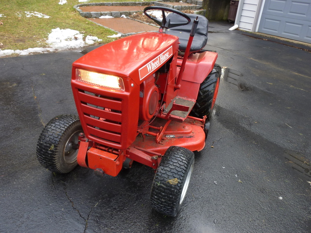

Rob R
C-81 Lite-up
Actually, looks better than factory.  :clap:
Achto
Very nicely done!:text-bravo:
Sparky
Looks great and you didn't have to chop the hood!
  Mike.....
Rob R
  Mike.....

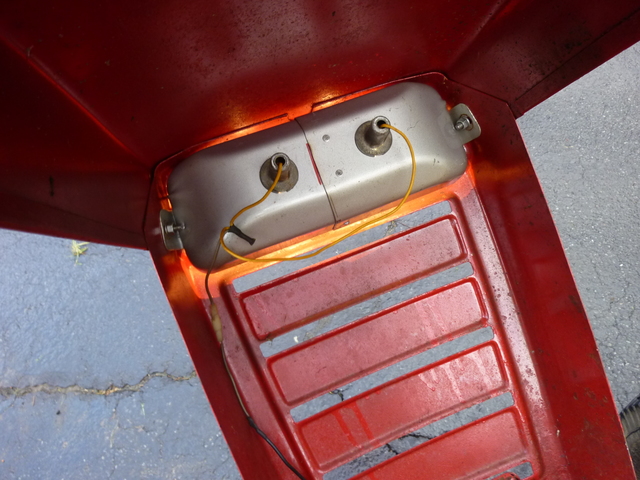

Thanks Mike I was also surprised how well it fit in the narrow frame, I would say I shortened the light bracket about 3.5 inches, slide the two halves together, used four pop rivets to join the fixture together and two small carriage bolts on each sit to fasten it to the tractor hood.
