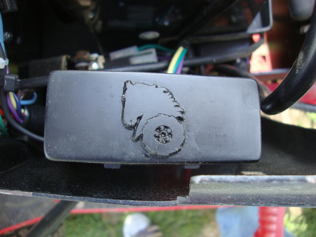

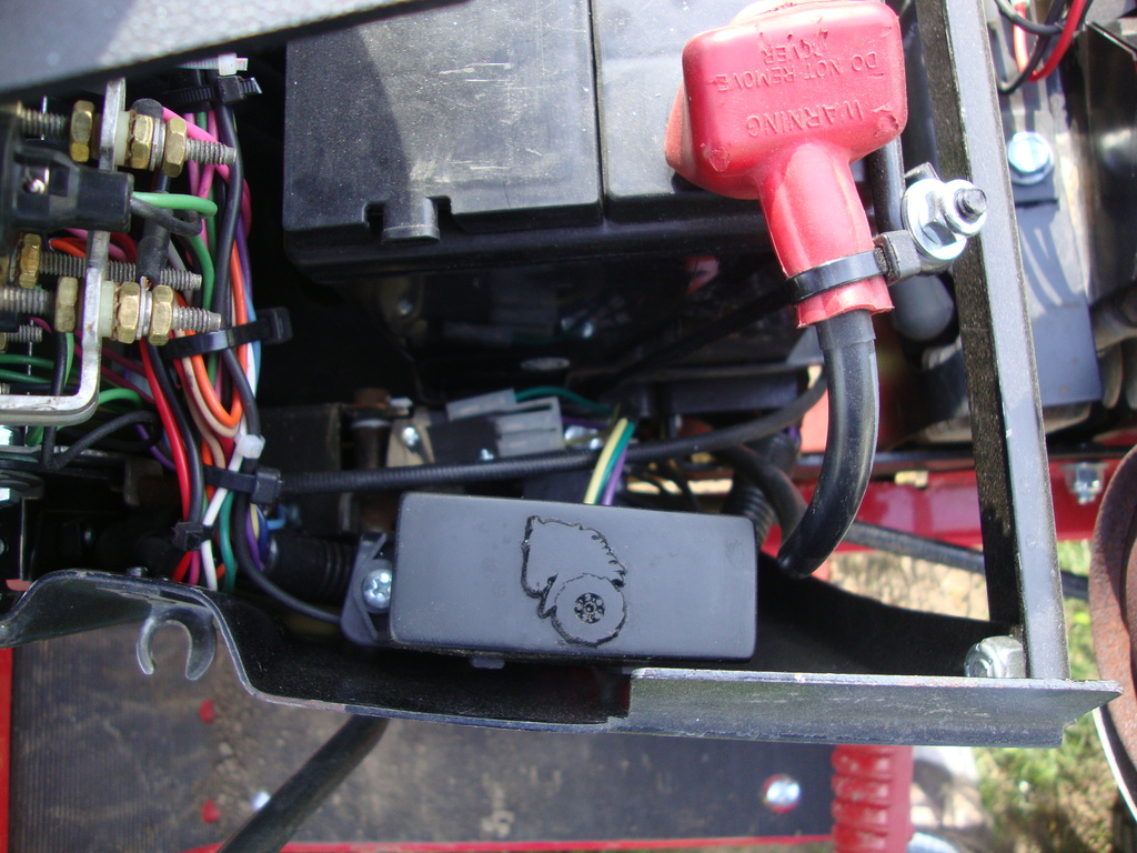

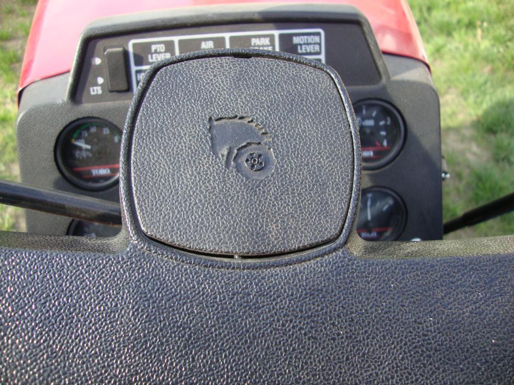

I picked up a couple of nice finishing touches for my 520 a while back from Glen Pettit, the steering wheel insert and fuse block cover and very well made and you can't beat his service. Thank you Glen for all you do for our hobby!!

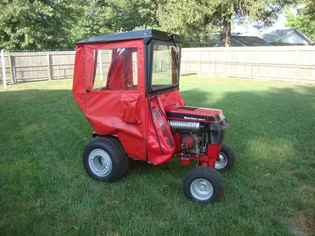

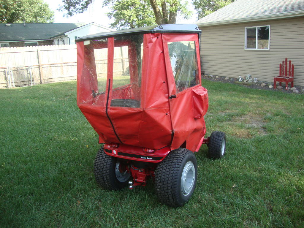

Wow!.. Glad Mike drug this up. I missed it too. Denny, that looks great. Has there been any follow up since it's now a year later?
Haven’t done much with it, Jason. I picked up a nice tall chute blower for it last summer and bought a cab last November that a buddy picked up for me. I still need to go pick up the cab and hope to get it mounted this summer. This is my snow machine.

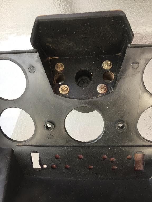

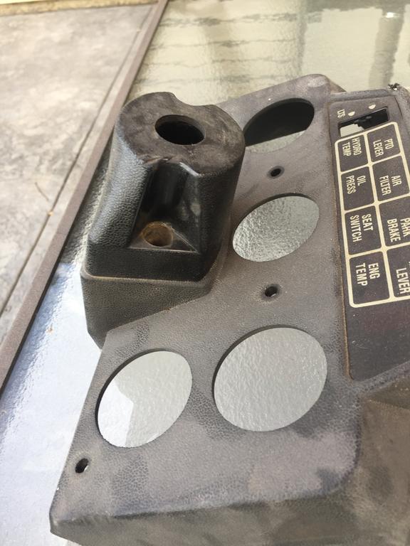

Hey denny that's a nice looking tractor could you tell me how to get the Gage dash off of the tractor there's already pulled the steering wheel off and it appears there's a cone piece of plastic that needs to come off to get the other two levers off to pull it off but I wasn't sure how to get that off without breaking it thank you
Posted (edited)

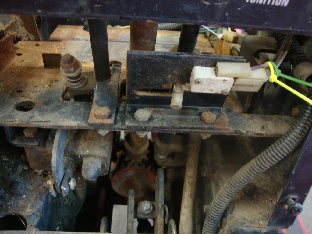

Rick, it’s been a while and I’ve only done it once but I think you need to remove the access panel located under the ignition switch and unhook the motion control lever and the hyd lift lever and remove them before or with the dash. The plastic cone is attached to the plastic dash with 4 screws from the back side.
Edited by dclarke

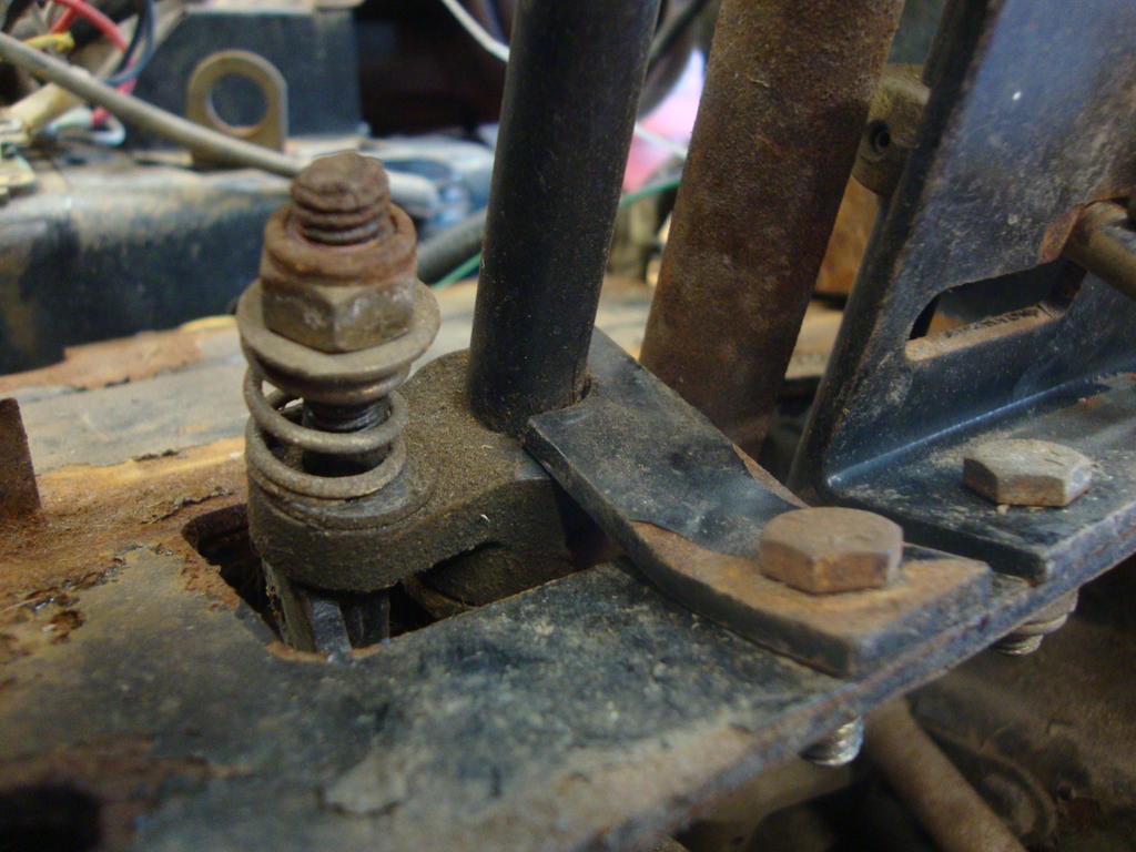

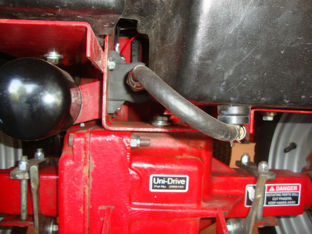

Rick, these are the only pics I had of how the lift lever and motion control lever hook up. Hope they help.
Okay thanks I will look into that today see what I come up with thanks
