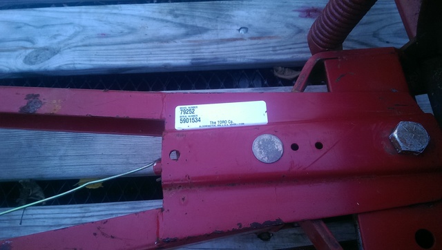

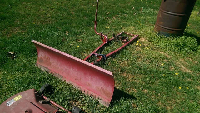

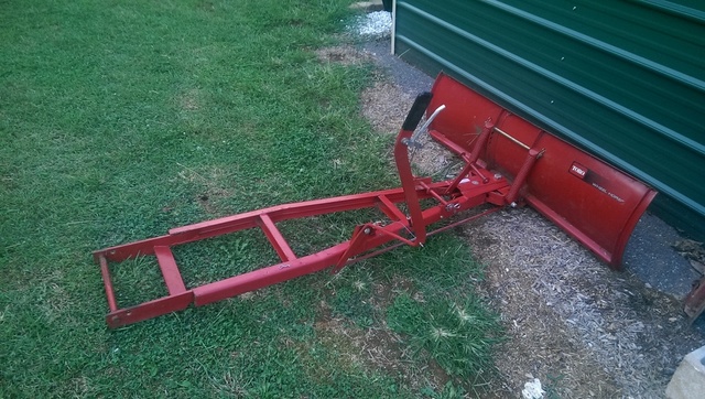

I just bought a used 48" plow model #79252. I have an older 520XI tractor. Will it work on it? We started to install it this morning, but seem to be missing parts.
79252 blade for the 260-Series lawn tractors.
The 5xi -Series use a blade like this
Garry
John & Shela
Anyway to use the 79252 blade on it? Maguyver it?
doc724
With enough time and money you can do anything.  In this case, your are probably better off buying the plow that is made for the Xi machines.
WVHillbilly520H

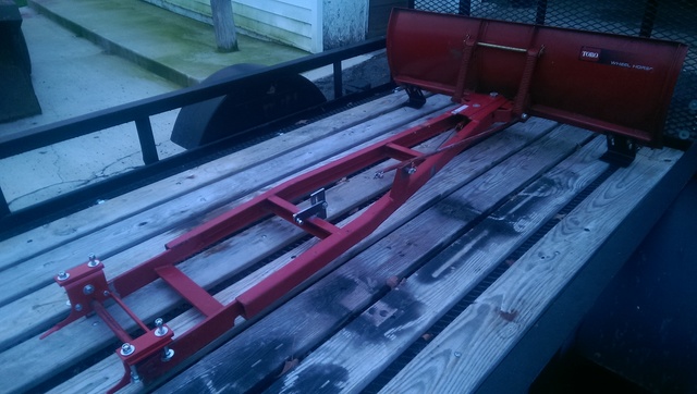

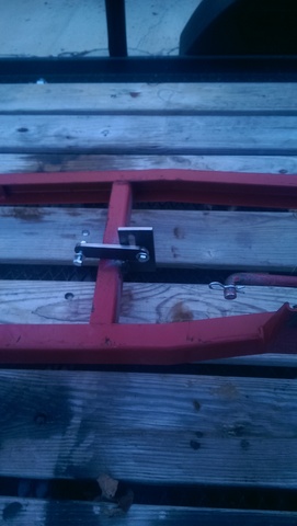

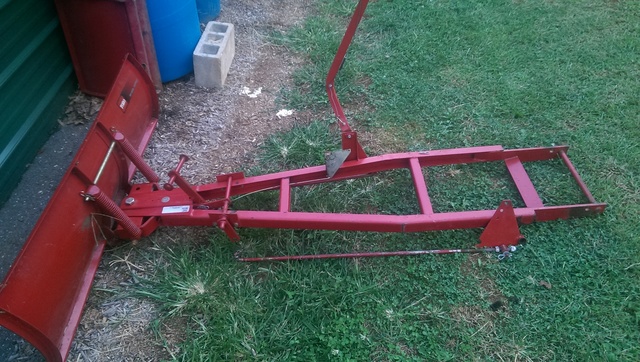

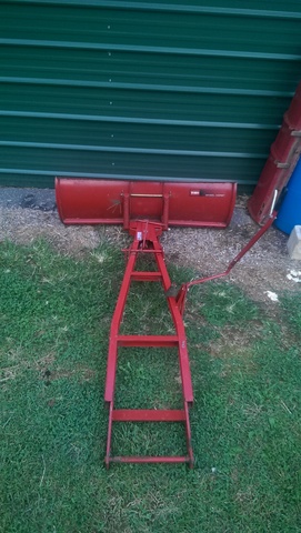

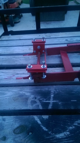

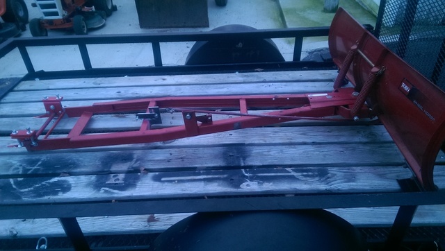

Ok here's a few pics of both versions...don't know the dimensions offhand but but basically need the lift point(clevis hitch around it) for the xi(top & bottom pics) fabbed on the 260(3 middle) blade frame if the angle handle will clear the foot rests, and also the sway bar bracket will be needed also the 260 blade has lift point/bracket there...Jeff.IMAG1992.jpg

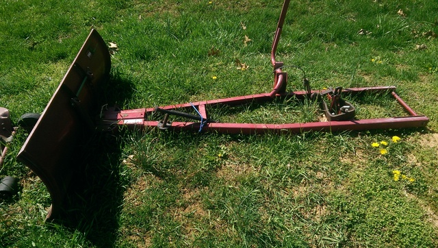

I just finished converting the model 79252 snow plow over to install/hook up on a "classic" B,C,3-4-500 series it was very easy, only thing that may not work properly is the angle lever/handle but the rear quick hitch and center lift link is all fabbed up,Jeff.
