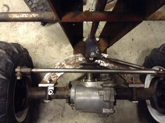

I'm sensing there is going to be some sort of interference between the drive pulley on the front axle and on the steering system where the tie-rod will attach.  Did you run into that?
5 hours ago, bds1984 said:
Thanks Mark!  At the time, those tires were the only style I could find unless I wanted to spend as much on one tire as I have the entire build so far.
Not that I recall, it's three years ago, here's a build pic of the steering. If it makes you feel better I paid more for the axle, wheels and tires than the original tractor...that cost me £300 ($450) with deck and trailer!
