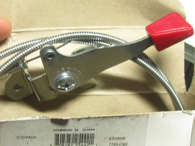

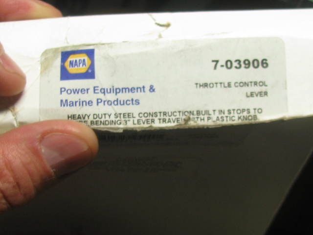

if you know where to look, there's always this option.  :handgestures-thumbsup:

Wow, Thanks Craig! That appears to be an exact match to what mine looks like. Have you bought that recently and are they still available? One thing though, is the cable the right length or will I have to cut it down some?

It's a direct bolt on , and yes there still available . I pull the wire out , cut outer shield with cut off wheel to desired  length . Feed wire back through and cut off the extra . Easy peasy :) .

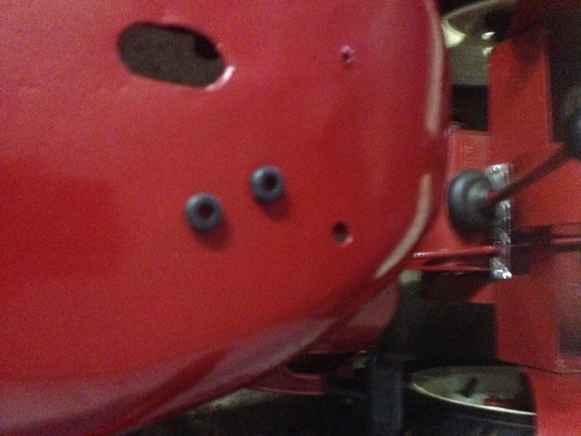

Looking great JohnDeereelfman!
I am redoing an RJ 58 also.
I bought the same  throttle cable Craig posted  pics of from NAPA  !   It will do a great job.

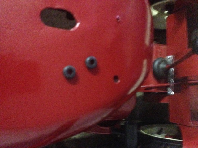

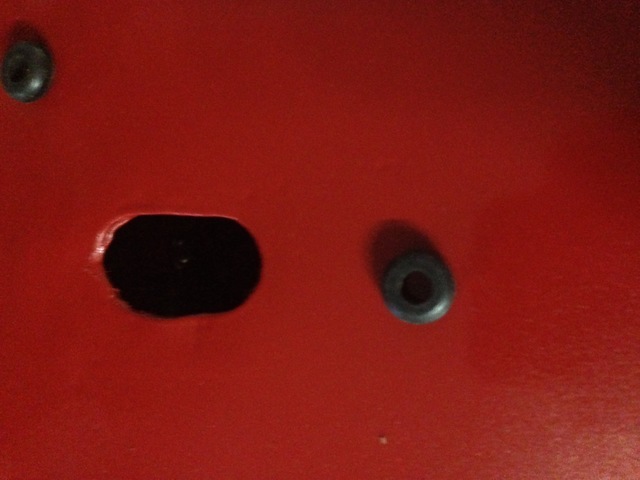

Also don't forget the small rubber grommet that goes in that throttle cable hole in the top of the hood.    I bought mine at the hardware store yesterday.   but they are  like the originals.

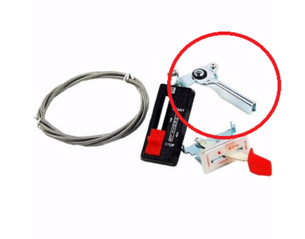

Go to Tractor Supply and buy the Universal throttle control and use the plain one.

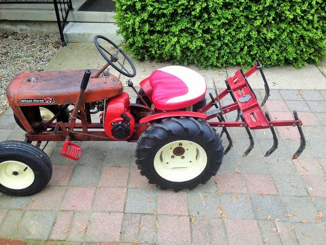

This is the correct type for the 1958 or 1959, I don't think the plastic knobs were used prior to '60. Both of my RJ barn finds had the plain type like this.

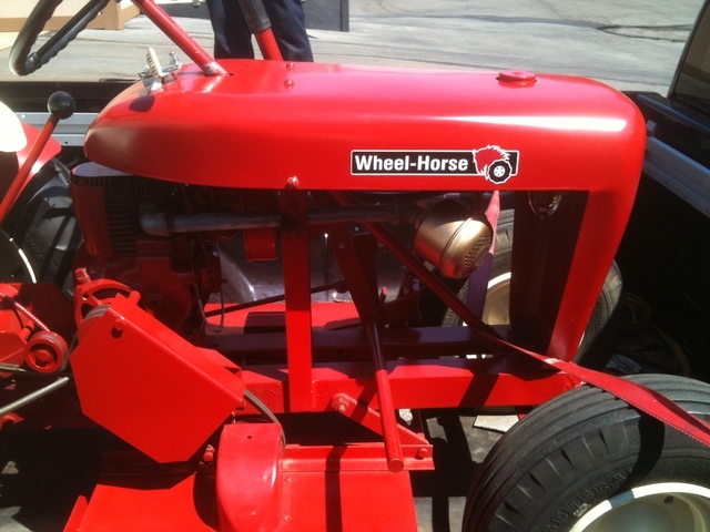

:dunno: You'll see more than a few of 'em used here.
  • Like 1
Two of my three RJ's have  plastic knobs and my  third one I am redoing  will have the NAPA throttle with the platic knob.   I have  seen several with the metal handle knob  953 Nut posted also!
  • Like 6
My 58  has the style that 953 showed , and the 59 had the plastic knob , but that tractor also has a solid seat pan . :confusion-shrug: maybe because it was a later 59 ?  I've seen the all steel version on  :techie-ebay: checking out Bolens parts .

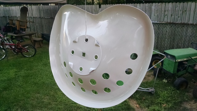

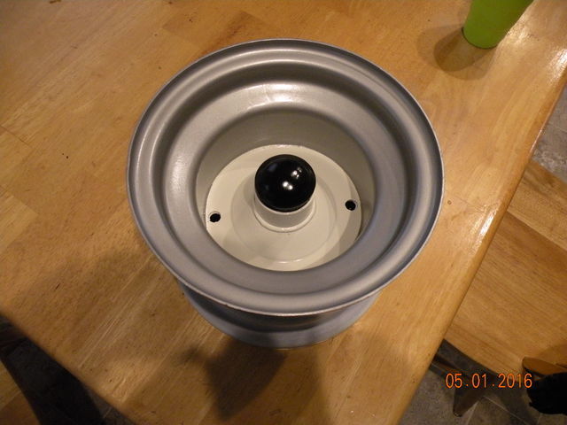

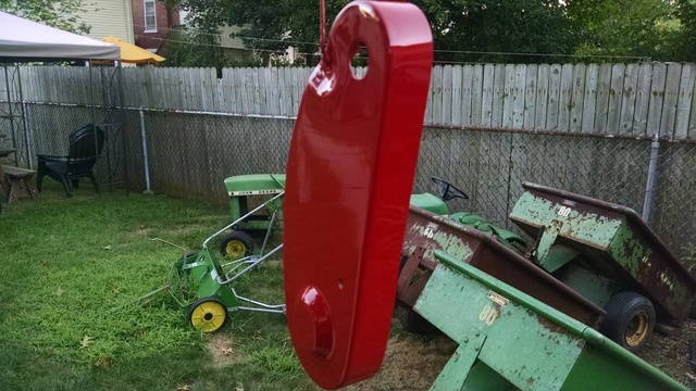

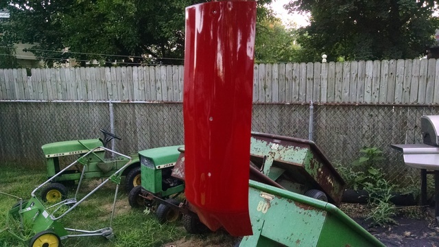

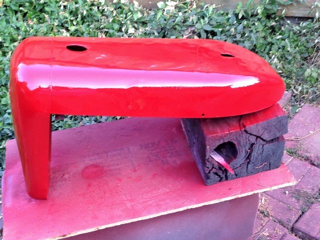

Tonight I had a little time to tinker, so I wet sanded some parts with 800 grit and applied a second coat to the muffler shield, the belt guard, and the seat pan. Still not the shine I'm looking for, so these will be wet sanded again at least twice, and re-coated each time with finish:

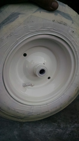

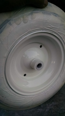

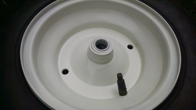

I also didn't like the finish results on the first front rim, so I wet sanded it with 1500 grit, re-taped the tire and valve stem off, and gave it another coat of white. Not quite there yet, but coming along much better!
Before:
After:

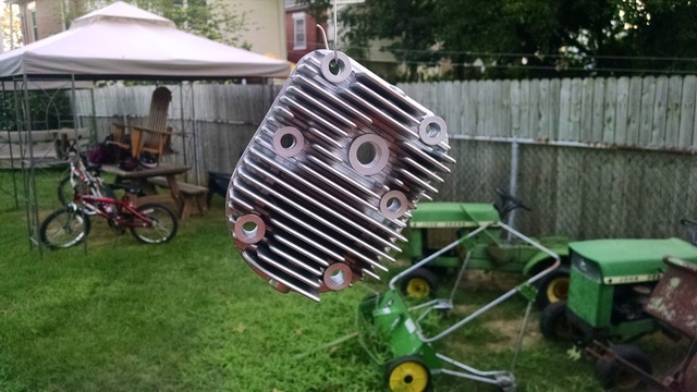

I also painted the head, the carb, and carb elbow, however I don't like the aluminum paint finish. I have some left over John Deere Sabre silver that I'll be using to repaint the aluminum parts, as I really don't like the chromish/polished look of the aluminum. I want the aluminum parts to be more of a satin finish:

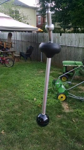

I also installed the knob and boot to the shift lever tonight. I elected to go with the larger knob so that my son can have more to hold onto while shifting gears. I realize this tractor is supposed to have the smaller knob, but I don't feel it will ruin the appearance of the tractor any. With just the boot and knob assembled on the shift lever, my son felt like there was a little more progress being made and knows that we are closer to getting the tractor assembled:

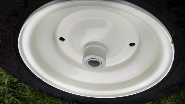

I just freshened up the wheels on my C-161 and used Dupli-Color Ford Wimbeldon White (M, 9A) and then used the same brand clear coat. I've tried several brands/colors and it the closest match I've found. It's available at many Auto Parts stores.

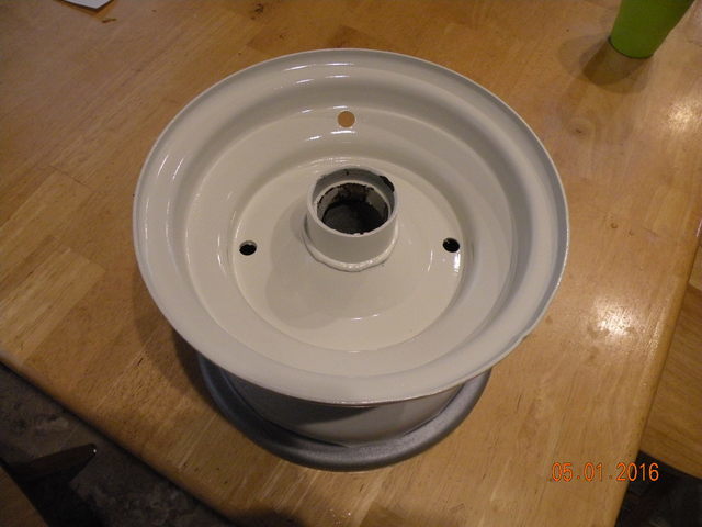

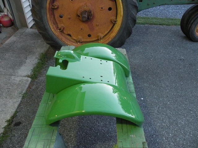

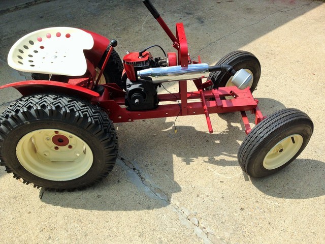

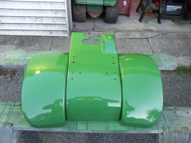

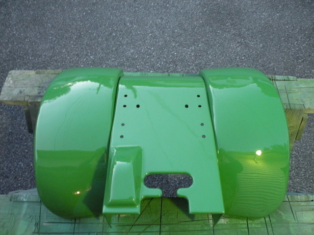

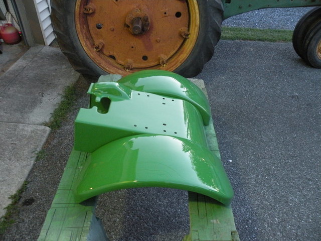

I haven't used their IH Off White, however I have used their Allis Chalmers cream. Tallmans paint is supposed to be an exact match in shade for all of the major tractor brands, and so far, I have used their John Deere green and yellow, their Allis Chalmers orange and cream, and of course their IH red and bright white, and I have no complaints whatsoever. I'm very happy with their paint, and will continue to recommend them to everyone. Here is how my oldest son's fenders turned out for his John Deere 70 lawn tractor that we are slowly restoring. And the other picture is of the Allis Chlamers cream that I used on the two tone wheels for the Allis Chalmers barrel train car. All done with spray/rattle cans.
Now granted, I didn't spend as much time on the barrel train wheels like I did on the fenders, but I'm positive you would get the same results with a little more effort.
