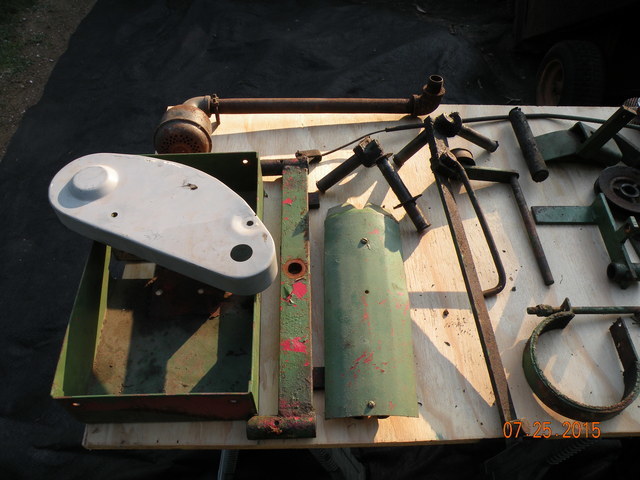

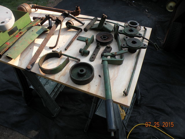

I acquired this tractor a couple of years ago from a guy who thought it was a John Deere round fender. I currently have 31 lawn & garden tractors in my collection, all John Deere's, and nothing newer than 1973. I wasn't going to buy this tractor due to it being a Wheel Horse, however since it's an RJ and my youngest son's name is Ryan James, I figured I'd bring it home. Yes, this is the only "red" machine that I own.  Anyway, once it was home, I took the tractor completely apart due to limited storage space in my garage, never thinking to snap a couple of pictures first, so sorry guys, I have nothing for you to compare it too when it's done. I'm slowly finding all of the parts and pieces, so as I do, I'll update as I go along. Here is what I started with July of last year. Each piece is getting completely stripped, primed, and first coated for now. I'll get to wet sanding and additional coats of finish later when all of the parts can be done together at the same time. As you can see, this RJ was repainted green at some point in it's life time, however I'm hoping to make it look as good as it would have been off of the showroom floor.

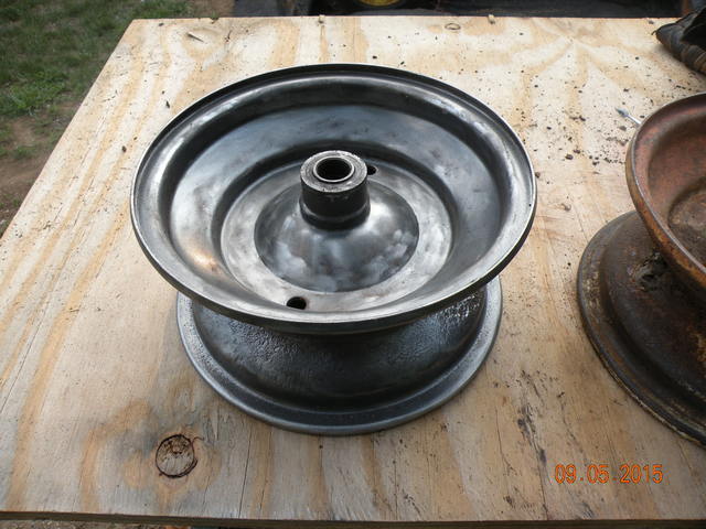

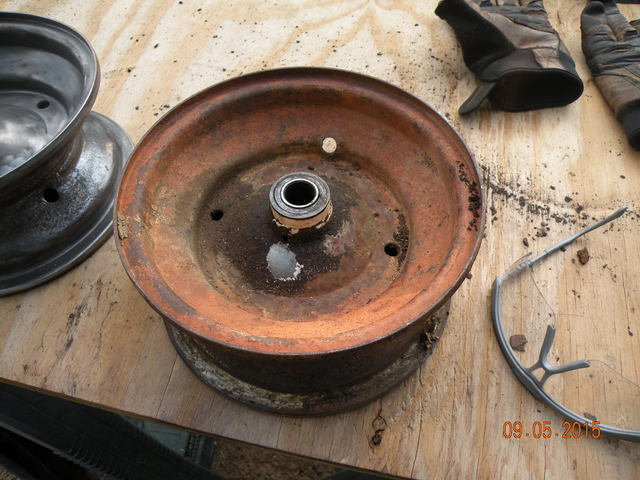

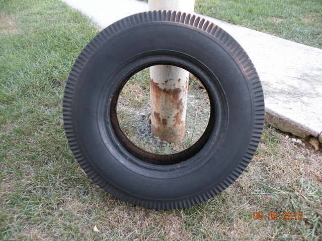

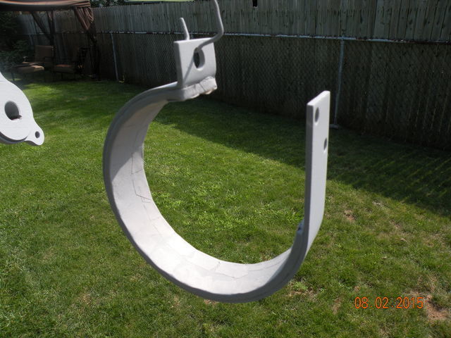

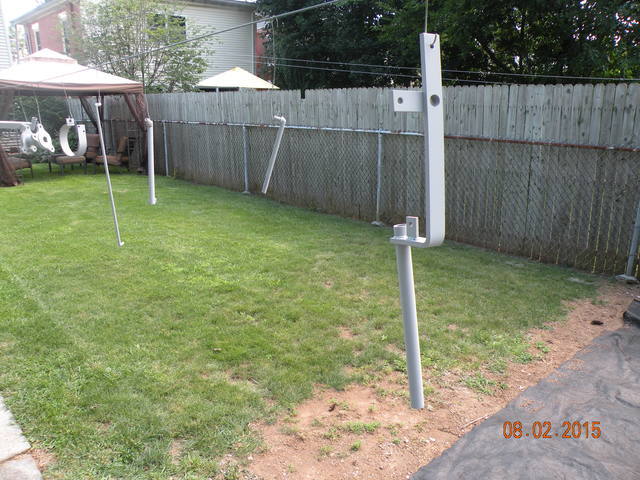

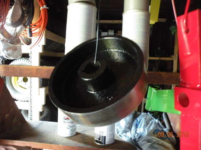

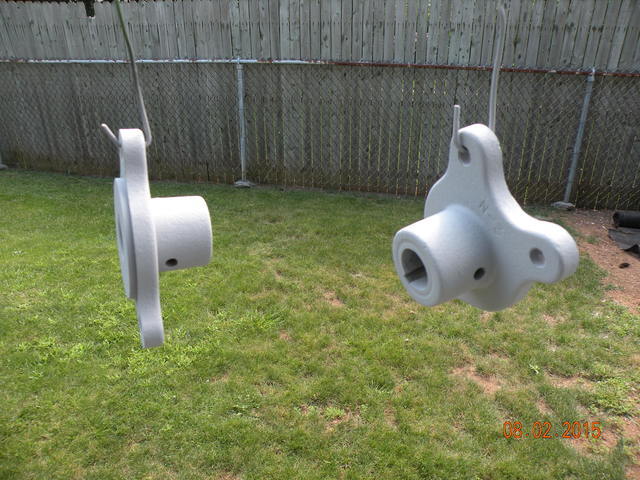

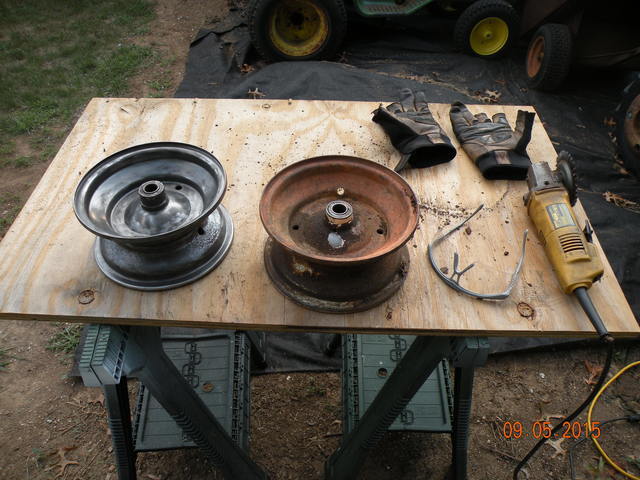

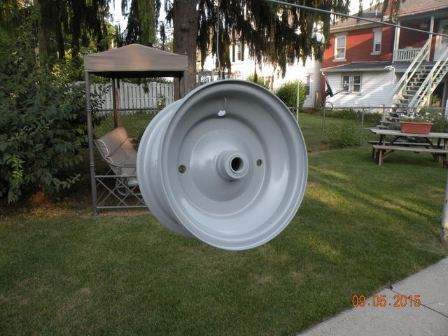

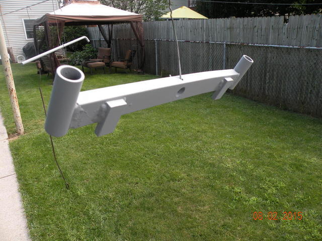

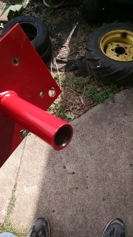

I have the lift arm, front axle, rear wheel hubs, brake band, and a few other small little pieces stripped and primed. These pieces hung for a few days then were lightly sanded with a brown paper bag, and re-coated again with primer. I also spent the extra time tapping off the brake band.

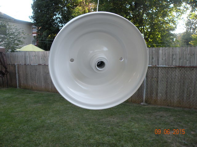

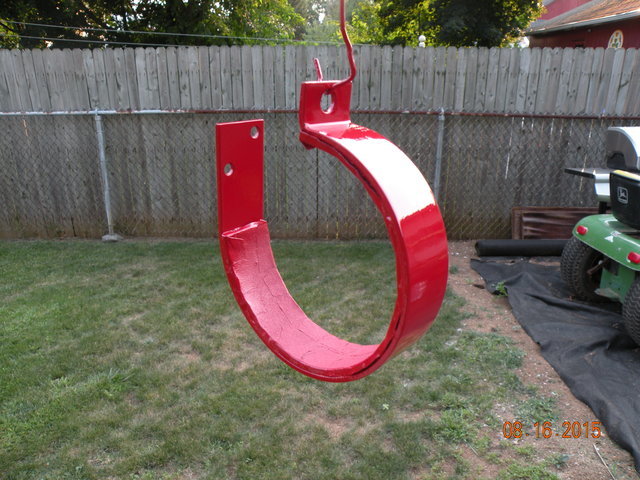

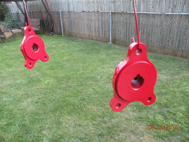

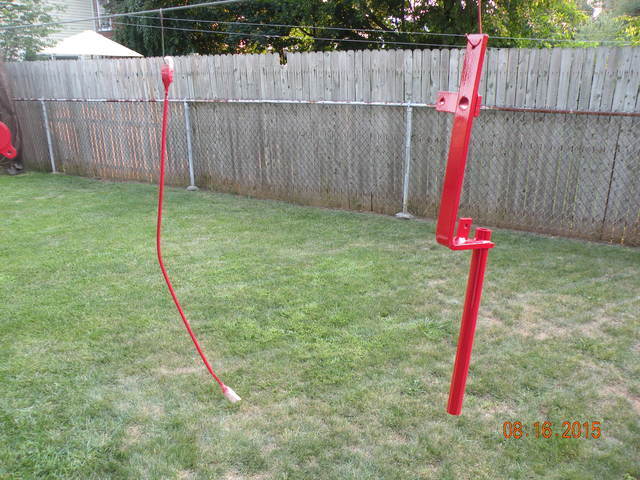

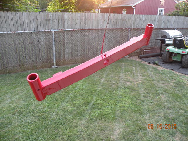

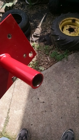

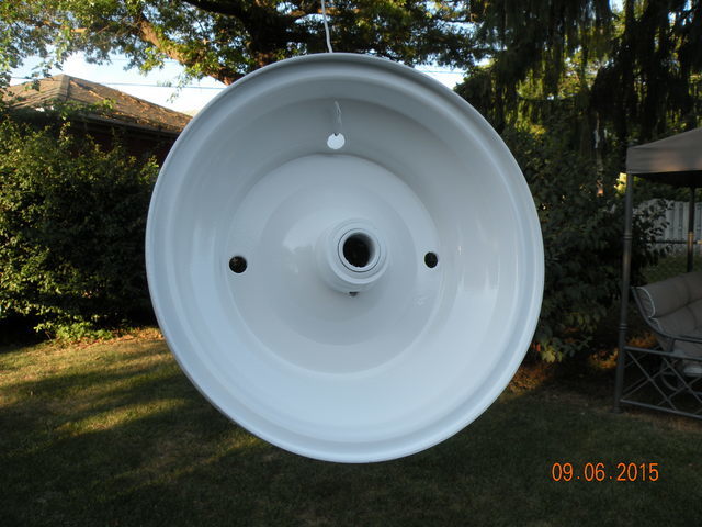

Here's the front axle and brake band with two coats of finish applied. These will hang for a couple of days, then I'll wet sand them with 400 grit and re-coat them again.
I just signed up to be a site supporter, so once my payment clears I'll post more pictures of my progress. I'm a lot further ahead then what it appears in these couple of photos with the restoration. As you can see on the date stamp of the photos, I started this restoration July of last year. :(

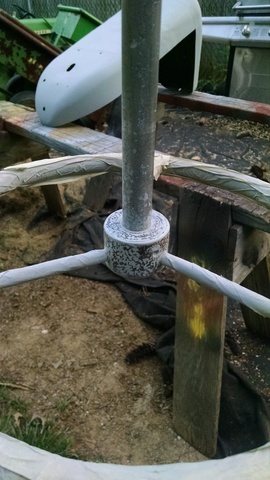

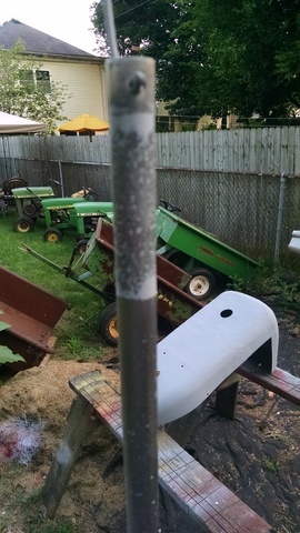

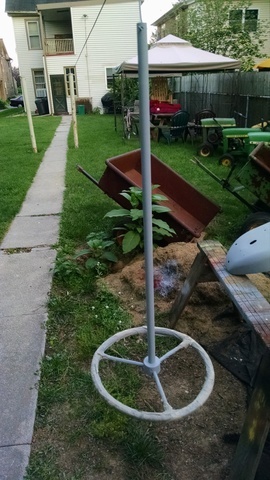

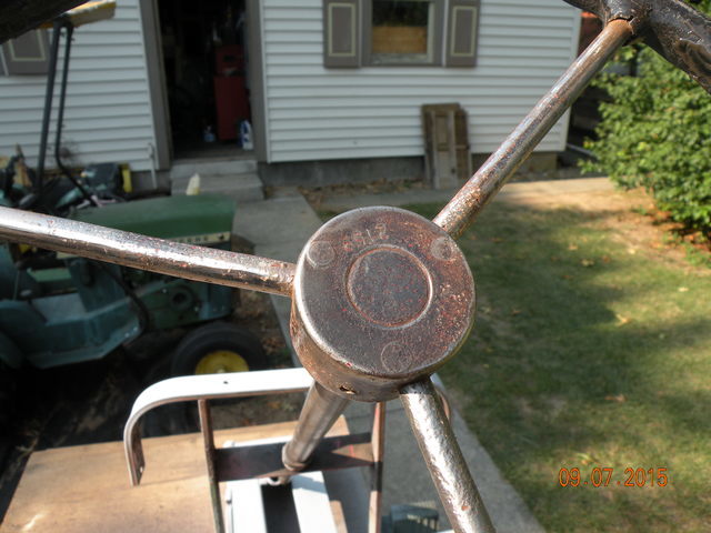

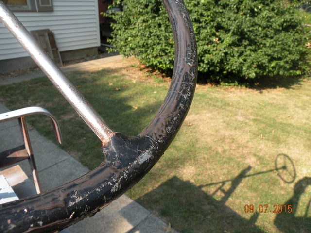

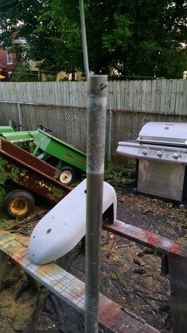

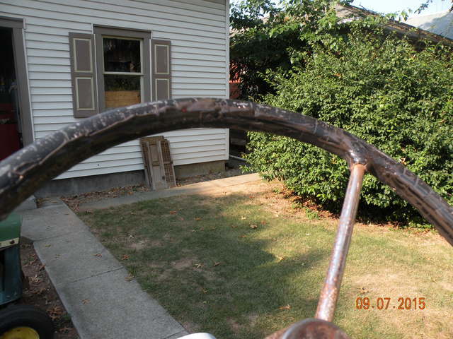

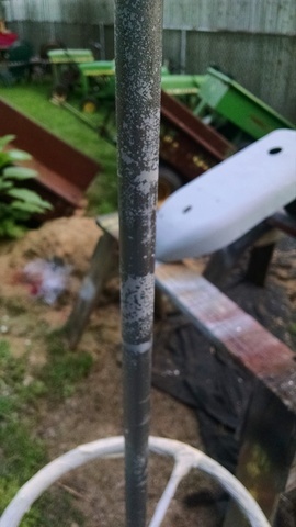

I started working on the steering shaft/column. It has numerous cracks throughout the steering wheel, so I filled them with JB Weld, then I will sand and file down all of the areas in a couple of days. The shaft also had quite a bit of small rust pits, so I applied numerous coats of primer (letting dry between coats), as this is my way of filling in these little voids, as I don't use Bondo anymore than I have to. Once the primer is completely cured, I will sand down the entire shaft so that all of the pits are filled and smooth and un-noticeable once the finish coats are applied.
  • Like 5

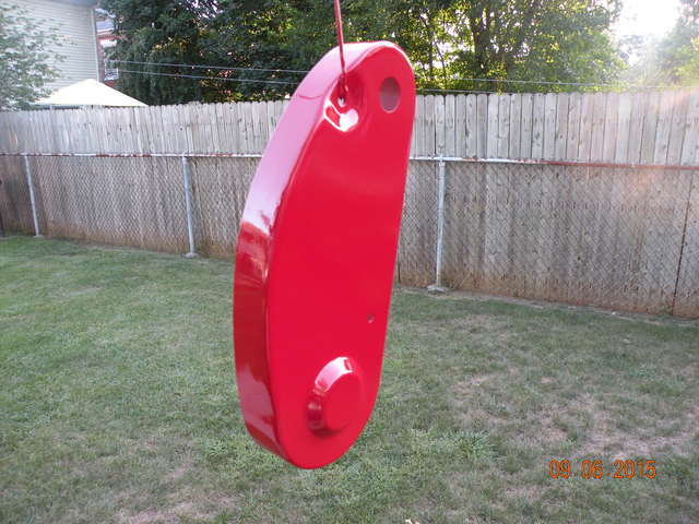

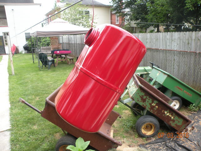

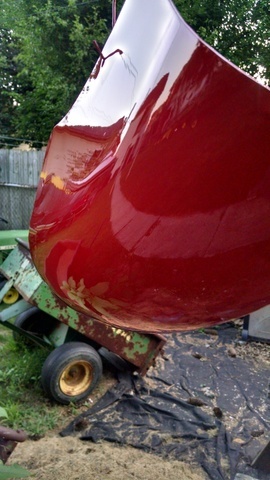

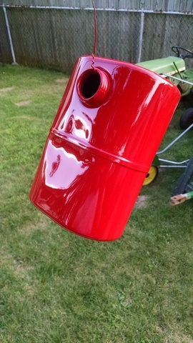

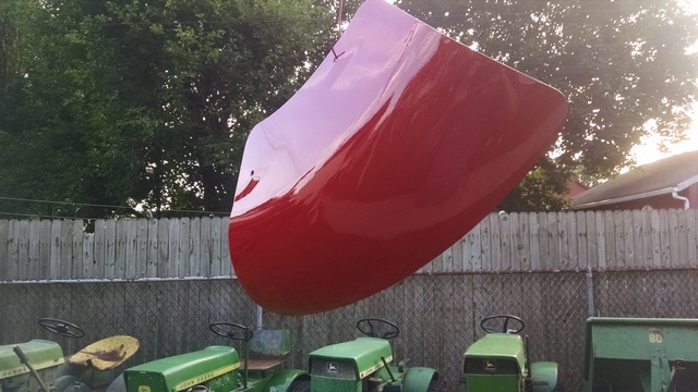

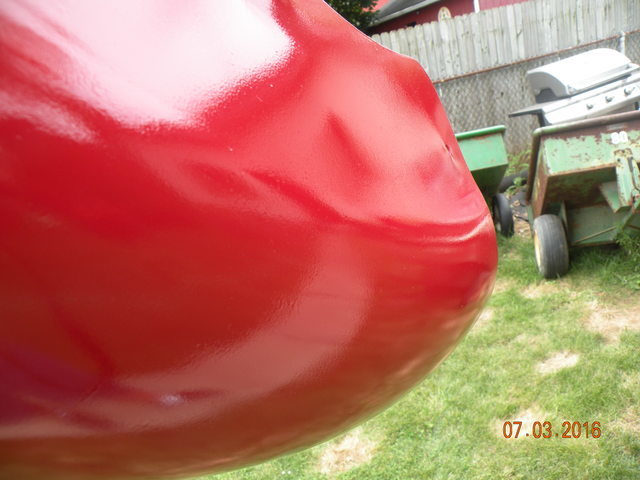

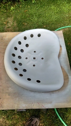

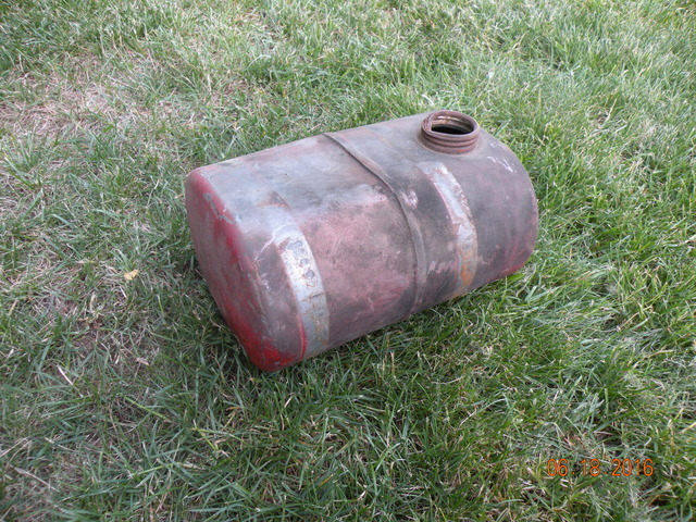

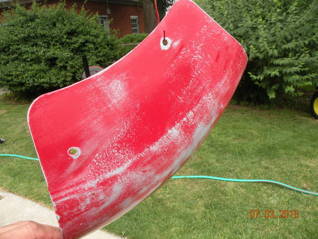

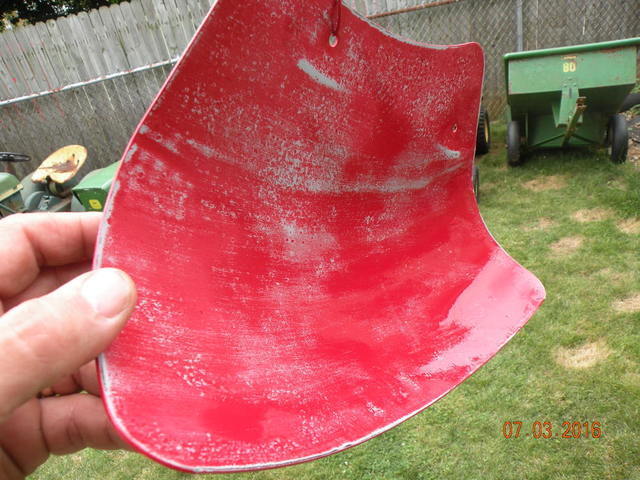

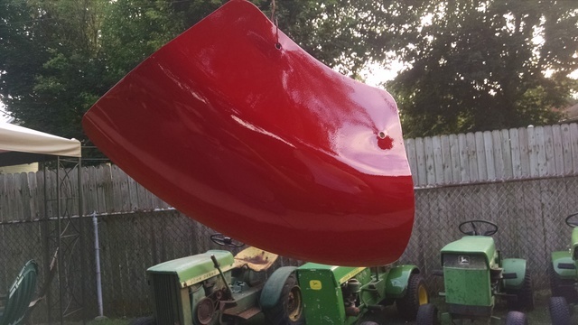

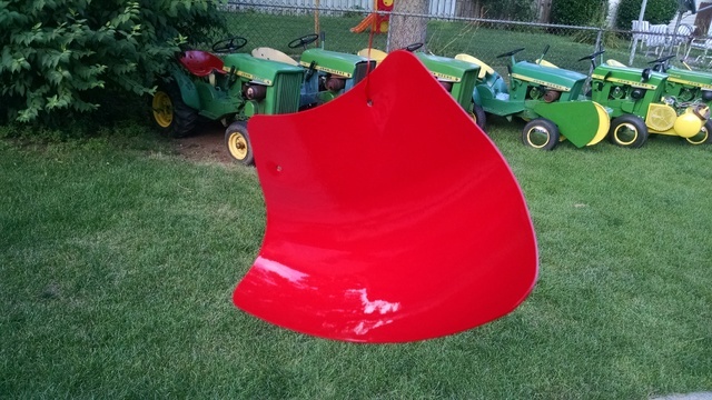

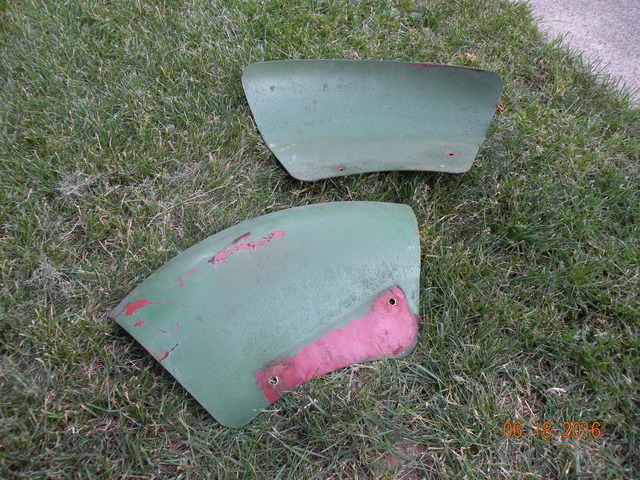

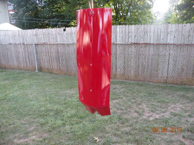

Next will be stripping the gas tank, the fenders, and the seat pan. After being stripped, they were coated with two coats of primer.

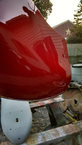

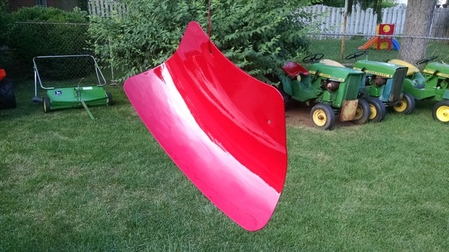

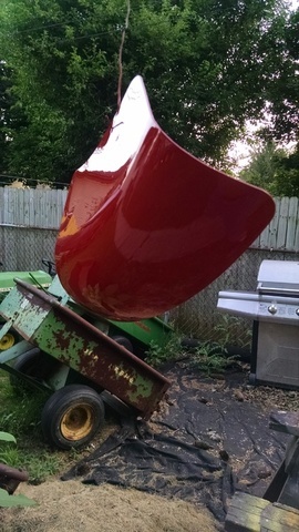

When the primer was cured, I started applying finish coats to the gas tank and fenders. Here is one fender and the gas tank after the first coat of finish:
Then wet sanded with 320 grit:
After a second coat of finish is applied:
And now after being wet sanded with 1500 grit sandpaper, and another coat of finish applied:

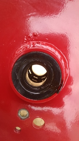

And the gas tank so far:

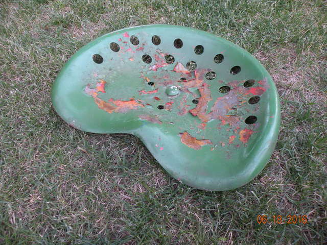

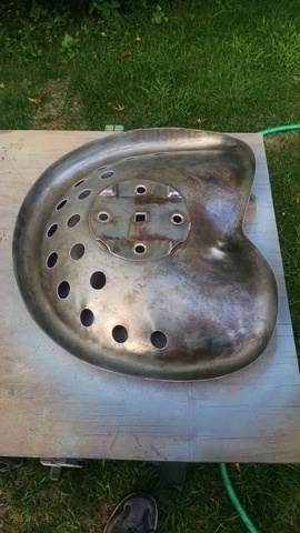

Oh, here is the seat pan after being stripped and primed:
  • Like 8

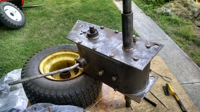

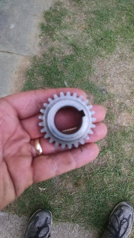

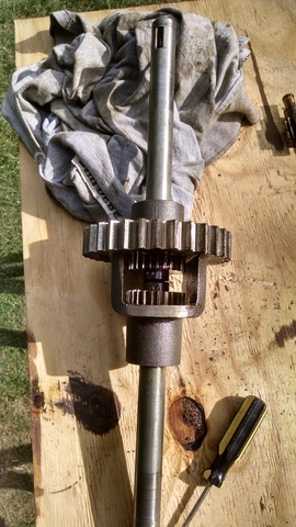

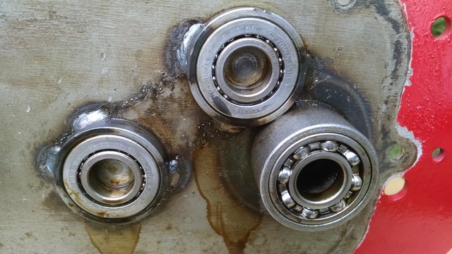

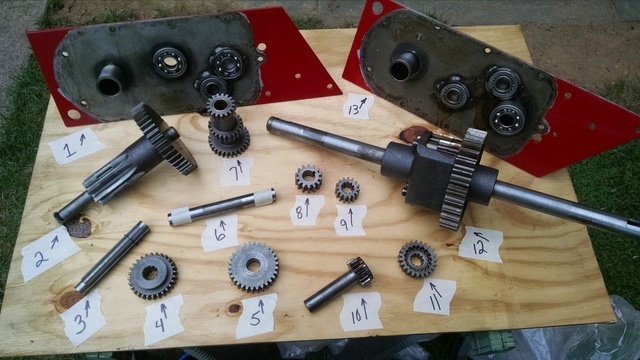

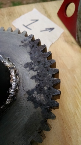

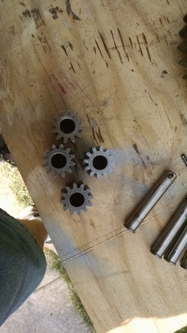

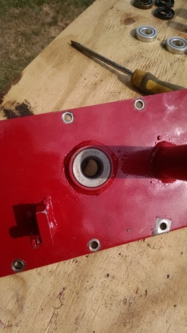

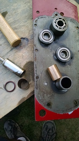

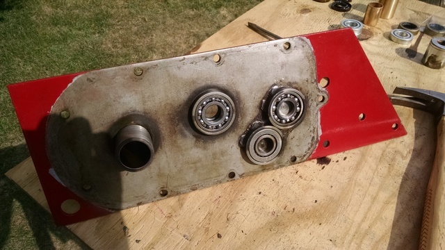

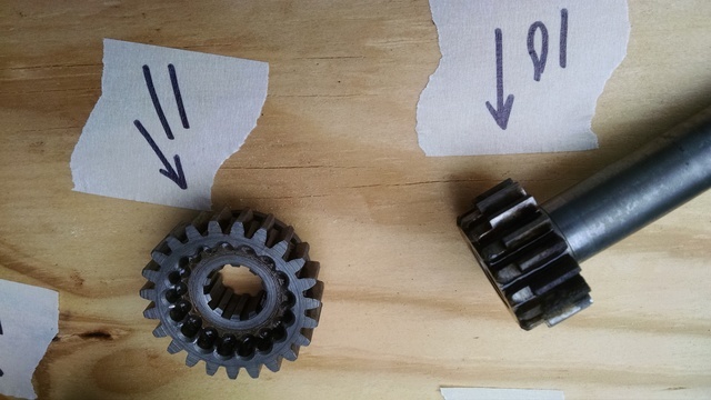

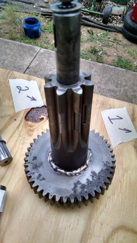

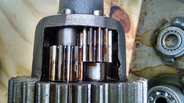

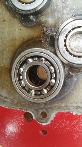

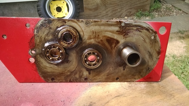

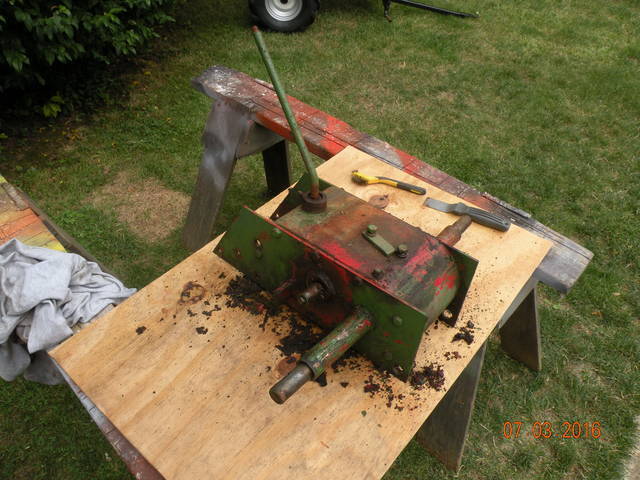

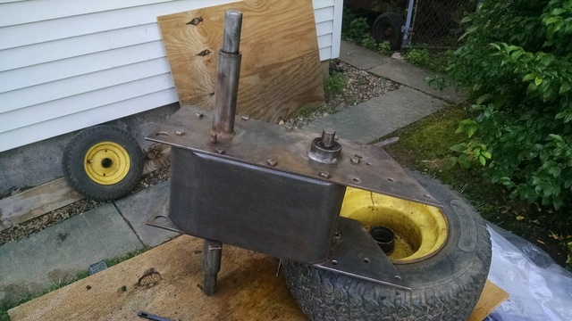

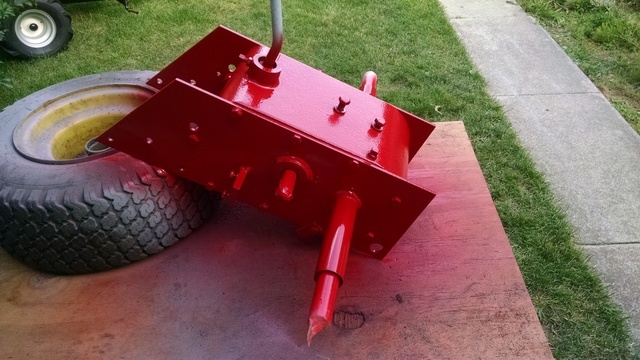

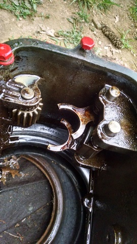

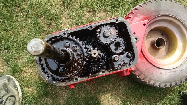

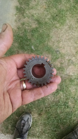

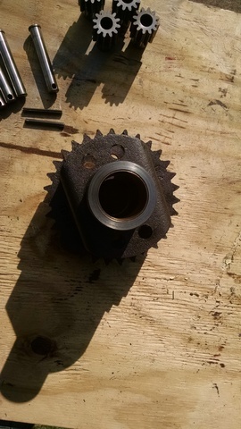

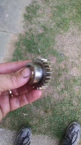

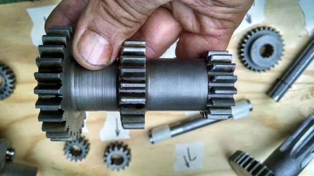

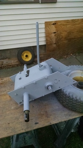

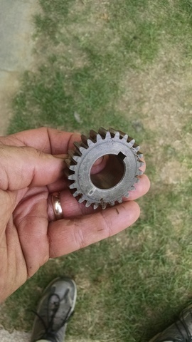

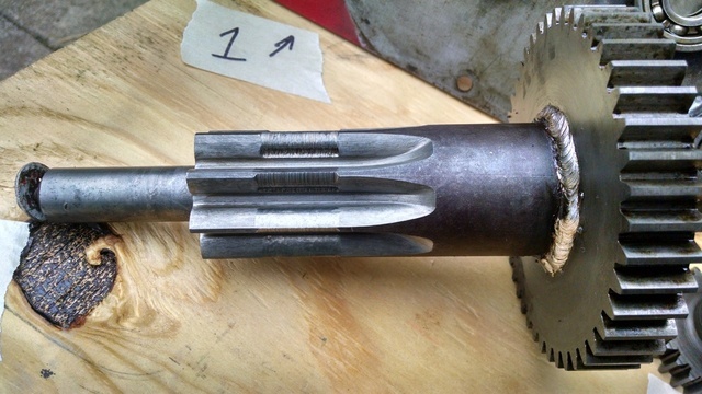

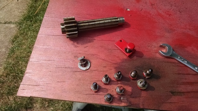

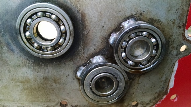

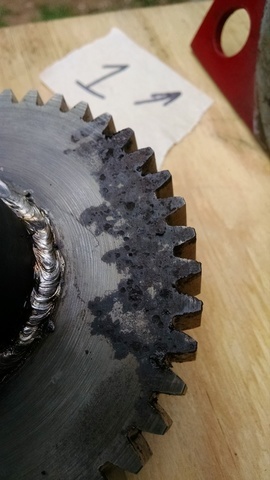

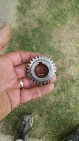

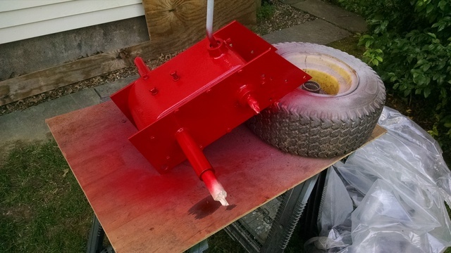

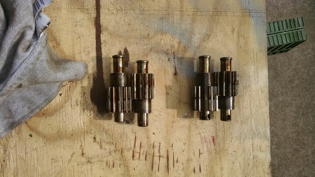

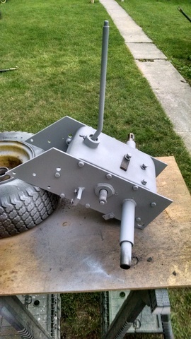

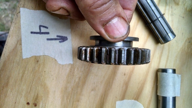

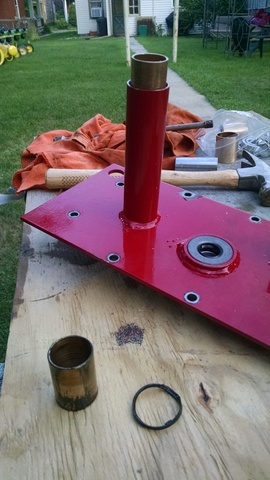

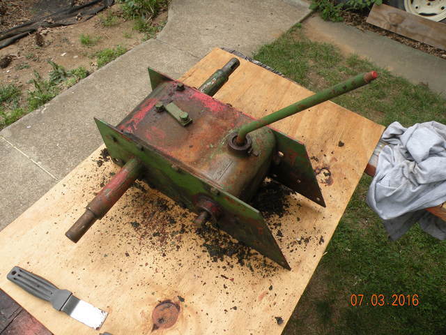

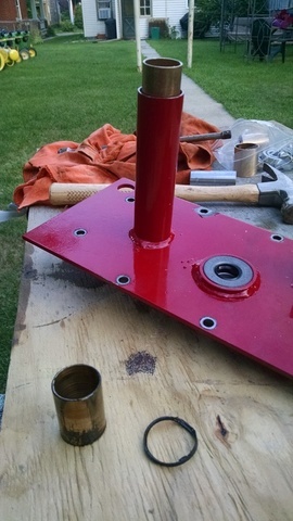

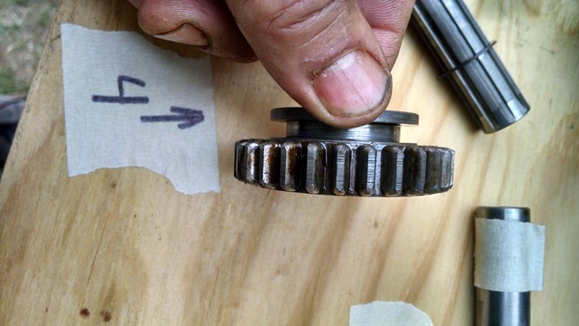

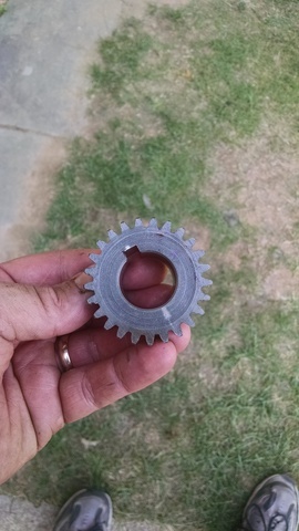

Started on the transmission, getting it stripped and primed. I wasn't going to take it apart so I started applying a finish coat. However, after applying the first finish coat, I figured a restoration to actual factory specs wouldn't be accurate if everything wasn't gone through 100%, so I decided to disassemble the tranny. After getting it torn apart and could finally see what the inside looked like, I was quite surprised to find that all of the internal gears look really good with hardly any wear whatsoever. I thought I'd find at least a couple of broken teeth somewhere, but nothing. Even though the bearings all look good and spin freely, they will be getting replaced as well as the bushings and seals. Should be an easy fix Thanks to my Friend Jake Kuhn for getting me all of the parts. :)
Started replacement of bearings, seals, and bushings:
  • Like 9
