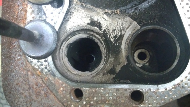

Just got done pulling the head.  pulled the valves.  Maybe you would call it a burnt valve.  it only has a couple of contact "shiny" spots. Looks like some carbon was keeping it stuck open.  The exhaust stem is also very loose in the guide compared to the intake. But probably gets more clearance anyway but still seems out of tolerance. Piston is marked STD. Although she got some miles on her, I can't do a bottom end right now.  can a guide be replaced on the tractor?

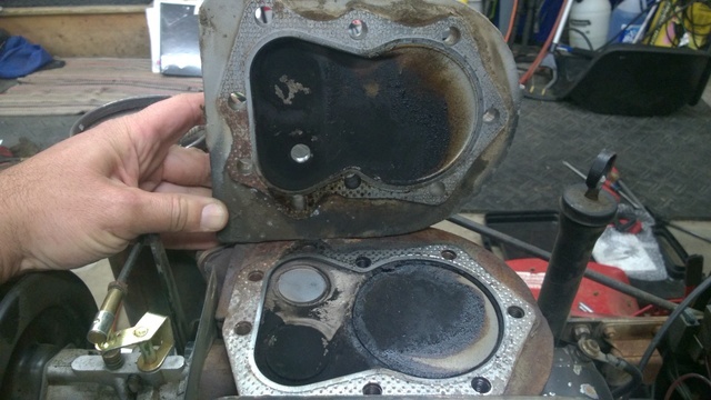

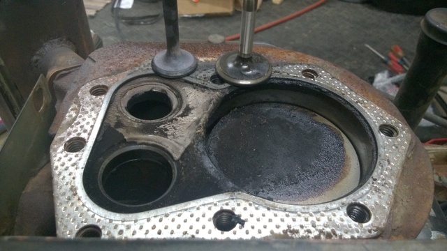

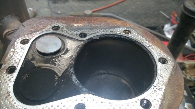

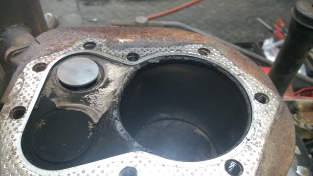

You can see the burnt carbon. I scraped. Of but didn't touch the seat.  What do you guys think?
Cylinder walls look good.  carbon was pretty thick
Looks like a new valve is in order.       :text-coolphotos:

Id say do a valve job while its apart.
WHX??
I'd say just clean it up and button it back up if this is your main worker but plan on a full go thru when you can. Valve job motor should be completely taken  down for other measurements and what not. When I do valve guides I do a little porting just because its cheap and it really brings out a few more ponys. Std pistons on an older motor might mean out of round so check that too.

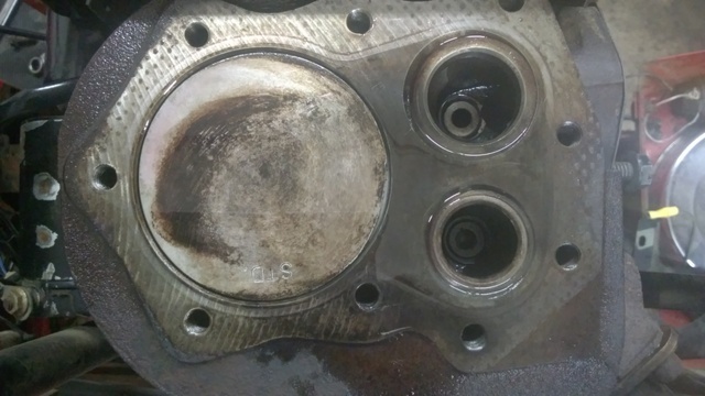

Anyone else see what I'm seeing?
oe espo
The piston is starting to melt in the last picture right at the exhaust.

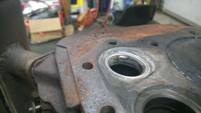

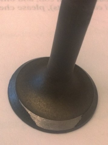

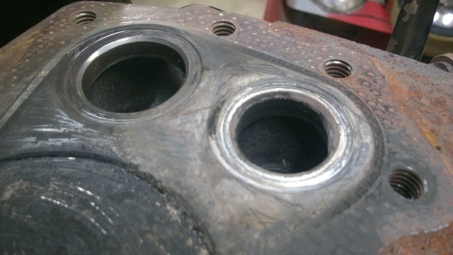

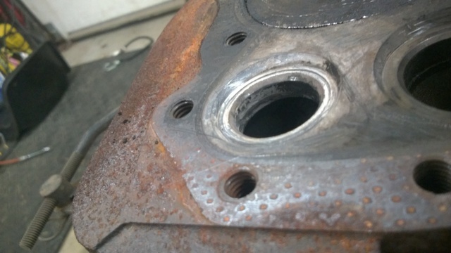

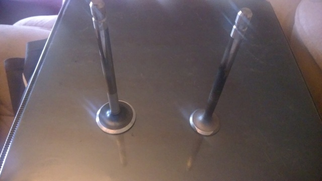

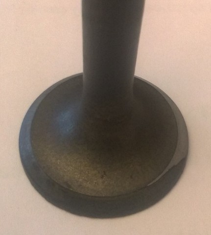

UPDATE:
Intake valve truer up nice.  You can see the exhaust warped.  guide is bad, or feels bad to me.  Ordered new exhaust valve and guide.
How hard to put the guide in??? Suggestions?  thanks

Can't say on what it takes to do the valve guides as I have a professional do mine. I don't have the tools required to do it. New valve would have to be seated in I would think.  Now that you mention it the piston does look a little scorched near the exhaust but I would say that is fairly normal for a well worked horse. Any Idea how many hours are on this motor?
oe espo
1986 Tracor, so 30 years of service :handgestures-thumbupright:.  Non-working hour meter shows 1,488 hours.  The intake vs. exhuast clearance between guide and stem is way tigher than exhuast.  Not sure if that is normal or previous owner had it replaced?
