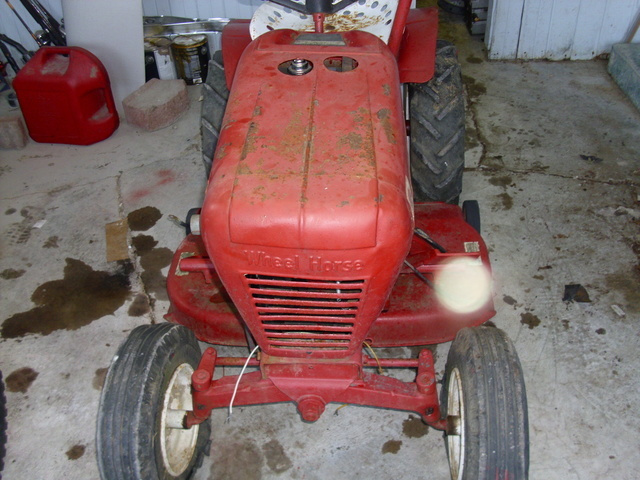

Racer5x 14 #1 Posted June 26, 2016 Saw this on craigslist for $100. Offered the guy $50 and he said come get it. Need help identifying the model number and year. 3 Share this post Link to post Share on other sites
19richie66 16,936 #2 Posted June 26, 2016 (edited) Looks ALMOST just like my '64 lawn ranger. Whatever it is it's well worth $50 Edited June 27, 2016 by 19richie66 Added "ALMOST" Share this post Link to post Share on other sites

Molon_Labe 731 #5 Posted June 26, 2016 Looks like a 654 to me. Share this post Link to post Share on other sites
squonk 38,902 #6 Posted June 26, 2016 I'm going to say 604/704 1 Share this post Link to post Share on other sites

KC9KAS 4,741 #8 Posted June 26, 2016 Depends on the "original" engine....654, 604, 704....But I think it is a 1964! A Lawn Ranger would have smaller wheels, but look very similar. 1 Share this post Link to post Share on other sites

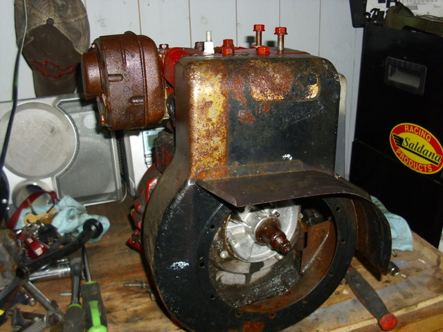

Racer5x 14 #14 Posted June 27, 2016 According to the guy a bought it off of this motor in the picture attached to this post is the one he took off of it when he first go it. He said he took it off because it needed a carb and he couldn't find one. Is this another briggs? Share this post Link to post Share on other sites

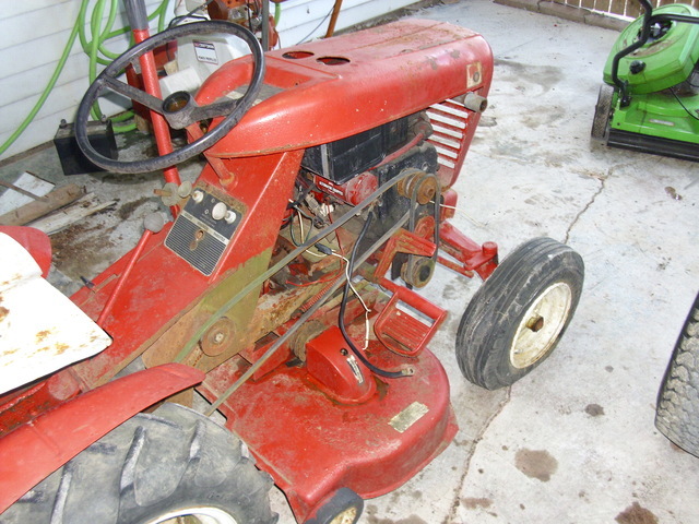

gregg'shorses 77 #15 Posted June 27, 2016 OSHA is going to love that drive belt. I still have the scar on the side of my calf from our old 702. 2 Share this post Link to post Share on other sites

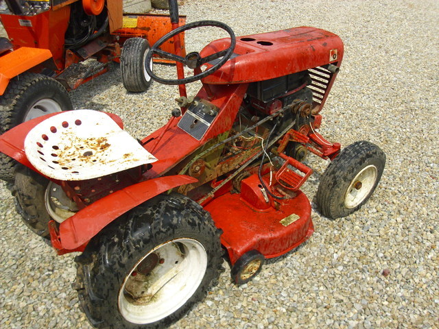

Molon_Labe 731 #16 Posted June 27, 2016 604, 654 and 704 all used the thumb screw attached hood. Only the 654 had a battery box like yours. The engine should be a 6hp Tecumseh H60. 3 Share this post Link to post Share on other sites
Racer5x 14 #17 Posted June 27, 2016 57 minutes ago, Molon_Labe said: 604, 654 and 704 all used the thumb screw attached hood. Only the 654 had a battery box like yours. The engine should be a 6hp Tecumseh H60. Thank you sir! Must be a 654! Thanks to everyone for the replies and help it is much appreciated! Corey 1 Share this post Link to post Share on other sites

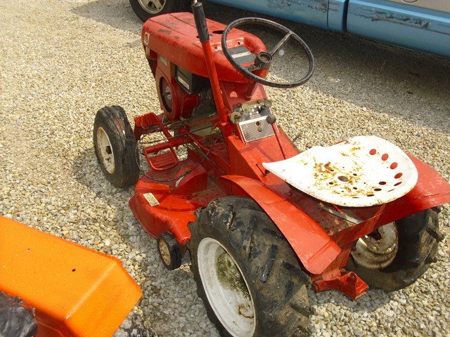

wallfish 15,918 #18 Posted June 27, 2016 I'm with Molon_Labe--- a 654. Lawn Rangers used the same hood but the tractor itself is much different. Has a battery tray for electric start. I;m not sure if the linkage bends around the tray area like that to avoid it on the non-electric start models like 604-704 That Briggs is not the original engine. The gas tank should be on the stand and the cap uses the other hole. The second hole was cut into the hood. A 654 would've had a square seat and not the seat that's on there. I can post some comparison pics tomorrow of my 654. 3 Share this post Link to post Share on other sites
