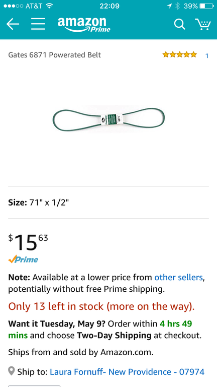

The original Wheel Horse number is 9783.
It's a 1/2" x 71" belt.
I use a Gates PowerRated belt which is 6871.

4 minutes ago, ztnoo said:
That's what I assumed you meant, but needed clarification to answer your question.
I used a Gates PowerRated belt which is 6871.
Awesome! Thank you guys👌🏻😎

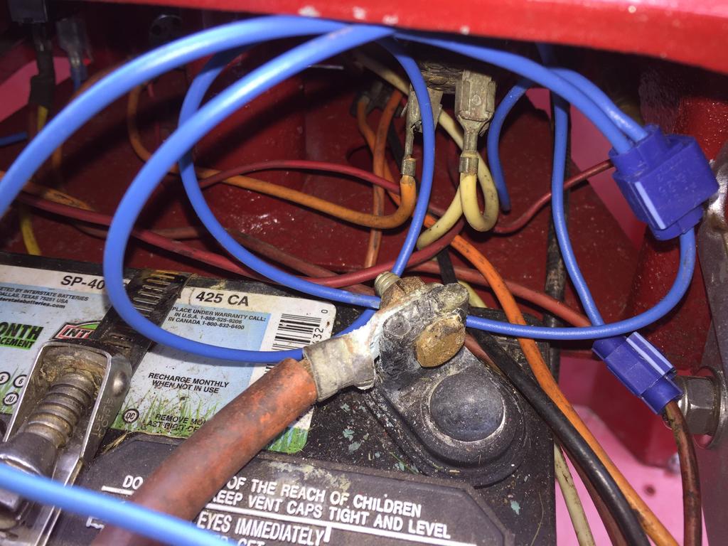

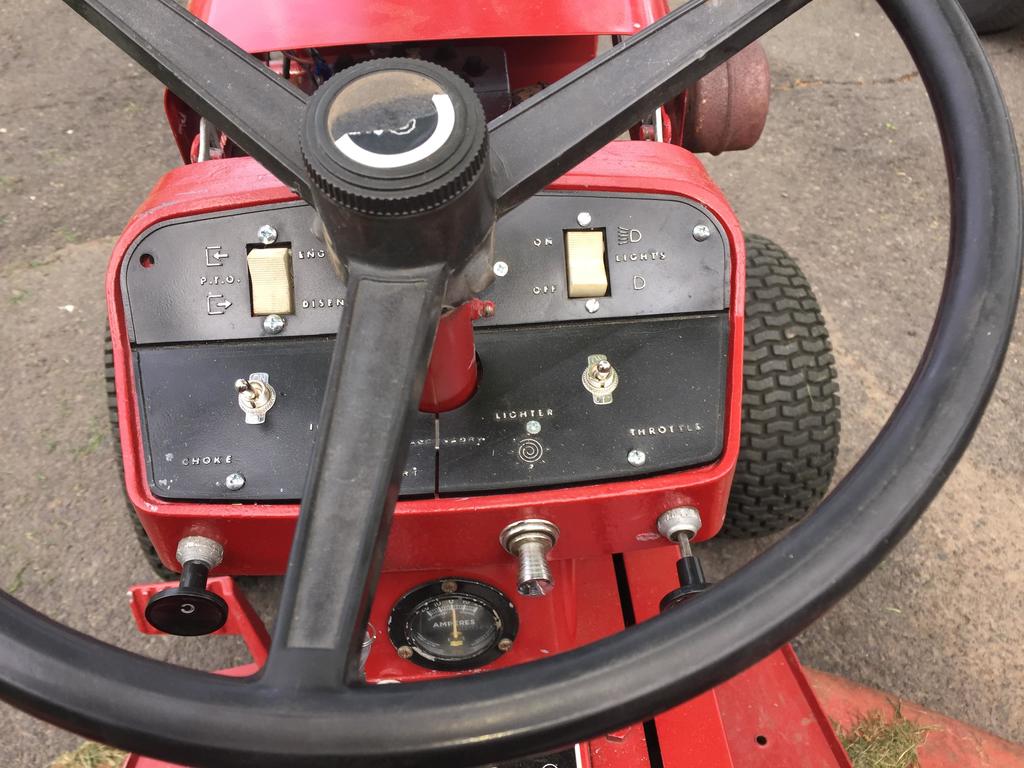

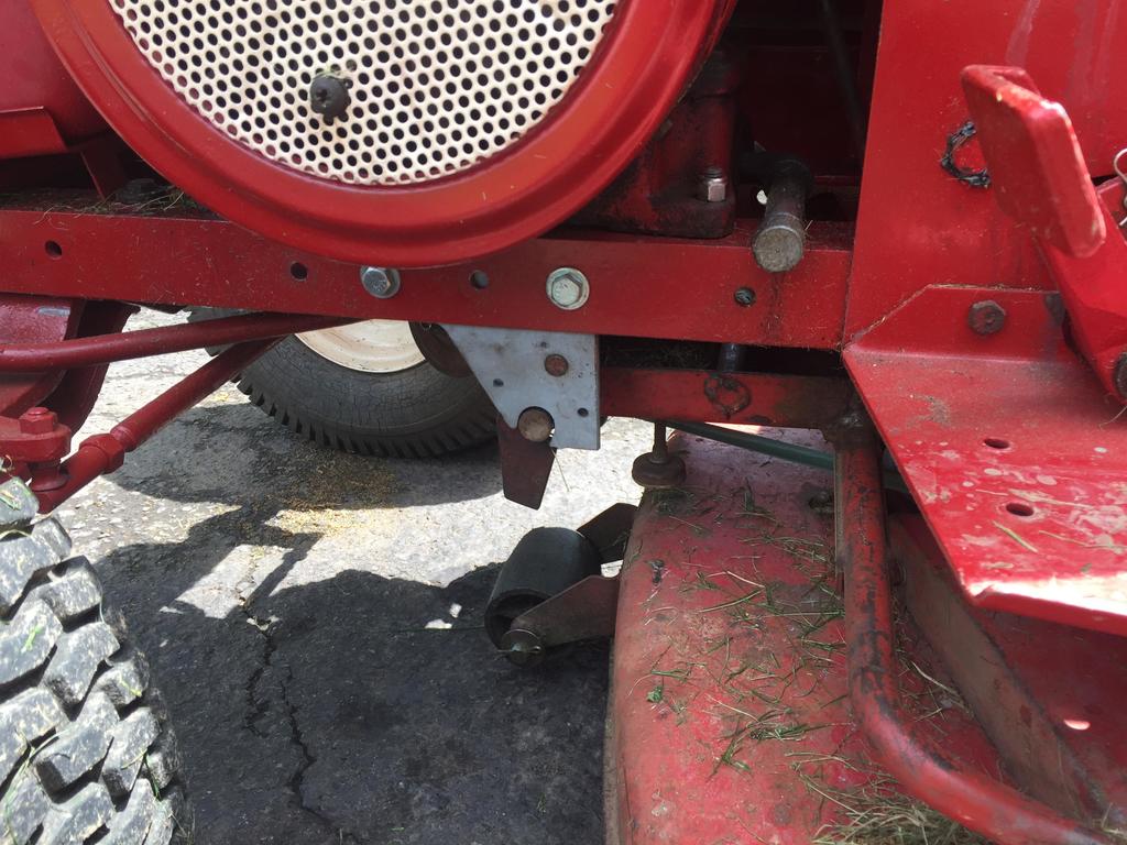

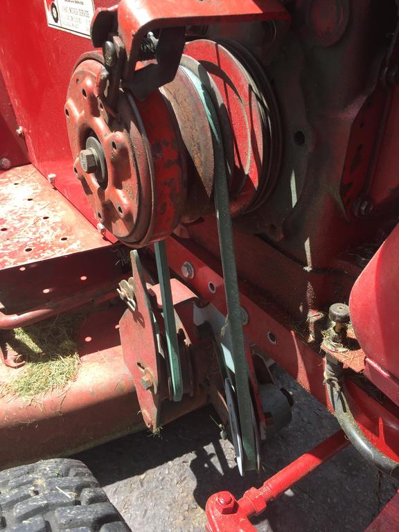

Hey all.... I just wanted to follow up with you all. I installed the "very proud" ignition and it started fine. However, the electric PTO and the lights were not working. I spent an hour trying to figure it out and gave up. From what I can tell, I think the power leaving the ammeter is compromised. So instead of messing with it too much I just bought a couple single pole toggle switches and wired them up. Now I have a toggle switch for the electric PTO and the lights. Everything is back to working. I also installed the new mower deck drive belt as suggested. I had to relocate the adjustable pully wheel to get the proper tension on the belt. All and all it functioned great. I have another deck which has a couple rust holes in it. I'm going to strip it for back up parts. Any way here are some pics and a vid....

As to your electrical quirks, you might try giving the battery posts and cables a good cleaning  to ensure excellent mechanical contact. That positive post and cable look to be corroded somewhat.
I found once that my electric clutch wouldn't function with low voltage, which was ultimately caused by cracked and broken spades on the rectifier and the battery not sufficiently charging........just saying keeping those posts and cable clean can really help eliminate lots of quirky electrical problems.

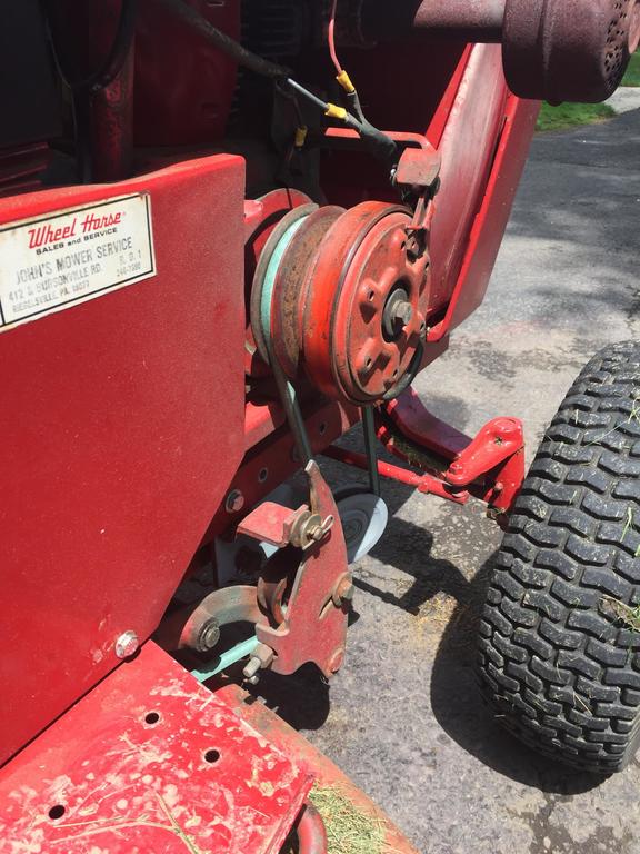

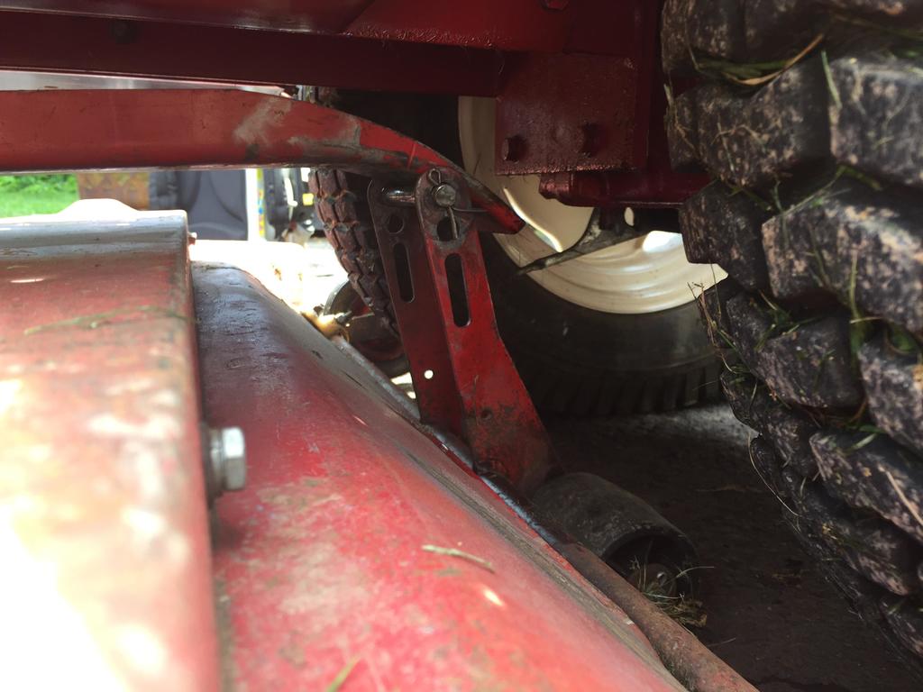

Hey there ZTNOO....Thanks for the tips... I didn't notice any zerks in the area you mentioned. I did remove the eclip and lube up the shaft pretty well. I'm figuring this will be a yearly maintenance thing. Off the old deck I salvaged 3 decent blades, two spindles, and 3 pulleys. Unfortunately the middle pulley was welded to the spindle shaft. Not removable. I also salvaged the rear wheels and height adjusting mechanism.
For the bracket that attaches the mower deck someone welded washers to the outsides of the bracket. I ground them off and gave it a quick primer coat.
Here you can see some pics how I have it set up. If you notice anything out of whack let me know.

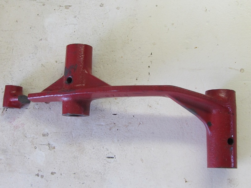

If your pivot arm has holes for drive in zerks, they are on the bottom of the part.
Maybe you haven't really looked at the bottom.
If you haven't looked, they may be there.......or maybe not.
See the attached pics from the pivot arm I busted about 3-4 weeks ago.
