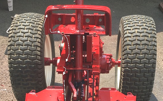

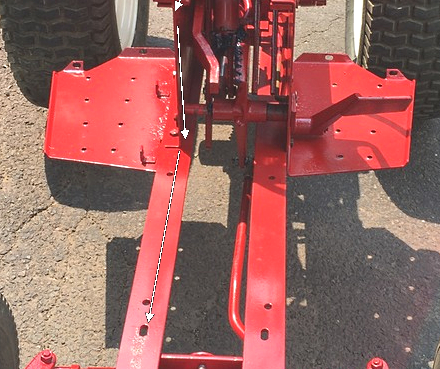

On 8/29/2016 at 6:16 PM, BigRedGrizzly said:
 I'm lost. I painted everything so I wonder if I insulated a ground somewhere. Could it be that the engine sitting on the newly painted frame? I don't think so.
This is the pathway current would need to follow to get from the hood support to the engine and then the starter.
paint over any one of the connections between the body panels and you lose ground to your block
