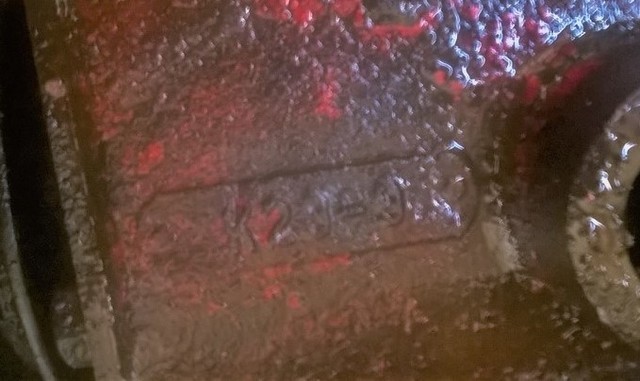

well some previous identification led us to this possibly being a early 400 suburban due to the hood and its lack of pluged hole for the 550.
but as I cleaned her up I found this number on the cast....coincidence or does it mean what it says??
not sure my brain is confusing me...
one manual sais they used tranny 5010 my tranny doesn't say that...
they made 400 401 502 and 550 but I don't find any tractors that are a 501??
Not that this is definitive...
but, this is the trans number will help you narrow down when your trans was made.
Am I seeing a dash nine here?   :scratchead:
psalms83:18
yes k28-9
Yep...
so your trans was manufactured in '59 then.
psalms83:18
:o:D. Awesome thanks...so it most likely is a very early model...
but does that other number 3 501 mean this is a 501?? There issnt any tractor manuals for a 501?
Where did you get the idea...  :dunno:
these casting numbers correspond with the model of your :wh:
psalms83:18
that was a thought??
wallfish
That is just a casting number of that particular part by the company that actually cast it. The total assembled transmission is Wheel Horse part #5010.
The other number K28-9 is the date.
K= Oct (no letter I, because it could be confused with number 1)
28 = Oct 28
-9 = 1959
That tractor is a 400
stevasaurus
The 3501 is the WH # for the casting.  If you order a casting for the 5003 or 5010 transmission, it is part # 3501.  :)

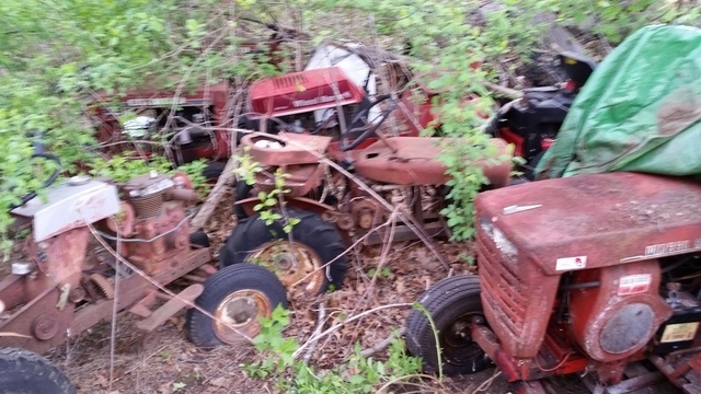

This was where it sat for a while.
wallfish
Looks like you picked a "Diamond in the rough"
You should've grabbed those foot rests on that front left tractor or even the whole thing, especially if the hood was there. I see the engine belt cover too. It's a 1961 701.
psalms83:18
we almost grabbed the front left and front (foreground) right...but he wanted 100$ for the left one and we decided for just the rear end with a shifter rotted completely through we didn't want to pay that. And the right one though had value for its price we left for someone else (catch and release) we didn't want to buy it just for its parts we didn't realm want that year model. I believe it's still there in mass.

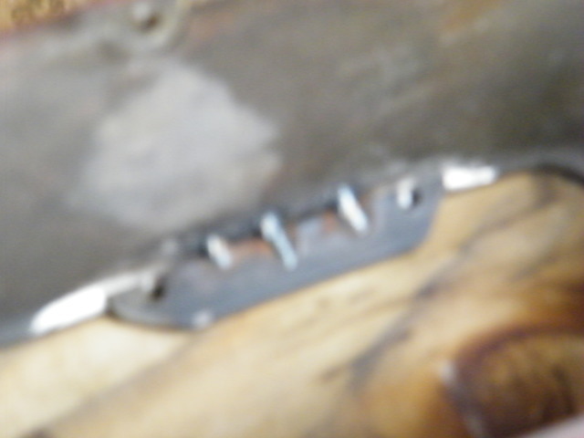

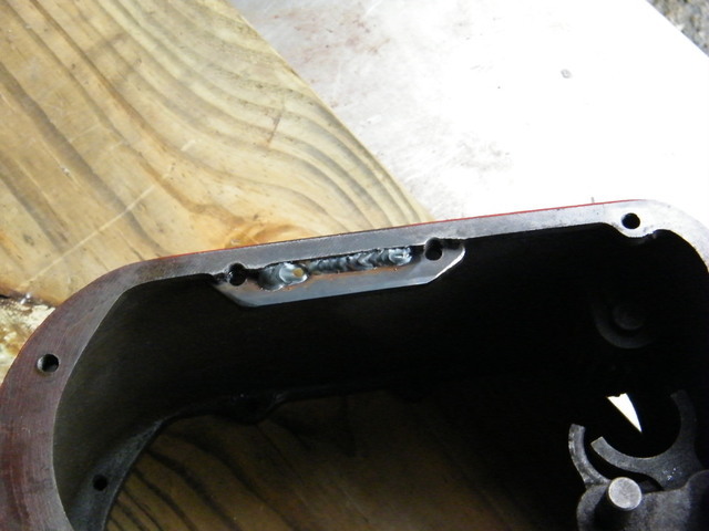

Looking at the pictures of the inside of your transmission, I don't see anything wrong.  It should clean up just fine.  Soak all gears and bearings in diesel, then use a wire brush and scraper to clean.  I don't see any rust, but a wire wheel would take care of that.  :)  I see you have the newer style bolt on bull gear and separate differential housing.  :handgestures-thumbupright:  Those bolt holes can be fixed.  Do you have the pieces that broke off??  They can be welded back on and strengthened...or fabricated if need be.  If I had to do this again, I would do it a little different, but this did work.  The welded plate needs to be flush with the gasket edge of the case.  Welding the bottom plate and then one on top, drill and tap.  I used 3/4" x 1/4" bar purchased from TSC.
Racinbob
That looks great Steve. I do see the issue why you'd do it different the next time. Maybe building it up with some JB shaping, re-tapping and a good thread sealant would do the trick. You wouldn't have to worry about stressing the JB, just giving the gasket the opportunity to seal. Your fix is going to take all the stress you can throw at it. :)
