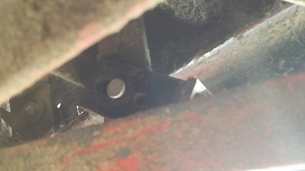

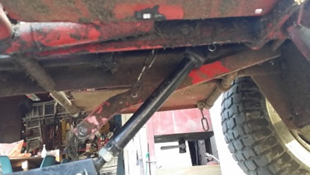

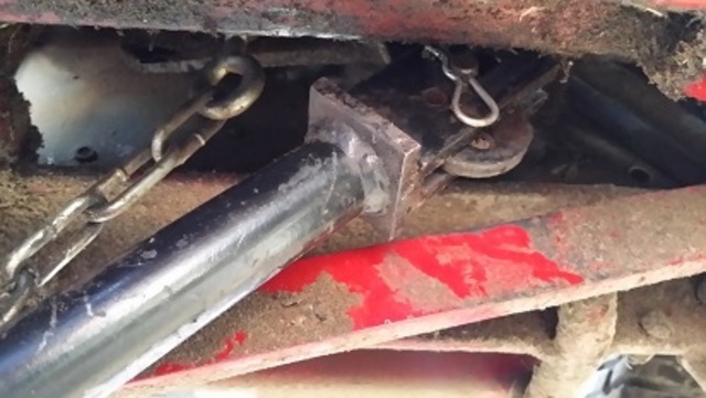

I just got the lift hooked up and it seems to work right.
20160306_161800.jpg.6a62112be1df945e5e25
Here is how I hooked it up.
20160306_161941.jpg.973e3dc45827855df9a820160306_162122.jpg.70401df74771f4034a6420160306_162034.jpg.a961570e2bd4ac0a573c
So it does not involve the lift rod? And did you remove the lift chain? Also it seems I'm misssing the part to attach the lift assist springs to the blower.

This is how I attached the lift assist springs. I fabricated the upper attachment point with a large bolt and mounted it in the front attachamatic where the mule drive goes check out this thread:
It uses the same lift lever as the mower deck uses. The lift chain is still used.

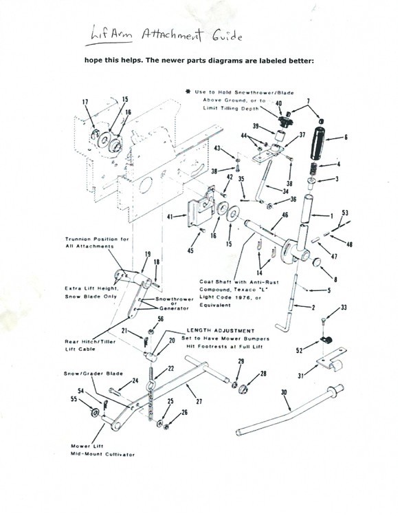

:text-imsorry:The lift chain is not needed but does not need to be removed. I just looked at the pictures again. :blink:Here is a diagram of attaching implements to the lift arm:

So there should be a second connection point. Hmmm I'll have to look at that again. So should my little 312 have enough hp to power the two stage blower?
