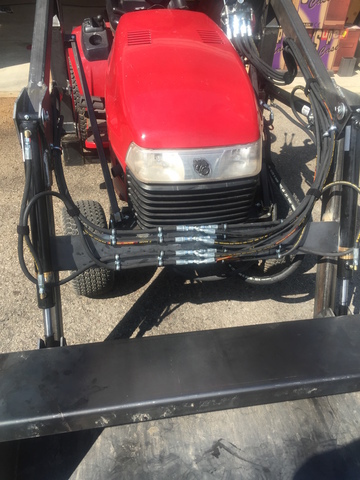

Welded in the front cross brace, mounted the hoses to it, and straightened them up a bit. Much cleaner looking.

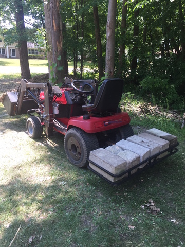

The weight box is removable, I caught the HF cargo carrier that Andy used on sale so cheap I couldn't build anything for less, but once the weight box is on it won't fit in my garage any more. I'll have to figure out what to do about that, I don't want to have to put it outside. I guess for now, I'll have to load the box every time, or park it in the tent, I can always put my brother in law's piece of crap Deere outside. :)
  • Like 3
Seems to operate a bit smoother with 300 pounds of block, plus wheel weights, plus my 240 pounds. :)

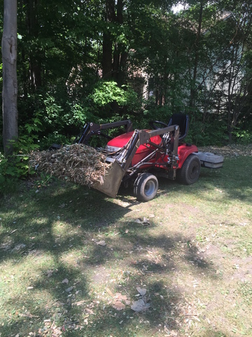

It made short work of that pile of shredded tree branches. Can't exactly call it mulch, as nasty as it is. :)

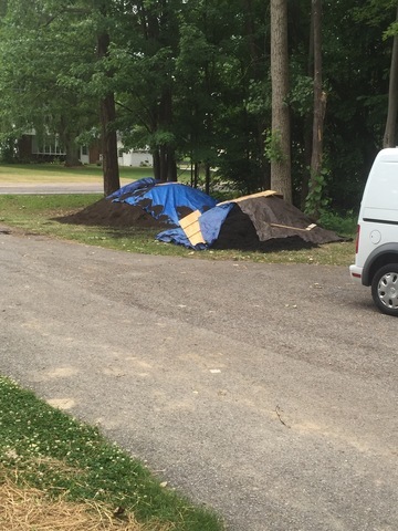

Topsoil (12 yards) and real mulch (6 yards) coming Tuesday.
I'll be giving the loader a workout

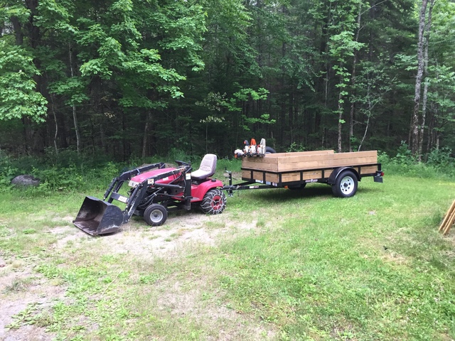

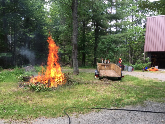

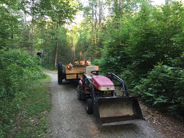

Job well done! My relief valve was a screamer as well. I had to hack saw the tamper proof cap off. It's a differ t machine toady! I found some photo of her performing some work around the place.
image.jpegIt's brush cleanup time upstate. Just threw the saws up there to get my wife asking questions. It worked! A 5 X 10 trailer makes for a much better yard cart. The hitch was built by Scotty Moreaus friend Tom.
Edited by Forest Road
  • Like 4

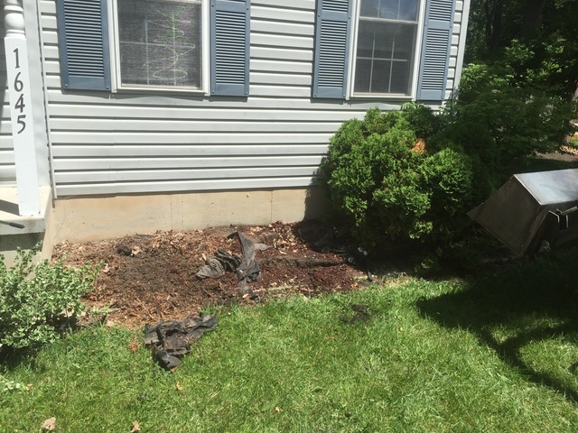

That is 12 yards of topsoil, and 6 yards of mulch to move.  I started yesterday afternoon, but I barely put a dent in the piles. :)
There were two of those bushes when I started, now they are both gone.
The he dirt is like concrete, I was standing  on the shovel, but could only get it in about a half inch. I tried lifting them out with the bucket, which just resulted in lifting the rear of the tractor and straightening the hooks on a cargo strap.
Finally put put it in reverse, hi range, and floored it. Popped it right out. I was left with about 3 inches of roots. My wife wanted to try to save them, but I doubt they will survive.
