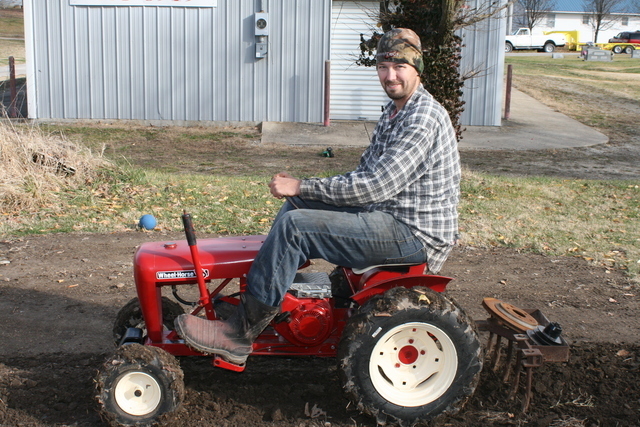

This 520 will never mow again, it will truly be a garden tractor.  Someone will end up with a nice mule drive and 42"RD deck though.
So I guess I'm on the hunt for some 8.5" wide wheels!  I need to start gathering some implements and order a Clevis hitch from Lowell.
