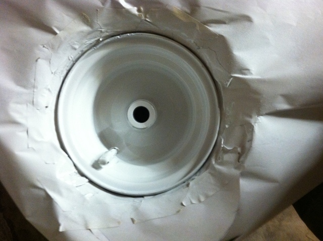

IMG_0098.thumb.JPG.3c33f6575556412195161IMG_0084.thumb.JPG.2c2194b3f7a8ede416072
the front wheel that i painted

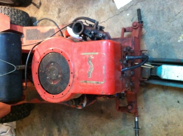

      I have a non-Wheel Horse tractor (Craftsman 14 HP Briggs OVH) , but the part appears to be common to the Briggs & Stratton Engine rather than a Craftsman part.  (See the photo -  The connector and pins I need are circled in blue)
      I also have a 1977 Wheel Horse A-100 that needs a tail light lens & bulb.  (A complete tail light assy would be fine!)    Anyone got any idea what the Peterson part number is for the tail light for the model I have?
