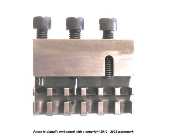

you will need links,i buy all types to have on hand,that way what ever way the chain ends you can join it,you will also need either a chain breaker or a grinder and punches,at least a good file and punches to drive the pin out to attach new link
I bought this type of chain breaker last year for my snowthrower on a popular auction site. It is sold for use on Go-Karts and Mini-Bikes. Solidly built, and it is steady to use.

Hey John,  I like that chain breaker!  I bought a more elaborate one for $14, works OK, but I was looking for something simpler, kind of like my bicycle chain breaker but more robust.  BTW, the bicycle chain breaker cost $29-but cyclists are willing to pay more usually :-)
  • Like 1
