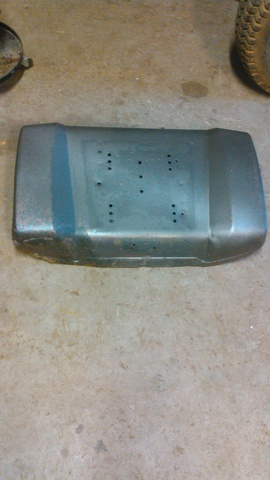

WNYPCRepair 1,875 #41 Posted January 16, 2016 On November 26, 2015 at 9:56 AM, grine_22 said: Here is the rear panel, need to do some work on the pitting then I'll get primer on it till spring. Why does it look blue? Is that from the e-bath, or was it painted blue before? Share this post Link to post Share on other sites
grine_22 145 #42 Posted January 16, 2016 7 minutes ago, WNYPCRepair said: Why does it look blue? Is that from the e-bath, or was it painted blue before? I don't know why it looked blue, I had my cousin run it through his burn off oven and then sandblast it for me. Could be from the oven. 1 Share this post Link to post Share on other sites
WNYPCRepair 1,875 #43 Posted January 16, 2016 22 minutes ago, grine_22 said: I don't know why it looked blue, I had my cousin run it through his burn off oven and then sandblast it for me. Could be from the oven. Ah, OK, I thought you had it in an e-bath. The burn off probably turned it blue from the heat Share this post Link to post Share on other sites

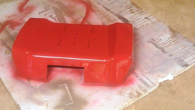

grine_22 145 #45 Posted January 27, 2016 I've been getting paint on, only thing to work on for now is getting the hood finished. 4 Share this post Link to post Share on other sites

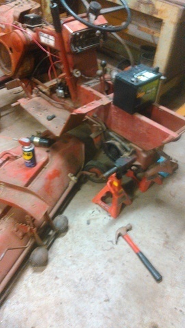

grine_22 145 #46 Posted January 28, 2016 In the meantime I'm fixing other things as well, one axle seal was shot, the seal behind the brake band needs replaced, deck has a few small holes in need of patching. 1 Share this post Link to post Share on other sites

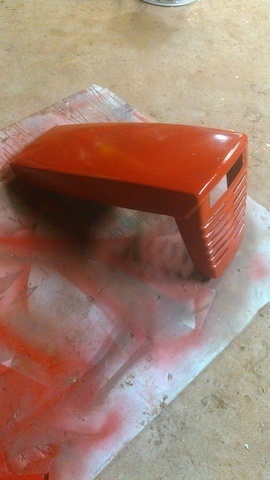

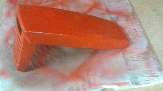

grine_22 145 #47 Posted February 1, 2016 First coat on the hood is done, need to hit it with a fine grit paper and give it another coat. 2 Share this post Link to post Share on other sites

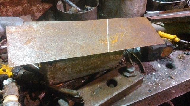

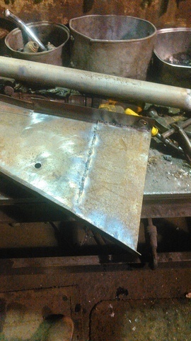

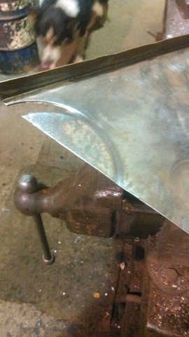

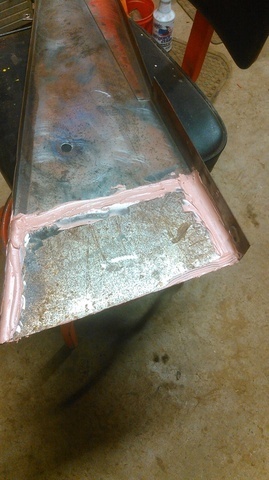

grine_22 145 #48 Posted February 14, 2016 The belt cover for trans has worn thin so I cut a piece of sheet and tacked it in. Welds aren't the greatest, I'll grind em down and work on it more when I get time. 1 Share this post Link to post Share on other sites

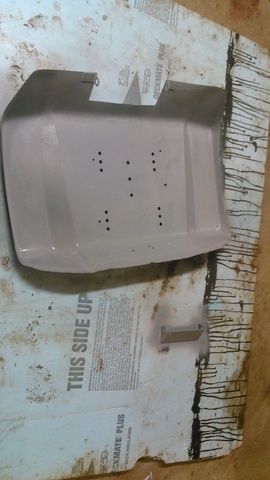

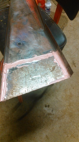

grine_22 145 #50 Posted February 17, 2016 Cleaned up the welds with the grinder and figured I'd try my hand at body filler. First time using the stuff, I put it on a lil thick but with time comes experience. Anyone with experience be free to point out mistakes, always up for learning tips and tricks to doing these kinds of things! Share this post Link to post Share on other sites
