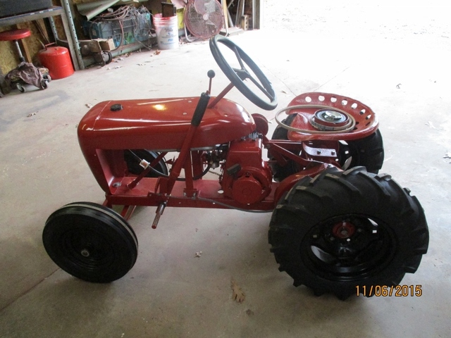

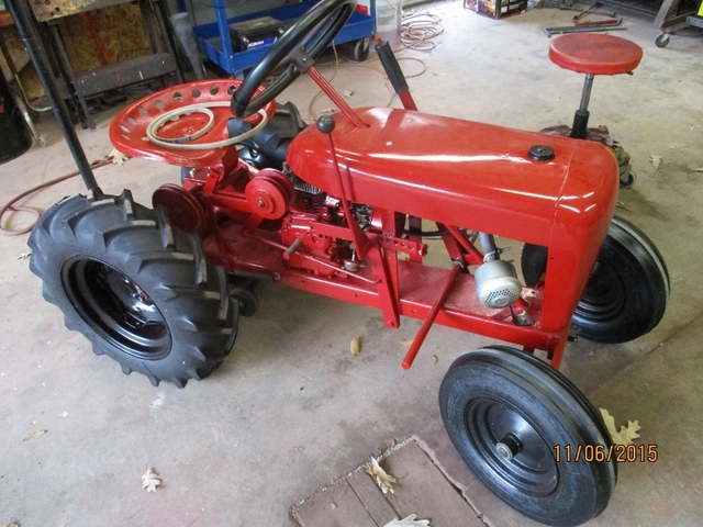

Today I thought I would try to get the Tecumseh HS50 in the RJ35 to run.
IMG_0078_(800x600).thumb.jpg.fd5bb8a9429

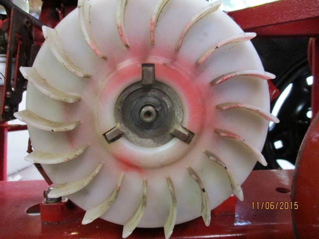

It ran before I installed it but nothing since.  I about janked my arm off trying to get it to run last evening.  Well, what could be the problem ....  it's got fuel (starting fluid too),  It's got compression,  and I see spark.     Fuel and compression for sure ... lets go for a spark failure.
IMG_0079_(800x600).thumb.jpg.9abd6a8437b
IMG_0080_(800x600).thumb.jpg.30db77d2b5b

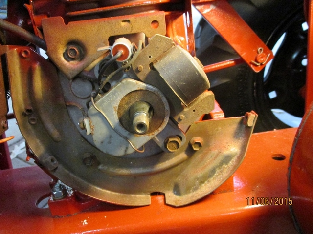

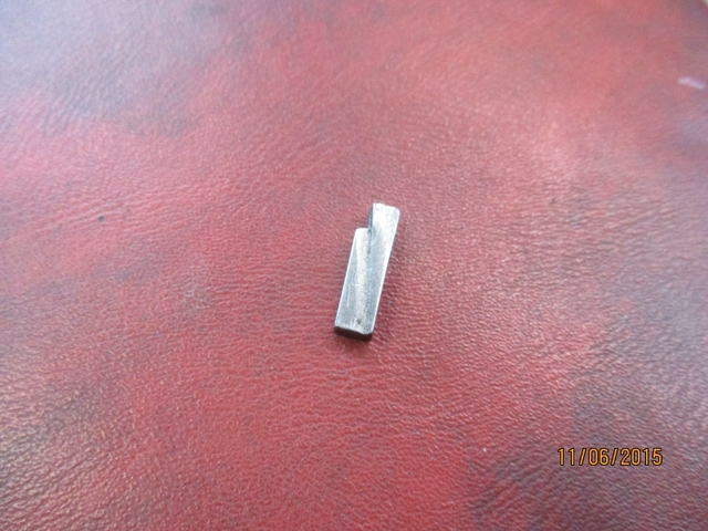

First thought was "flywheel key".  Flywheel almost just fell off.  I put a screwdriver behind it and did not even have to put any pressure on it and the flywheel was off.  Yep.... this is the problem ... a loose flywheel and sheered key.  NOPE ... key not sheered, just a little offset.
IMG_0085_(800x600).thumb.jpg.84d5f277b29
Now to the points ... cover not on correct.

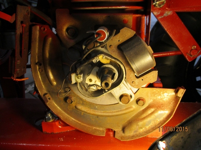

IMG_0081_(800x600).thumb.jpg.28aff37f287
Point connector block not properly installed.  So I fixed that problem and cleaned and gapped the points.
IMG_0082_(800x600).thumb.jpg.ebc8abb087f
 Put it back together with a new flywheel key.  Rotated the flywheel by hand and there was good spark at the plug.   With it all back together a few pulls had it running.  So it was something with the points but nothing too obvious.

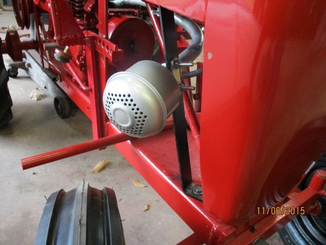

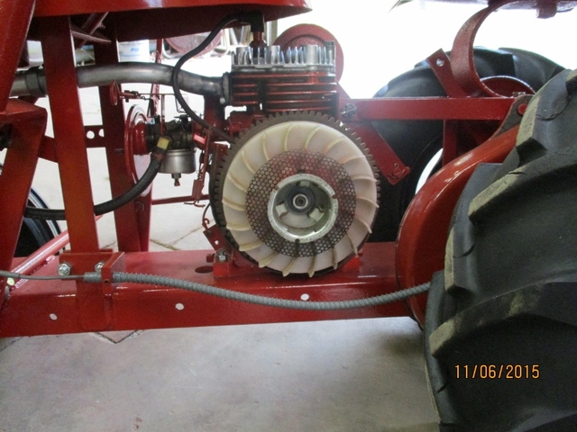

Now that it runs I installed a muffler support.  Exhaust is made from ¾" electrical conduit.

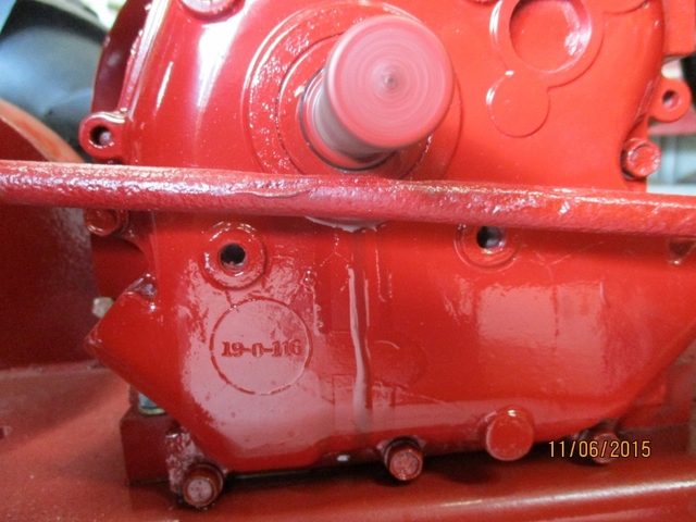

Now another small problem .... oil leaving the crank seal.   Easy fix ...I hope!

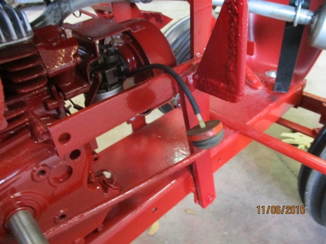

And..... do I need this primer bulb?   The carb has a choke and I'm not running it in the winter.   I was going to just cap off the nipple.
The motor is from a snowblower.
