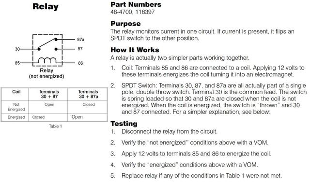

I tapped on the relay and it started to crank while turning the key. I think that relay may be bad. Can I jump that to determine for sure if that's the issue?
Sent from my iPhone using Tapatalk
Remove the relay so you can get a good look at the terminals for corrosion and/or overheating. This is how they usually fail. This is how you check the condition of the relay
Do you understand it and can you do it?
Garry
