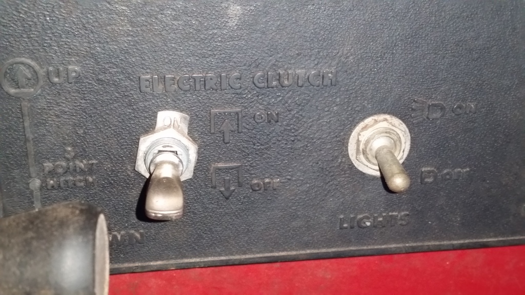

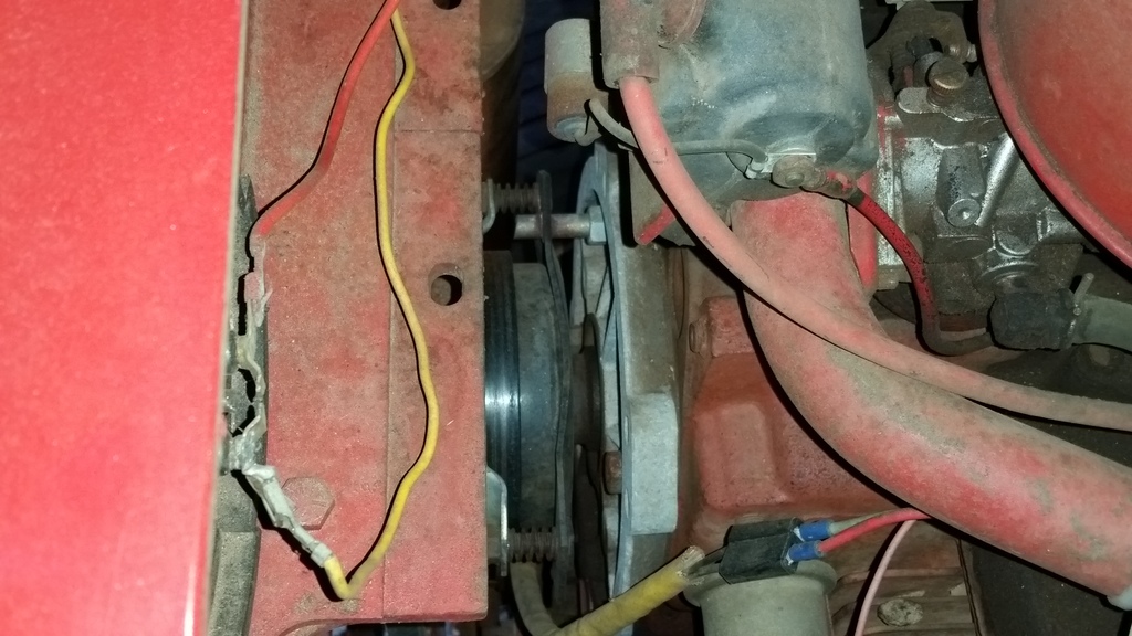

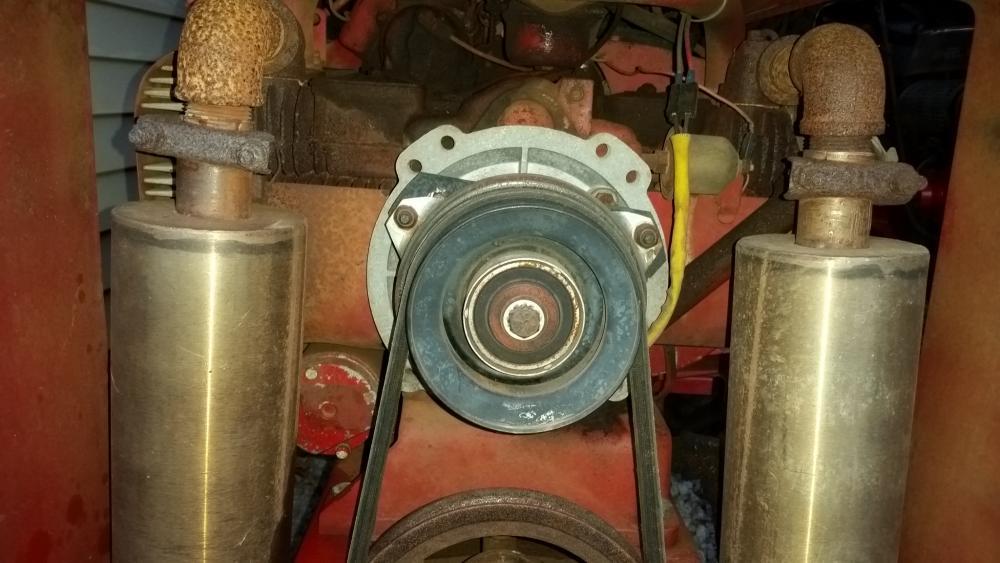

I do not know for sure the exact model electric clutch that I purchased as it has been several years ago now. I do know that I had purchased it from an aftermarket company called Rotary. Currently the best match that i can find in their catalog is a part# 9913 (warner 5215-62) but please do your own research. It looks a lot like mine by the specs. I do not have the mower deck mule drive belt installed in the pics but you can see the belt for the rear pto. You can see the anchor pin (just a bolt with the head cut off) I installed at the top left where an existing bolt is already located. Lined up perfectly. The electrical is simple. Just a 12 volt supply with an in line fuse and a good ground. Just used a heavy duty toggle switch for power control and thanks to the D160's, there is already a provision for the switch on your control panel. As I mentioned before, I have been using this setup now for several years and it works great for me. Hope this helps.
