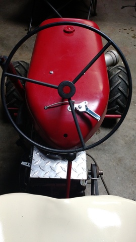

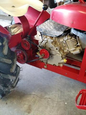

Brian01 481 #58 Posted September 29, 2015 Just thought I'd share this pic with my new throttle control on. 2 Share this post Link to post Share on other sites

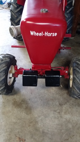

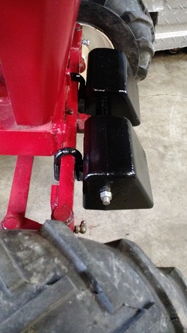

Brian01 481 #59 Posted October 9, 2015 Well I know it's not really the proper place for this but...got the lift cwblefrom slammer n put it on, and this morning I built some weights for the front, painted them and got them on... 1 Share this post Link to post Share on other sites

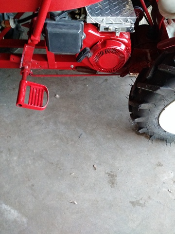

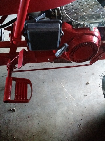

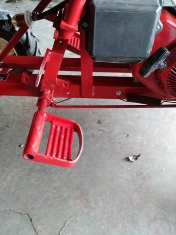

Brian01 481 #60 Posted November 13, 2015 OK I know kinda old thread but I need a little advise...I made a brake rod out of a piece of all thread..it works fine but my pedal is way back. How can I make it be like straight up? Different spring? Longer brake rod? I know the suburban 400 is supposed to be like 20 7/8" long..the one I built is like 18 or so. Share this post Link to post Share on other sites

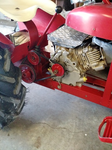

Racinbob 10,256 #61 Posted November 13, 2015 (edited) The clutch arm looks to be pulled a bit farther than it should be. Mine doesn't go quite that far without a belt and the idler arm against the real belt guard bolt. Is the idler assembly all good? The spring won't change things. As far as the rod length, a longer one would compound the problem. The issue there is the clutch pedal. It's not right. Here's a picture of mine and the difference is obvious. Oh geez! I forgot we are dealing with an RJ/Suburban hybrid here. That clutch pedal is for the RJ setup. I'm thinking the easiest fix is to find a Suburban pedal or modify that one for the proper geometry. Edited November 13, 2015 by Racinbob Share this post Link to post Share on other sites
Brian01 481 #62 Posted November 13, 2015 Yes I weldeda tab at the bottom of pedal, as shown in your pic there, that's how I have it connected, so that shouldn't matter either Share this post Link to post Share on other sites
Racinbob 10,256 #63 Posted November 13, 2015 No, not at all as long as it works. It's just that you'll have a longer pedal throw to engage/disengage the clutch. You can see the angle in the vertical part of the pedal making the rod connection further forward. There lies the issue in the rod length. Share this post Link to post Share on other sites
Brian01 481 #64 Posted November 13, 2015 So I need a longer brake rod? Correct? I think I tried that though, and the pedl broke all the way over before clutch would enguge Share this post Link to post Share on other sites
Racinbob 10,256 #65 Posted November 13, 2015 (edited) No, not with that pedal. A longer one will only make the pedal fall further back and cause the problem you mentioned. A shorter one will bring it forward some. But, a shorter one will also mean the pedal will have to be pushed further forward to disengage. You could make another one and use a threaded trunnion so it will be adjustable. You could weld a longer tab on the bottom making the rod connection farther away from the pivot point effectively making the pedal throw shorter. Basically, the geometry is wrong with the hybrid setup but it can be overcome. Edited November 13, 2015 by Racinbob 2 Share this post Link to post Share on other sites
Brian01 481 #66 Posted November 13, 2015 OK I fixed it, somewhat. Moved the rod up one hole on the brake arm. And put the spring in the first hole, where the rod "was"... 1 Share this post Link to post Share on other sites
Racinbob 10,256 #67 Posted November 13, 2015 Interesting. Those extra holes are aftermarket. But if it works there's no harm done. 1 Share this post Link to post Share on other sites
Brian01 481 #68 Posted November 13, 2015 (edited) Yeah it has kinda "soft " brakes that way, but may be able to adjust it out.But does work....looks a llittle better too!I actually need a brake rod, instead of all thread, because it "gives" whenever you hit the brake. Edited November 13, 2015 by Brian01 Share this post Link to post Share on other sites
