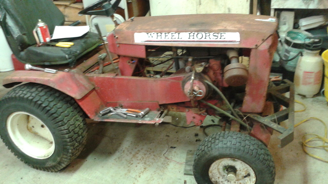

turns out to be 2 WH 's . one is a   1974  WHEEL HORSE  C160 MODEL 1-0480 9  with a looks like  48 or  50 inch deck and the engine
runs good so I removed the deck because it will fit on my 520h which has a 42 inch mulching deck . and the other is a  L 156 this is a small tractor. the C160 runs good (after I rewired it)20150813_205221.thumb.jpg.253f0c4c63391e,
 I took it for a ride in the yard but when I looked at it the left axle was coming
out about 6 inch's, so I tried to push it back in but it will not go all the way in . I want to fix it up but I don't know if it
is worth fixing or selling for parts.I NEED TO KNOW HOW TO FIX .HELP

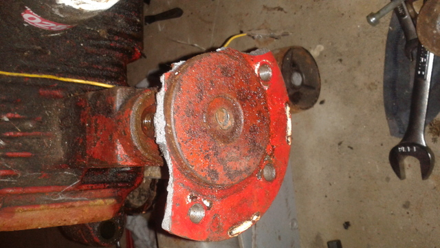

already started on C160 the left hub came off with very little trouble but right side hub broke see pic. I also reposted on
another post http://www.wheelhorseforum.com/topic/58591-c160-trans-troubles/
new to this so bare with me. now I need a hub for it .
and squonk if I decide to part out the l-156 you will be the first in line.
Edited by BOB ELLISON
Unfortunate that you broke the hub.  Now you need two.  One for replacement and one to make the puller.  I had a broken hub and posted on here and I had one in hand within a few days.  I have pictures of my puller if you need them.  The jaw pullers just don't work.  Isprayed mine with pb blaster, heated the hub with a torch and when it got warm I sprayed the axle with that dust spray for computer keyboards.  That stuff comes out really cold.  Be patient.  Check your axle size.  I believe it is 1&1/8".  5 lug.  Sorry you have to deal with this but am looking forward to learning from you.  Take lots of pictures
yes please send me photo of puller.will it work on broken hub ill make something to hold puller and ill heat it up with torch
I made mine from another hub.  Doubt it will work on what you have left. I think if you score the barrel shaped part where the set screws are (you could use a hand grinder with a metal cutting wheel) and score it parallel to the axle.  Maybe score it twice at 180°then use a hammer and a cold chisel in the score marks and it would probably break right down the score line.  To get cast iron bathtubs out of houses that's what they do.  Score it then hit it with a hammer.  It breaks and they haul the pieces out.
