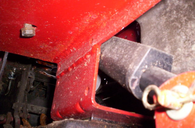

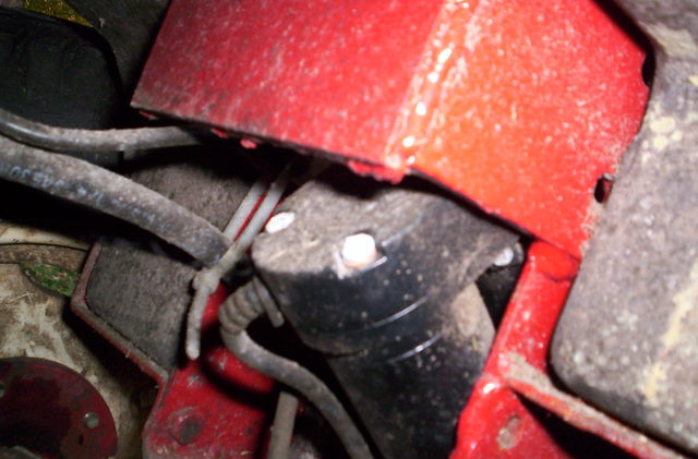

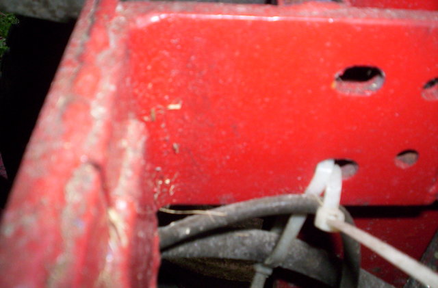

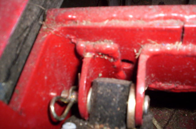

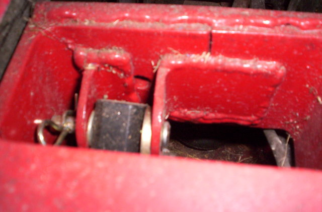

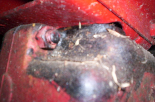

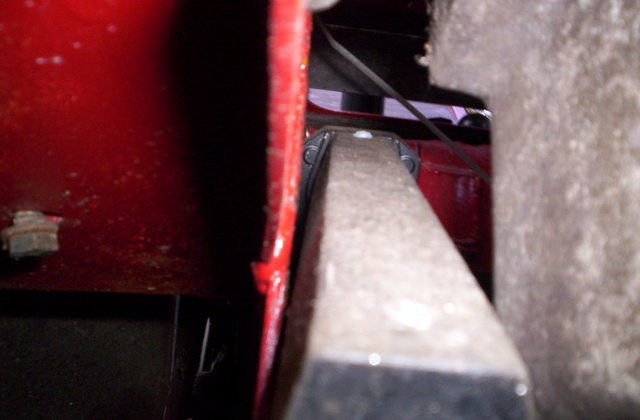

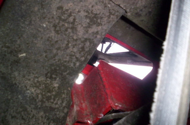

elcamino/wheelhorse 9,045 #56 Posted November 11, 2016 @T-Mo I took pictures today I hope they make sense. The actuator is attached inside the seat tower bracket. If I remember correctly I used a 6 inch actuator which actually measures close to 12 inches in length due to the motor and the holder for the actuator rod. A six inch actuator on a 300 or 400 series is too long. Since I don't know which tractor you are planning on working on , it is hard to give much advice . I took pictures from the hole in the seat pan , both sides of the rear tires and from behind. I hope this helps. 2 Share this post Link to post Share on other sites

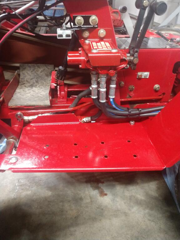

kpinnc 10,731 #69 Posted October 30, 2022 On 11/30/2016 at 5:13 PM, c-series don said: would really like to see that set up I added a D series spool valve and second cylinder on the Bronco. Works well, but it's ALOT of hoses to contend with. 3 1 1 Share this post Link to post Share on other sites
