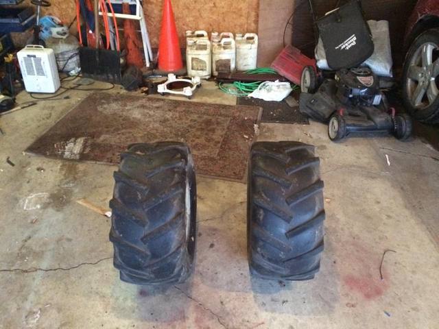

want to build my wheelie bars i will be running 26's how far back from the rear axles to the front of the wheels on the wheelie bars 5in fron the back of the tires
   It will depend on what size 26's your running and what size your wheely wheel is.  Not all 26's are true 26's some are smaller (China knock offs new Carlisle's) some larger (old style Carlisle's Old Firestones) or pro tires My Pit Bulls are actually 29's Vogel's are 27 when you measure them even though they are 26's.  You'll have to measure to get it right
they are the true carlisles
they tires not do not have the same rims in them they are the 12's but they are 11 3/4 12 rims
Does it say contact point in the rules ? If so measure to the center bolt hole from the tire back for minimum I run mine closer to 6 back so I don't lose as much hitch height when I wheely
Ours read minimum 5 back from tire and max 5 above ground
