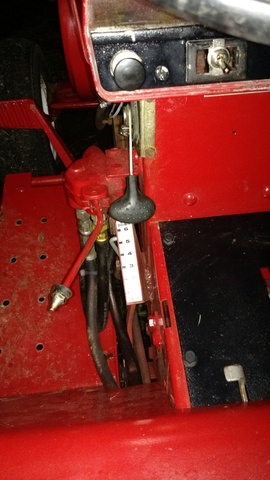

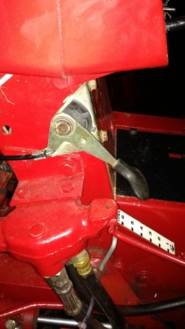

Brian01 481 #37 Posted July 2, 2015 I bought two of those switches on ebay a while back. Cole Hersee is the manufacturer of these Have not looked for them sinceI did my tractor tho.David Appreciate it...yeah I found some "rocker" switches surfin the web today...also just got back in from fixing that sucking back in throttle...I put a regular lever type throttle on it. Mounted it right above the hydrolic lever, kinda under the dash, on driverside...don't look to bad...sure works alot better. Share this post Link to post Share on other sites
Trouty56 565 #39 Posted July 2, 2015 I suppose this had the pull throttle...they are to be turned to tighten so they don't slip back in...mine was similar... I drilled the knob and shaft...put a small tension pin though it....filed it smooth...works OK now.... Share this post Link to post Share on other sites
Brian01 481 #40 Posted July 2, 2015 Yes it was the pull type throttle. I tried everything to get it to work right..never would...I had a couple of these type throttles laying round here. N though what the heck...works much better...still having what I "hope" is a belt issue...won't pull a hill....I backed down my driveway...went to come back up, bout halfway, it started "cutting out" to the point it almost killed it, and it was smoking the belt as well...think its just been stretched too many times. Share this post Link to post Share on other sites

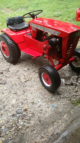

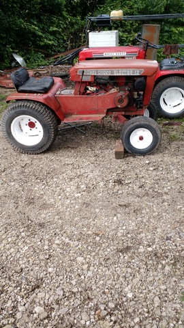

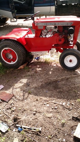

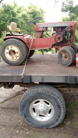

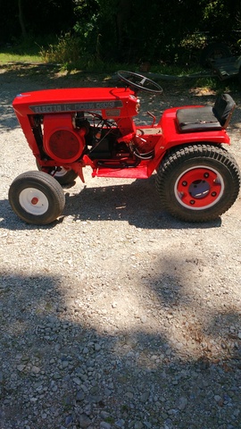

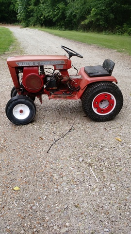

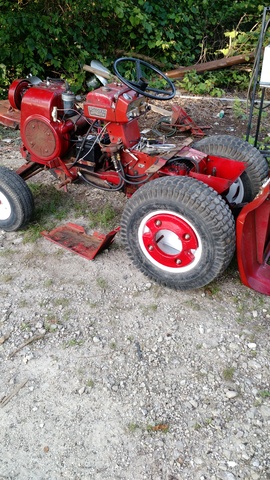

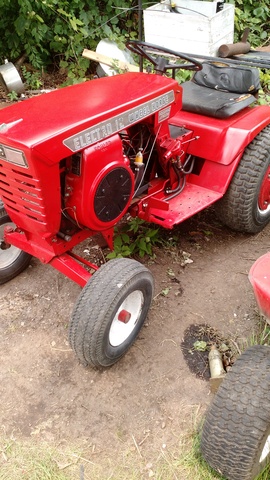

Brian01 481 #41 Posted July 8, 2015 Now that I'm a supporter, I'll try n post pics from start to present.... 1 Share this post Link to post Share on other sites
Brian01 481 #42 Posted July 10, 2015 OK let me try this again .... Hope this works.. 1 Share this post Link to post Share on other sites
