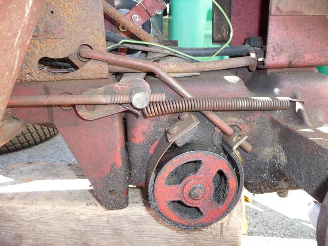

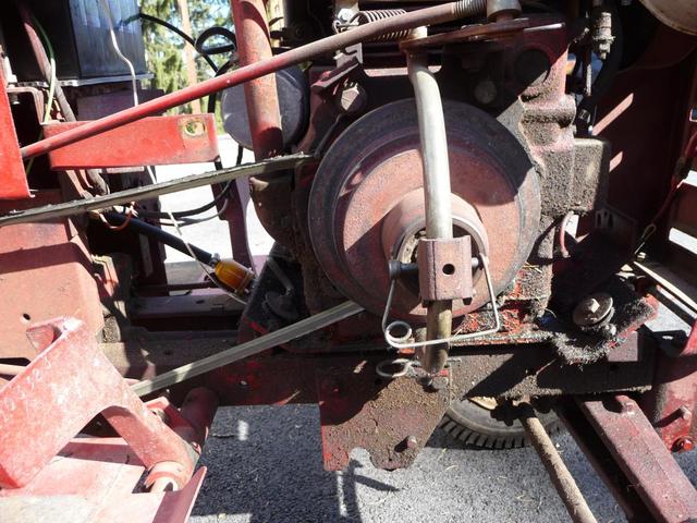

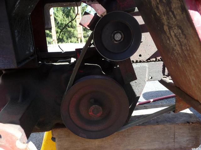

caddisman 3 #1 Posted April 12, 2015 I have a 8 speed 14HP Wheel Horse and can't get the drive belt tight. When the tractor peddle is released, the tractor moves really slow. I have a new belt and tried to install it but it has the same results as the old belt. Hopefully someone can look at the attached pictures and send me in the right direction. Thank you, Anthony Share this post Link to post Share on other sites
WH nut 553 #2 Posted April 12, 2015 The belts isn't suppose to be tight. With the clutch released it will be snug but not tight. What belt are you using, by the looks of the picture the belt is shot Share this post Link to post Share on other sites

gwest_ca-(File Mod) 10,444 #6 Posted April 12, 2015 7478 belt is for hydro transmission models and is 84.22 in. long. You need a 81.95 in. belt #7473 for the 8-speed trans. Garry Here is an original parts list Good service manual that covers many models and much applies to many years 1 Share this post Link to post Share on other sites
