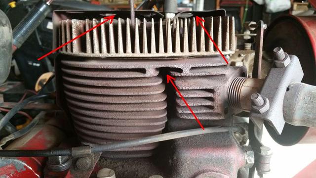

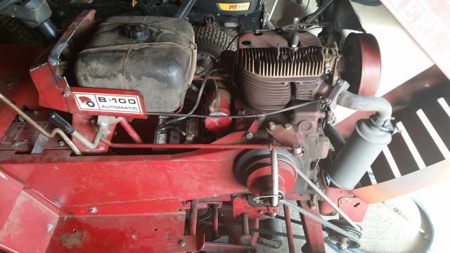

I have inherited a 74 B100 with 10hp K241S 46636d when my father passed away. I remembered this tractor new, so when asked, I wanted it.  It runs and mows, however, the engine slows and speeds up randomly.
I left it running and lifted the hood. 1st thing I noticed was a loose plug wire, fiddled with it and she spurred up to max rpm. But that only worked randomly as well.(will replace wire soon). 2nd and possibly most importantly I noticed a MASSIVE amount of air/exhaust coming out of the "FIN" area (see pic)post-14984-0-26867300-1428790959_thumb.j Forgive me but, is this normal? I mean it feels like a high powered fan. Any other thoughts on Idle speed random variations would be much appreciated.post-14984-0-50855100-1428791381_thumb.j

I am suspecting that this airflow is normal as it is probably blowing over from the other side. I checked the exhaust bolts and they all seem tight with a good gasket in between. Sorry for small engine ignorance, and thanks in advance to all.

All that air is normal. Created by the blower fins on the flywheel from the other side. It's how the engine is cooled.
Surging RPMs (hunting) is usually caused by a dirty carb.
