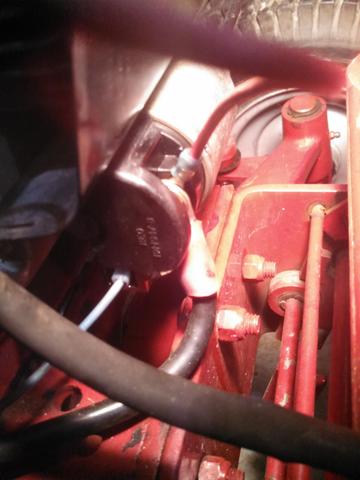

See that light blue wire on the starter photo?  Pull it off and you should get 12v between it and ground when you turn ign. switch to start.  If not, test the S terminal on the switch when turned to start.
To rule out the starter, jump from the + battery terminal (or the big wire on the srarter) to where you pulled out that light blue wire.  The starter should engage.

O.k so I tested the voltage between the starter blue wire connector and ground. I had zero voltage. I jumped a wire between + on battery and the blue wire connection on starter and it turned over.

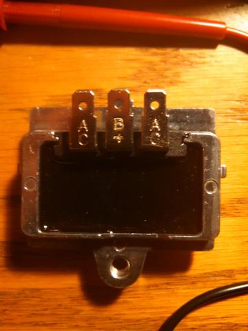

I cleaned up the safety switch. I will order one, It works for now. Next I placed the tester (In AC mode) on both B+ terminals of the regulator. The readings were -16.75 to -17.75 at 3/4 throttle. The voltage meter was reading normal for a while at 14.6. Then it started moving up to 17-18 volts and stayed there. Is the regulator shot?

You are probably making the AC reading incorrectly.
To measure AC stator voltage, multimeter should be set on the AC function and one lead placed on one AC terminal of the reg and the other meter lead placed on the second AC terminal of the reg. You appear to be using the 12v ground as reference ground forthe AC measurements.
  • Like 1

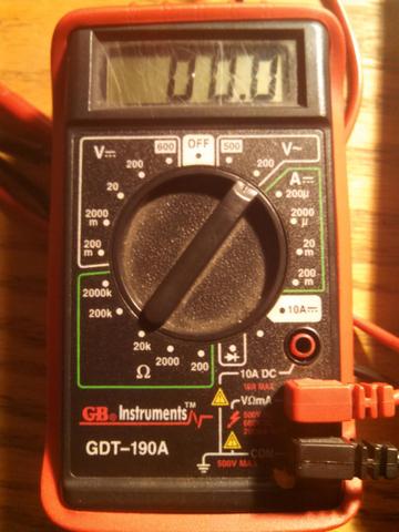

I'm placing the multimeter leads on each AC lead on the Voltage Regulator. The volt meter on the tractor is reading 17ish. This winter when I was clearing snow the battery went dead twice. I put a full charged battery in each time and the volt meter read correct at 14.6 for a long time. I read the multimeter manual some and I think I found the right setting for the multimeter. I tested it on a outlet and it read 120ac. Let me know if this setting is wrong.

The AC reading from the stator should be made with the selector switch pointing toward 200 V~
ironically, 180 degrees opposite of where it is in the image above.
You may also want to paint the scribe line on the selector switch to make it more obvious the function the selector is pointing toward.
With the selector in the V~ (AC) position. meter should show greater than 32 Volts AC at full engine throttle.

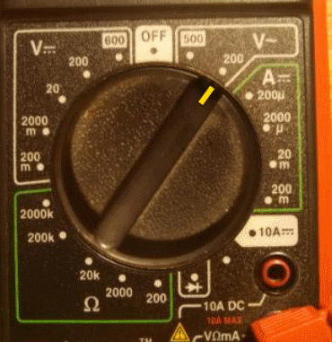

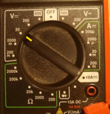

from your image
the position for volts AC and DC
