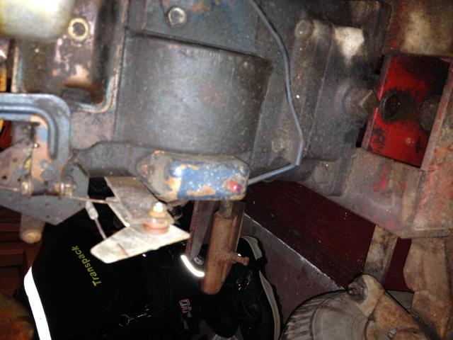

HorseHead1089 99 #1 Posted March 4, 2015 I havent got this motor to run yet. the carb bowl was stuck on and every thing looked like it was slathered in tar and muck. now i would like to inspect the ignition system. now there is a wire for the spark plug a wire to the key, and a wire going to this box and mysterious button. can someone provide some awnsers? Share this post Link to post Share on other sites
cleat 4,895 #2 Posted March 4, 2015 I would thin this box is covering the points. As for the button, maybe another shutoff ? Cleat Share this post Link to post Share on other sites

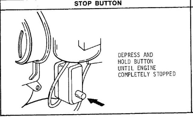

Live4outdoors 151 #3 Posted March 4, 2015 That mysterios box and button looks like your points cover for the ignition and the button is a kill switch that grounds out the ignition and shuts the motor off. If you haven't run motor in a long time or ever, will be worth fine sanding the points and possibly adjustment as well. Share this post Link to post Share on other sites
buckrancher 2,660 #4 Posted March 4, 2015 points cover kill button Share this post Link to post Share on other sites
Andrew58 1 #5 Posted March 4, 2015 It kills the engine. I have one on my K161 1 Share this post Link to post Share on other sites
tunahead72 2,329 #6 Posted March 4, 2015 HorseHead, Do you have an owner's manual and/or service manual for that engine? There's a world of information in those documents that will help you immensely. Take a look in the Manuals section here on RedSquare, there's probably manuals there. If not, get back to us, somebody should have a copy. I have a K161 on my old TroyBilt tiller, the manuals for that machine are just incredible, I could scan a few pages if you need them. Share this post Link to post Share on other sites

buckrancher 2,660 #8 Posted March 4, 2015 That is the self destruct button. When pressed it will give you a zap like you have never felt before, which make its owner locate the biggest sledge hammer, busting it into tiny peices. Kidding aside, tecumseh's can light you up! I was not a wear you could feel 12 volts as there is no coil voltage at the points only battery Brian Share this post Link to post Share on other sites
