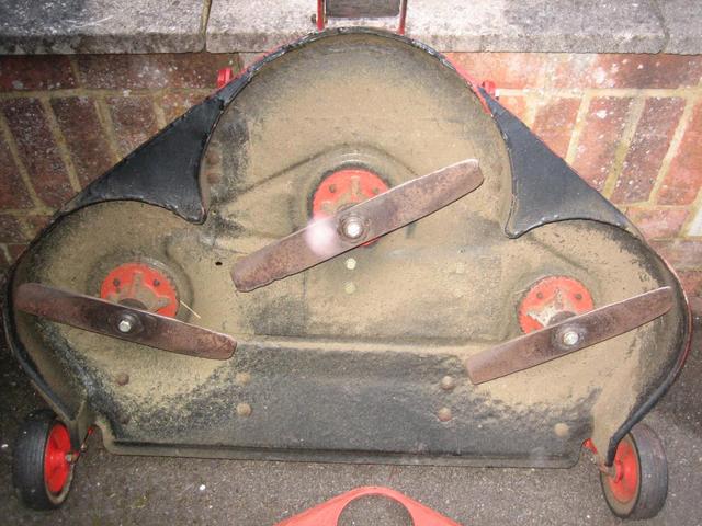

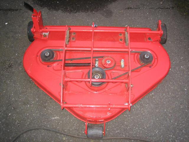

andrewLL 15 #1 Posted February 1, 2015 Hi, just hoping someone can help me with my cutter deck from a 1973 Raider 12. I have restored my rusty deck that was full of holes and it now works well but the belts are worn and near the end of their lives needing replacement. There was no identification plate on the deck so I don't know what part number / type it is to look up replacement parts. You can probably see from the picture that it is a 36" rear discharge deck, with two 12" blades and one 14" blade. The bearings are the one piece sealed bearing and shaft unit (part 103119), which I had to get shipped over from the States but was not as expensive as I expected. Is this enough to identify the deck? The belt on the deck is 1,910mm (75.25") long and 10mm wide tapering to 8mm on the inside. The main drive belt from engine around mule drive to the deck is 2,416mm (just over 95") long and 12mm wide tapering to 8mm on the inside. Both belts are worn and possibly stretched. Can anyone help with the Wheelhorse part numbers for these, and has anyone any experience with ordering standard industrial belts which are probably much less expensive. Thanks. 1 Share this post Link to post Share on other sites
TT-(Moderator) 1,127 #2 Posted February 1, 2015 Using 5-0622 as a model number, it looks like the part number for the blade belt is 8411. The deck drive belt for the 45" wheelbase tractors should be 102741. Here's the 102741:http://www.bearingboys.co.uk/?catid=3296&att1=Toro-A-102741&att2= This looks like a suitable replacement for # 8411: http://www.bearingboys.co.uk/A75_Kevlar_V_Belt__6877_-12581-p 2 Share this post Link to post Share on other sites
Anglo Traction 759 #3 Posted February 2, 2015 Good job on the Deck Andrew. Same as mine and can only endorse TT's info. I have the same part numbers still showing on my '74' 36 RD Original Wheel Horse Deck Belts. Your close to the quoted lengths as well- 102741 listed as 96.6 inches 8411 .. . 76.94 inches. Must get around to doing my deck soon Share this post Link to post Share on other sites
