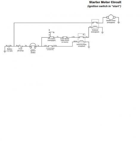

gwest_ca-(File Mod) 10,491 #30 Posted February 9, 2015 Use this diagram to test the starter circuit. You can see where the power goes to get from the battery to the starter. Make sure both battery cables are connected to the battery. Follow the power with a test light or voltmeter starting at the 25 amp fuse that powers the red wire to the ignition switch. There are two 25 amp fuses so make sure both are good. From now on remember the key must be in the START position when you make each test. The pto must be OFF When you get to the clutch switch the pedal must be down to close that switch. If you have power in the Lt Bu wire at the relay you can assume to pto switch and clutch switch are working properly. Re is red wire Ta is tan wire Lt Bu is light blue Dk Bu is dark blue Pu is purple If you do not have power at both oil level switch wires with the key in the START position check the oil level in the engine. That is a magnetic float switch in the base of the engine. If it needs to come out read the special instructions on how to get it out without causing damage to the switch. It is fragile. Oil level switch instructions Let us know what you find and we will continue. If you click on the diagram it will enlarge. Garry Share this post Link to post Share on other sites
Hendricksn 7 #31 Posted February 9, 2015 Well there's power going into the switch via the red wire. And the 25 amp fuse is doing its job. But with the switch in the off position there's positive power coming out of the 2 dark blue wires. There's no power going out. In any of the wires. And the 15 amp headlight fuse is also good. And there's still nothing going on when you turn the key Share this post Link to post Share on other sites

gwest_ca-(File Mod) 10,491 #49 Posted February 13, 2015 Let's leave the ignition for now and try to get the starter motor to engage. This drawing shows everything required to make that happen. Red wire feeds power the the ignition switch. Ignition switch in the START position feeds power to #1 - pto switch and #2 - oil level switch. . #1 - Pto switch is closed with the pto OFF. This sends power to the clutch pedal switch. Clutch pedal down the pedal switch closes and sends power to the switching relay's contacts. #2 - Oil level switch is closed if the oil level is OK. This feeds the magnetic coil in the switching relay which closes the relay contacts. (When this relay closes you should hear or feel it closing - a click or thump) When #1 and #2 are both satisfied the switching relay sends power to the small terminal on the starter solenoid. Starter solenoid closes and starter motor should turn. You may need help to do this unless you have an extra pair of arms and hands. It will be easier to start at the starter solenoid and work you way back to the ignition switch to see how far the power is getting. Pto must be off - thats easy Push clutch pedal down Turn key to start Check for power in the purple wire at the starter solenoid small terminal. None there- Remove the switching relay and wires so you can probe the terminals with them still connected to the relay. The light blue wire and dark blue wire should both have power in START. If they do have power the purple wire should have power provided the relay clicked. The relay coil requires a ground to work so it may have a black ground wire - make sure it is connected to the chassis to complete the circuit. The pointed arrow in the diagram is a ground. Remember to turn the key to START for each test. Let us know what you find to this point. The reason for checking it from the starter back towards the ignition switch is the clutch pedal switch is hard to get to as it is down below the panel your shifters come out of. It is activated by the idler pulley arm that tensions the belt. With a light you can look down below the shifter and see the switch. This switch seldom fails. If you click on the illustration it will get larger. Garry Share this post Link to post Share on other sites
Hendricksn 7 #50 Posted February 13, 2015 The orange wire at the solenoid has power with the key in the start position. I didn't check any of the others because there was power to the solenoid. So I need a new one? Share this post Link to post Share on other sites
