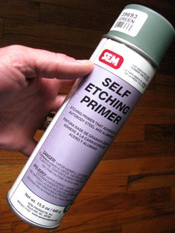

Save Old Iron 1,563 #3 Posted January 24, 2015 the best minimum preparation primer i have used is the duplicolor green self etch acid primer sold at advance auto. epoxy primers are used for long term protection enamel primers are probably the most commonly used (rustoleum) 2 Share this post Link to post Share on other sites

Ken B 3,116 #11 Posted January 25, 2015 I'm with you Chuck. When I'm restoring a vintage outboard Duplicolor is the only self etching primer I will use. I've tried them all and this is the best self etching primer in a spray can that is out there. 1 Share this post Link to post Share on other sites
fireman 1,021 #12 Posted January 25, 2015 Ken come to think of it, I do like the Duplicolor Self Etching Primer. Dries really fast. Harder to find then the Rust-Oleum. Share this post Link to post Share on other sites
Ken B 3,116 #13 Posted January 26, 2015 Advance Auto in New Milford usually has it.. Share this post Link to post Share on other sites

RedRanger 1,468 #17 Posted January 27, 2015 Also a fan of the self etching primers listed. Why are they always green though? Just wondering. Share this post Link to post Share on other sites
