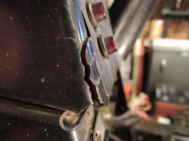

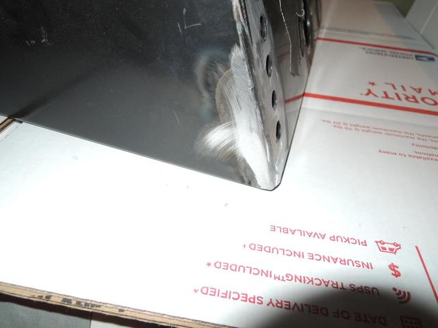

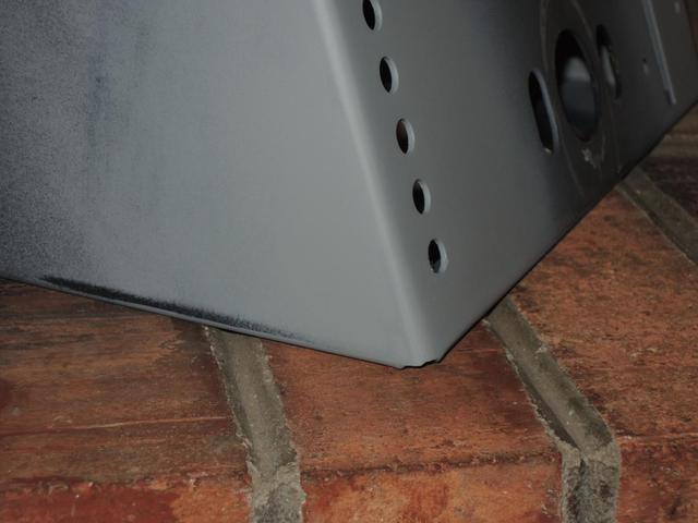

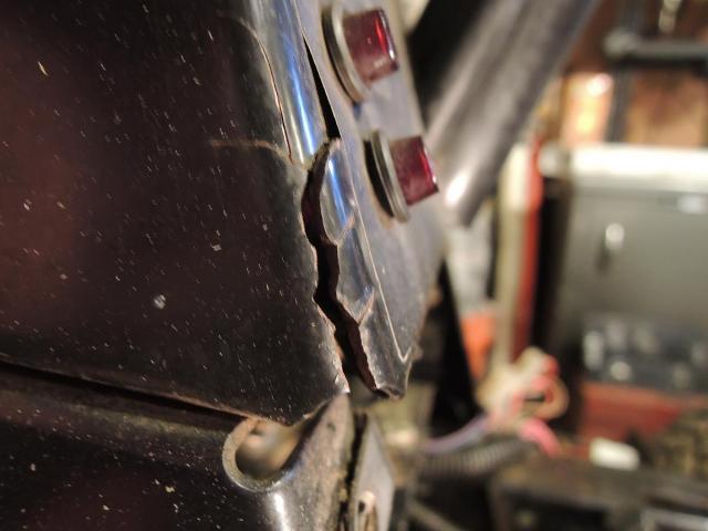

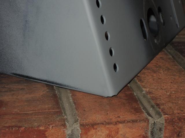

rmaynard 14,897 #54 Posted January 7, 2015 I got the sheet metal back from the welder. I had all the cracks TIG welded, and the weld goes all the way through the crack. Below is an example of the finished repair on the worst crack in the upper dash panel. My friend is a great welder (and Wheel Horse owner as well), and always does an excellent job. BEFORE AFTER WELD AND GRIND AFTER SAND AND PRIME More pictures will follow, but I am a little busy at the moment and can't devote as much time to the project as I'd like. 9 Share this post Link to post Share on other sites

rmaynard 14,897 #58 Posted January 8, 2015 ...Treat your welder friends well and they will take care of you! My guy is great. Never wants any money, but ends up taking a little for "material". If you can't weld yourself, it's nice to know a good welder. If you don't know plumbing or electrical, it's nice to have friends that do. If you don't know "horses", it's great when you find RedSquare. 5 Share this post Link to post Share on other sites
dclarke 4,011 #59 Posted January 8, 2015 Looks like a new one, Bob.... We have a tig, mig and stick welder at work and a guy that's pretty good with them. It is nice to have that available. 1 Share this post Link to post Share on other sites
rmaynard 14,897 #60 Posted January 8, 2015 Looks like a new one, Bob.... We have a tig, mig and stick welder at work and a guy that's pretty good with them. It is nice to have that available. My welder friend says that when he is working with things like this, he likes to weld from the back of the object so minimal damage is done to the face side. He says that the TIG welder will weld through the crack and leave a small bead on the face side that just needs to be ground down to smooth it out. That is what he did here. The majority of the weld is on the back side to offer a bit more support. 2 Share this post Link to post Share on other sites
Don1977 604 #61 Posted January 8, 2015 The best welder I ever saw worked for Southern Railroad before he retired. First to tell the reason the reason I was there. I had a 66 2+2 fastback Mustang 4 speed. A friend an I were going down the road, I look in the rear view mirror and another friend was coming up behind us wide open. Well I shifted in to third gear and floored it and busted the heater core dumping water and antifreeze in the passenger floor board. The old man ran a radiator and welding shop. When I got there he was welding up a fender on a 30 some model Chevy pickup. The fender has split and ran a crack 8" or so on the fender. He said he was just playing around the his welder settings. He had welded the fender from the top with the bead on the back side. The top was as slick as a baby's butt. That was 45 years ago and he was using a stick welder. I told him how I busted the heater core. When I picked it back up he said I don't think you'll bust it, I tested it with 35 pounds of pressure. Share this post Link to post Share on other sites
JimD 3,345 #62 Posted January 8, 2015 Bob that's a top notch welder buddy you have there. Nicely done repair, and it will probably be stronger than original now. Nice work! Share this post Link to post Share on other sites

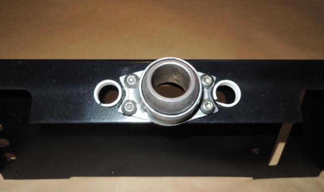

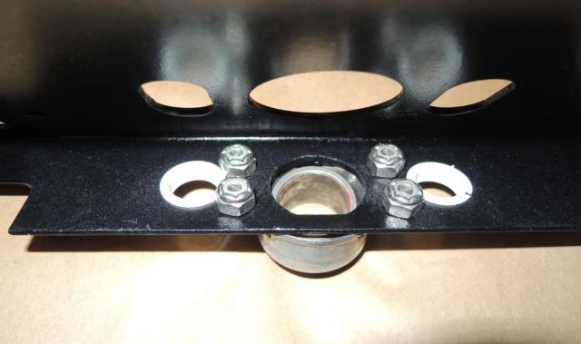

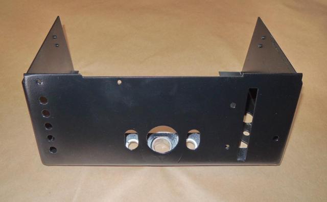

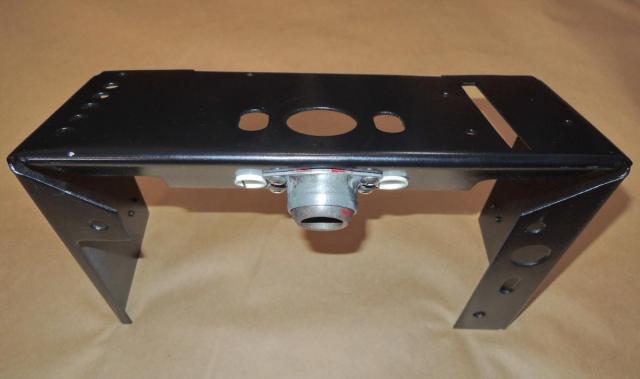

rmaynard 14,897 #63 Posted February 3, 2015 (edited) UPDATE - After having the console welded, I found that the hole for the steering shaft bushing was enlarged, allowing the bushing to move around, and causing unnecessary play in the steering. So I changed the entire setup by installing a modified flange bearing, part #6472, in place of the bronze bushing. Here are some pictures. This is the view from the operator position, looking down through the steering shaft hole and motion lever and hydro lift lever holes. You can see the new Nyliners (part #5983) sitting in place. View from the bottom Another from the bottom showing the stainless steel #10 Allen-head screws Stainless steel nylock nuts I am eliminating all of the 14 shims, o-ring, and cotter pin, and replacing them all with a locking collar. Edited February 3, 2015 by rmaynard Share this post Link to post Share on other sites
buckrancher 2,675 #64 Posted February 3, 2015 looks to be a good fix Bob Brian Share this post Link to post Share on other sites
Martin 2,130 #65 Posted February 3, 2015 (edited) That will make a nice strong result there, Bob. You came up with a good solution for the lack of room with the column levers. New nyliners where needed will also make a happy tractor........... and owner..... Edited February 3, 2015 by Martin Share this post Link to post Share on other sites
rick 215 #66 Posted February 4, 2015 I like that, Bob. I guess I can use the flange bushing unmodified, since my motion control lever is in the "floor" so to speak. I have a foot control that I plan to install soon, as well. Share this post Link to post Share on other sites
