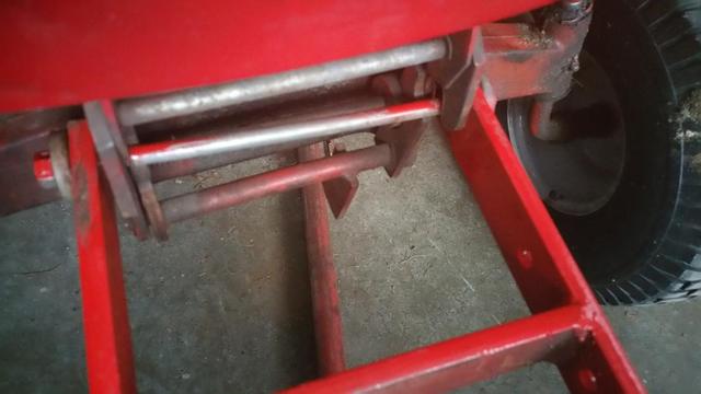

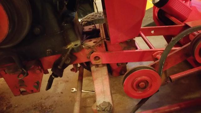

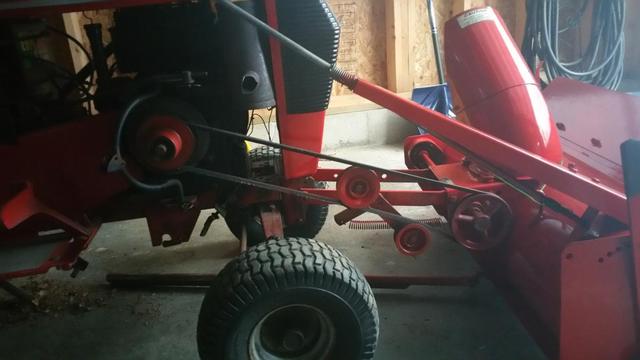

allensmall 4 #1 Posted November 27, 2014 This summer I bought an 86 310-8 and it came with a mower deck and a blower. The only information that I can see on the blower is model 6-6211. For some reason even after reading whats seemed like hundreds of posts on here I'm having a hard time figuring out how to correctly attach the blower. I've been working on trying to get it on the last 2 nights and have spend way too many hours trying to figure it out. After reading the posts on here I believe I have figured out the routing for the belt but it just seems like it is way too tight. After attaching the blower to the front of the tractor I had to have a second person lift the blower up in the air just to get enough slack in it to get it on the PTO. That didn't seem right to me but even after getting it on, the blower sits cocked and is no longer fully engaged on the front of the tractor. It seems to me like something if off with the belt but I just can't figure it out. The belt is a 70" belt and from what I've been able to piece together seems like it's the correct length but now I'm questioning if it's really the correct belt or not. I've got a couple pictures showing the belt routing and how it's cocked after I get the belt on. I'm hoping I'm just missing something obvious but at this point I really have no idea what to do. Any help would be greatly appreciated. Share this post Link to post Share on other sites
Martin 2,130 #2 Posted November 27, 2014 i think you have an issue with the belt. heres my belt routing on the one im setting up right now. wh 9750 belt, when you look at mine your belt looks short..... this is the best pic i have right now but you can click it to make it bigger.... aftermarket or wheelhorse belt? Share this post Link to post Share on other sites

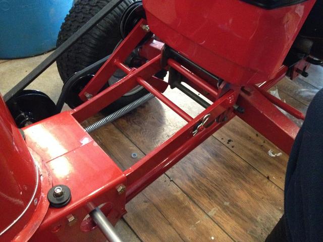

Martin 2,130 #3 Posted November 27, 2014 (edited) just looking at your pics and the one of mine, i think your attaching bracket is too long for that belt length. look where your rear idler is compared to mine. yours is forward of the hood, mine is back along side the hood. your attaching frame doesn't look right here. i don't have much experience with the model number blower you have and will go research it to see what its for, but the basic frame hasn't changed very much at all for the 'attach a matic' tractors. heres how mine looks. yours looks like somebody has modified it. note how you have a welded bar right where the pivot for the belt tensioner holes in the frame are. also your bar that goes in the attach a matic is a loose piece where the frames were welded..... Edited November 27, 2014 by Martin Share this post Link to post Share on other sites

PaulC 341 #6 Posted November 27, 2014 I picked up a newer style tall chute blower that had this attachment setup? I duplicated what I had on my other blower so it now looks like martins but it did come with a 69" belt. I think you could make that setup work though? It is a 5/8 bar for the front attachment point so either bush the ends or maybe replace the smaller rod you have with some 5/8 threaded rod and just nut both ends Then I think if you move the pulleys to the hole closer to the tractor you'll be able to get the belt setup right. The v groove pulley should hit the front axle when the belt is not on the tractor. And the belt should be pretty tight. I thought the belt on mine was to short at first also but then I measured it and it was 69". Stretched it and got it on and it works perfect. Good luck and keep us posted once you get it setup it should do a great job moving snow for u. Paul Share this post Link to post Share on other sites
Martin 2,130 #7 Posted November 27, 2014 just to add on the belt installation, I've found it easiest to do it in this order..... belt around drive pulley on blower, through guide and v idler. around pto cone. lastly pull belt up over the top of flat idler. 1 Share this post Link to post Share on other sites

allensmall 4 #9 Posted November 28, 2014 ericj, I looked a bit closer and I now see the holes in the frame that you are talking about. I moved the blower back a bit to use the holes but the flat bar that is welded between the arms appears to be in the way. In other words hit hits the front attachment point. I found the manual for the blower online and obviously that was before the tractor had that front attachment point and you can clearly see that it was designed to go through the frame to attach it to the tractor. I'm not quite sure what to do now. I was almost ready to cut that bar out or something. Thoughts? I really appreciate the help from everybody. I'm at my wits end with this thing. 1 Share this post Link to post Share on other sites
