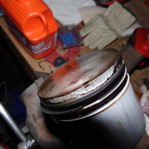

Molon_Labe 731 #6 Posted October 18, 2014 See what you have before ordering any parts. Here's what my K-241 standard piston, pulled from a 1976 B-100 engine looked like, but the bore showed less than .001 wear. Share this post Link to post Share on other sites
meadowfield 2,545 #7 Posted October 21, 2014 looking at the top of the piston it still has the bevel from manufacture and certainly hasn't the erosion you show. Once I've proved the 4WD, I'll pull the motor apart and take a proper look - I certainly won't be taking a gamble. With Import duty it's around $150 of parts, then oil, etc. A rebore is over $100 here - so it is easier to look for an engine with less hours on. Will let you know how it goes Share this post Link to post Share on other sites
