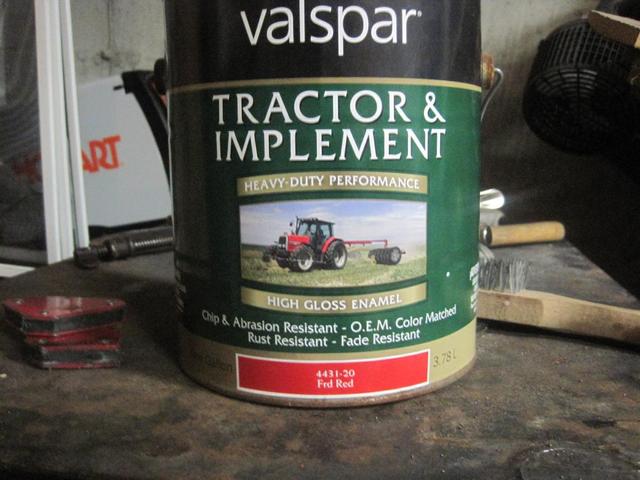

Nathanielperz 150 #1 Posted September 20, 2014 Hey guys the 1276 is almost ready for paint! I hope to get as much painting done as I can this weekend. My dad borrowed a paint sprayer from a guy at work and we have the paint but we don't know how much to thin it. It say 8fl oz per 1 gallon but my dad says it seems like to little. The thinner it says to use is VM&P Naphtha. Here are a few pics of the can.... Thanks in advance, Nate Share this post Link to post Share on other sites
KC9KAS 4,741 #2 Posted September 20, 2014 That is 2 ounces per quart of paint (1 oz/pint) , and I think that is pretty close. Some guys actually measure, and some just pour it in. I bet that will be pretty close. You using a hardener in the mix? Share this post Link to post Share on other sites
