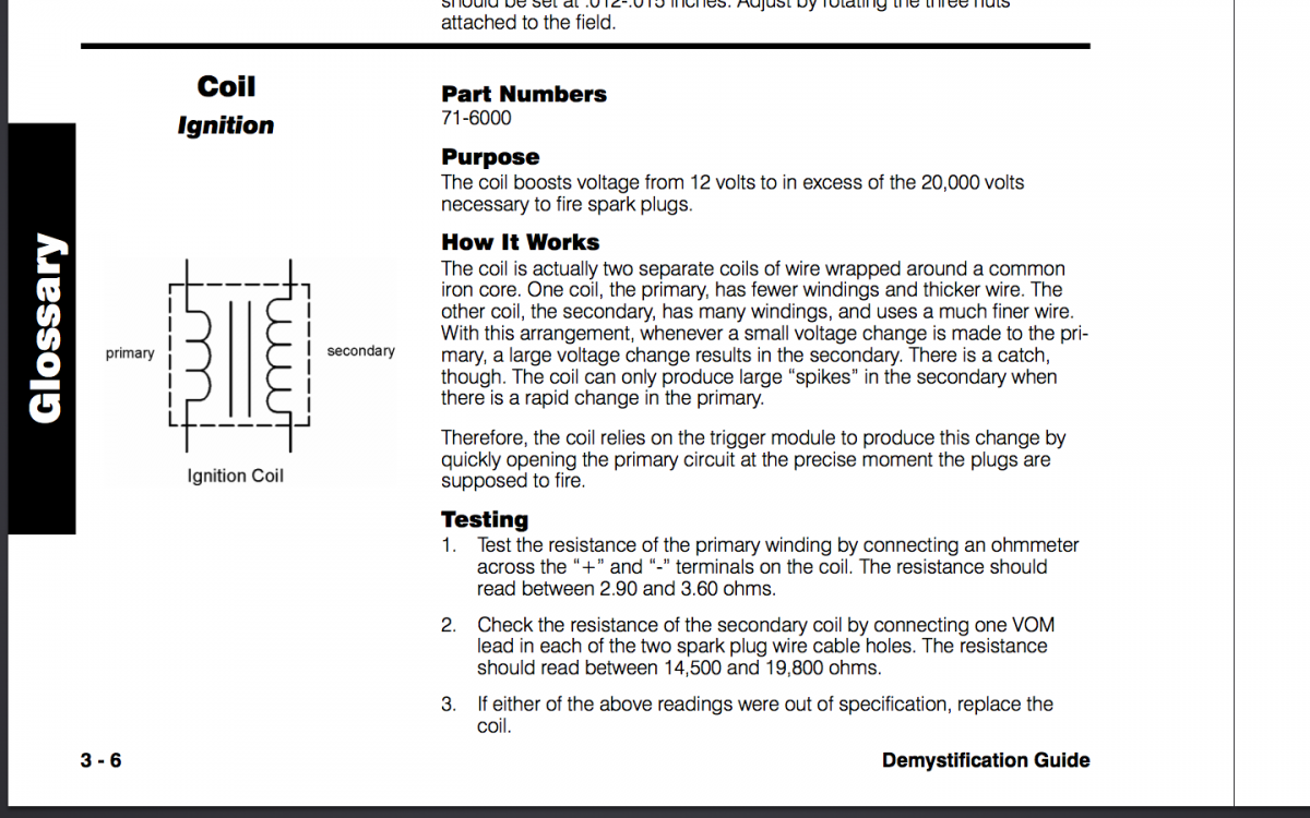

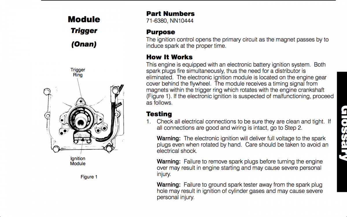

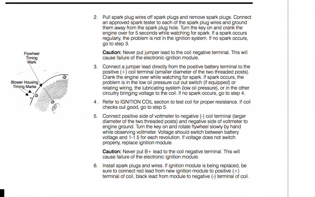

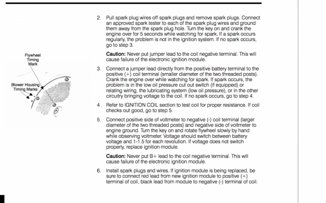

Martin 2,130 #7 Posted September 2, 2014 (edited) The board with the warning lights is just an info part, it does nothing to hinder the rest of the electrical... you can disconnect it altogether if you want, it has no bearing on whether the rest of the electrical on the tractor works. If you have no spark with 12 volts to the coil, it's most probably the coil or module. If you don't have access to a manual, I could post up here the sections for testing those two parts, but it might be a few hours before I can do it. Edited September 2, 2014 by Martin Share this post Link to post Share on other sites

Martin 2,130 #9 Posted September 2, 2014 heres the sections from the Toro Power Plus manual 492-4006. the demystification manual has some good info as well...... Share this post Link to post Share on other sites
