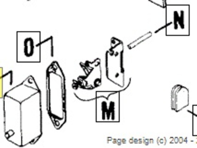

Nathanielperz 150 #19 Posted July 24, 2014 Ok I will... Before you take it apart try this. Take the points out completely with the push rod. clean them with a rag and put it all back in. Try gaping the points to .17 and try this. I have a raider 12 with a knock and so I did this and it had no knock anymore. Sounds brand new and its really easy and worth it before you tare into it. What is the push rod? What does it look like? Can I get some pics please... Thanks, Nate Share this post Link to post Share on other sites
rmaynard 14,804 #20 Posted July 24, 2014 The push rod is the little rod that comes out of the block to push the points open. Item N below: Share this post Link to post Share on other sites
