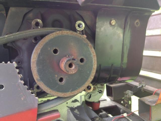

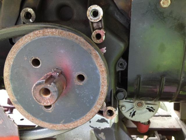

SolarStallion 37 #1 Posted July 10, 2014 HI, I have a C-120/C-160 that someone mounted a Briggs & Stratton twin 402417 0660 01 81080512 in it. I am looking for a PTO that will fit this. Not sure if it even has the original drive pully. The pully shaft has a key that extends past the pully so the pto sleeve does not go on. How does the pully remove if needed? I bought a GT Workhorse for parts. The pto on it has a 4 hole mounting to the pully. The pully on this tractor has 3 holes. Any advice? Thanks. Share this post Link to post Share on other sites
WH nut 553 #2 Posted July 10, 2014 (edited) You are going to have to strip it down to the bare crank and use the drive pulley and PTO off the GT. They are held in place with set screws. make sure they aren't doubled. You will need a puller to remove then. If you have room use a 3 jaw behind the pulley. If not, I have had good luck with a 2 jaw in the pulley groove. Also. make sure the crank size is the same. There is a 1in and a 1 1/8 Edited July 10, 2014 by WH nut Share this post Link to post Share on other sites
woodchuckfarmer 333 #3 Posted July 11, 2014 Clean the crank up good with emery paper it will come off a lot better. Share this post Link to post Share on other sites
