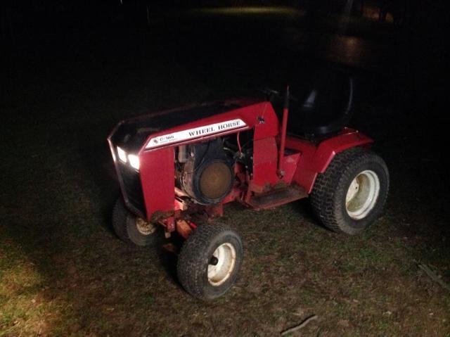

papaglide 541 #1 Posted April 22, 2014 I just got done driving the 417 and 416 around the yard. Parked them in the barn and was getting ready to close it up for the night. I was finishing my can of beer, looking at the black hood just sitting there. I said what the hell. Cranked her for about 15 seconds. Something sounded a little different. Cranked her again for about 15 seconds and Hot Damn! She started to run! I sat down and throttled up. The 16 horse shook at idle but at full throttle she smoothed right out and was quiet. I took up and down the driveway going thru all the gears : everything was good! I didn't do anything but clean out the tank, flush the lines, and put in a filter. I changed the spark plug, cleaned out the bowl and sprayed the crap out of the carb with cleaner. She sounds good with just a few small backfires at full throttle: I will adjust the carb tomorrow. 5 Share this post Link to post Share on other sites

papaglide 541 #4 Posted April 22, 2014 First time that she has been run in a few years. Let's see what she does later this afternoon. I will report back with any news. 1 Share this post Link to post Share on other sites

papaglide 541 #7 Posted April 25, 2014 (edited) The little backfires should have been a clue. Gas dripping out of the seam between the bowl and the carb led me to take the bowl off and see that the float was/is stuck in the up position. The engine was flooding itself. I took the carb off and dropped it off to get cleaned- you see, I have no idea how to do it! I am learning as I go and definitely kicking myself in the ass for not paying attention to all of the engine stuff that my older brother was doing when we were much younger! Oh well. The carb should be ready early next week. In the meantime, the tin will come off and a real good cleaning will take place. Unfortunately it's still to cool to paint the tin. Edited April 25, 2014 by papaglide Share this post Link to post Share on other sites
