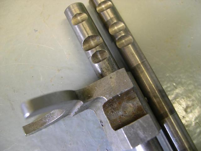

Racinbob 10,276 #51 Posted May 28, 2014 I already found the shifter fork. In fact two of them with the rails. I was talking to a mechanic biddy and he said he could probably build up the broken one and reshape it. It's not the entire end but it's almost like it was ground thinner about 1/3 of the way back from the tip but it looks more like it broke to me. I'm not a welder but I don't think I'd want to use this particular part repaired it that manner. Toro still has the forks. It looks like all the transmissions through 2007 used the same part #. But they want over $60 for one fork. I found the two with the rails for $24.99 shipped. They look good in the picture. Now it's more waiting time. Share this post Link to post Share on other sites
stevasaurus 22,229 #52 Posted May 28, 2014 Bob, you are having way too much fun. The forks are the same...do you have another fork? It sounds like you found the problem. Those small roll pins go back in esy...it is getting them out that is rough. Share this post Link to post Share on other sites
Racinbob 10,276 #53 Posted May 31, 2014 They actually came out quite easily Steve. It seems odd to me but the shift forks have several areas on the 'body' of them that look like a grinder hit them. I can't figure out what cause it. The replacements arrived today. They are supposed to be out of a 5053 transmission that was on a 1056. No grinding marks and they look good. Here's a shot of the replacement beside the rail I took out. Notice the center detent. It's clearly deeper. I also sent an email to a small engine shop called Landscape Supply that showed up on here before I logged in. Hopefully they will be able to help me out with the original K91 crankshaft. I need to get the journal turned down .010 without paying the price for a V8 crankshaft. Share this post Link to post Share on other sites
stevasaurus 22,229 #54 Posted May 31, 2014 (edited) The larger indentation on the one shaft is for when that shaft is in a neutral position. Difference in transmissions??? I'm sure you know this, but for the sake of this thread...when you are ready to pin the fork...you want to make sure the the grooved faces on the rail face each other and the forks line up over the input shaft. Bob, when you get this together...check out the 2 shafts again to see if they are level...maybe a shim is in order. A nice way to look at it...the pinion on the top of the one shaft and the reduction gear on top of the other shaft should line up dang near perfectly when everything is in the right place. Does that make since?? You do not want to pinch those shafts in the 3 piece tranny. I am curious also about...even though they have the same part numbers...one came out of a 3 piece tranny , and the other came out of the 2 sided kind. The 3 piece used ball bearings to maybe account for a little slop in the casting and side plates. The 2 piece casting tranny...I think...is much tighter tolerance and used needle bearings. If you do have an issue after you get it together...you may want to use the rails that came out of your trans and just change the fork...this may be why the grooves are a little different. You will have to put it together to find out...having fun yet Bob?? Talk when you want. Edited May 31, 2014 by stevasaurus Share this post Link to post Share on other sites

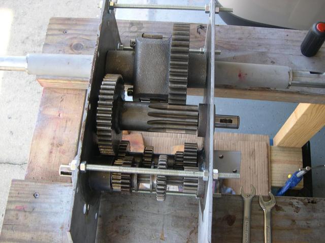

Racinbob 10,276 #64 Posted June 8, 2014 Not much time this weekend to play with this. I assembled the transmission with threaded rod like Steve did in his video. Prior to disassembling the thing to do this I measured between the side plates. 6 1/8" dead on. It was still binding when I snugged up the side plate bolts but freed up just by loosening them. One thought was that a bolt could be hitting something but nope, there's plenty of clearance. So I put it together like this. My first 'setting' was 6 1/16" between the plates, just a bit tighter than they would be on the case. I was thinking this would compensate in case there was any gasket compression when I torqued them down tight. The thing is spinning just fine. This should eliminate any possibility of something getting pinched when it's all assembled. I don't see any marks where it could be hitting the case. I'm thinking I should try again with the differential removed. If it spins fine then do it again with just the differential installed. I've already tried this once and it indicated the differential was the problem but my work always needs to be double checked . if I just slightly relieve the sideplate bolts just so it turns but still rubs just maybe it will leave a mark to give me divine guidance. I doubt that I'll have time to mess with it more today but I'd like to hear if anybody has any suggestions on what to look for. 3 Share this post Link to post Share on other sites
AMC RULES 36,945 #65 Posted June 8, 2014 Man, I do love that gearbox internals pict... could you install your pulley, a belt, and put it in motion for us to watch? Seems it would be almost as interesting as Steve's paint drying video. 2 Share this post Link to post Share on other sites
stevasaurus 22,229 #66 Posted June 8, 2014 (edited) Craig's right...that is a great picture. I do not see anything wrong...the differential carriage appears to have plenty of room to turn freely. If the cluster gear shaft and the spline shaft are turning freely...it almost has to be the bearing under the large part of the mushroom gear that is binding up on the bottom of the gear. I have had issues with that spot before. Was there a thin shim under that bearing when you tore the trans apart?? Could that bearing be a little cock-eyed in the seat ring?? Maybe try just the mushroom gear and the differential...or just the mushroom gear in your set up. Make sure that bearing is just flush with the seat ring on the outside edge. The center of the bearing is a smidge higher so the mushroom gear shaft sits inside, but the bottom of the gear rides on the bearing. Almost has to be where the problem is Bob. Nice job on the transmission...it looks terrific. Edited June 8, 2014 by stevasaurus 1 Share this post Link to post Share on other sites
Racinbob 10,276 #67 Posted June 8, 2014 That's the bearing where the welded ring on the case side was out of round. I 'fixed' it but that's not saying I got it right. Yes, it's got a shim under it and I ended up putting the shim back in after I made the oval round. I'll check it out again. Prior to putting it together with the rod I tried all the gears less the differential in the case and it was fine. Then I took all the gears out and tried the differential only and that's when it bound up again. Tomorrow I'll check out that bearing again and try all the combinations of parts installed in the case. Sooner or later the issue has got to expose itself...............doesn't it? . Ya know, a hundred years from now I'll be laughing about this problem. 1 Share this post Link to post Share on other sites
stevasaurus 22,229 #68 Posted June 8, 2014 (edited) Bob, I have had problems with that bearing pinching before...it was the first thing I thought of when we started talking about the pinching. Is it possible that the differential bull gear is making it tight when the side plates are tightened?? Check the bearing at the top of the mushroom gear also for the correct seating...almost has to be where you are having the problem. Maybe try it without the shim. Is it possible that the axle tubes are not square to the plates?? Take a good look at the welds. Edited June 8, 2014 by stevasaurus 1 Share this post Link to post Share on other sites
